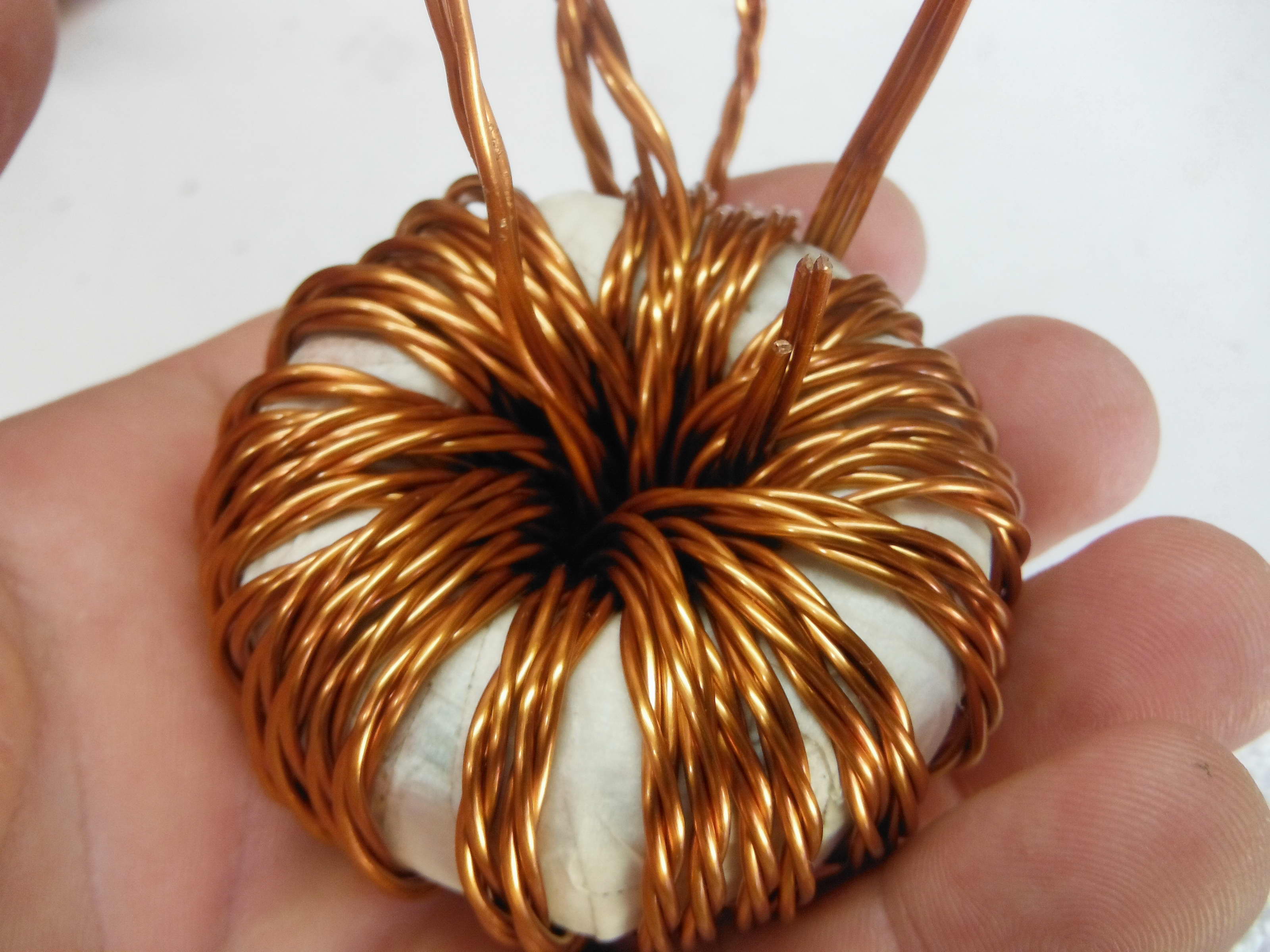

Hello guys today I just got a copper enameled
wire I chose 15 AWG gauge and if fits nicely here
are some images this is my second board that
I have parts on order for this second
channel,
so max wire diameter is 15 AWG :)
Regards
Juan
