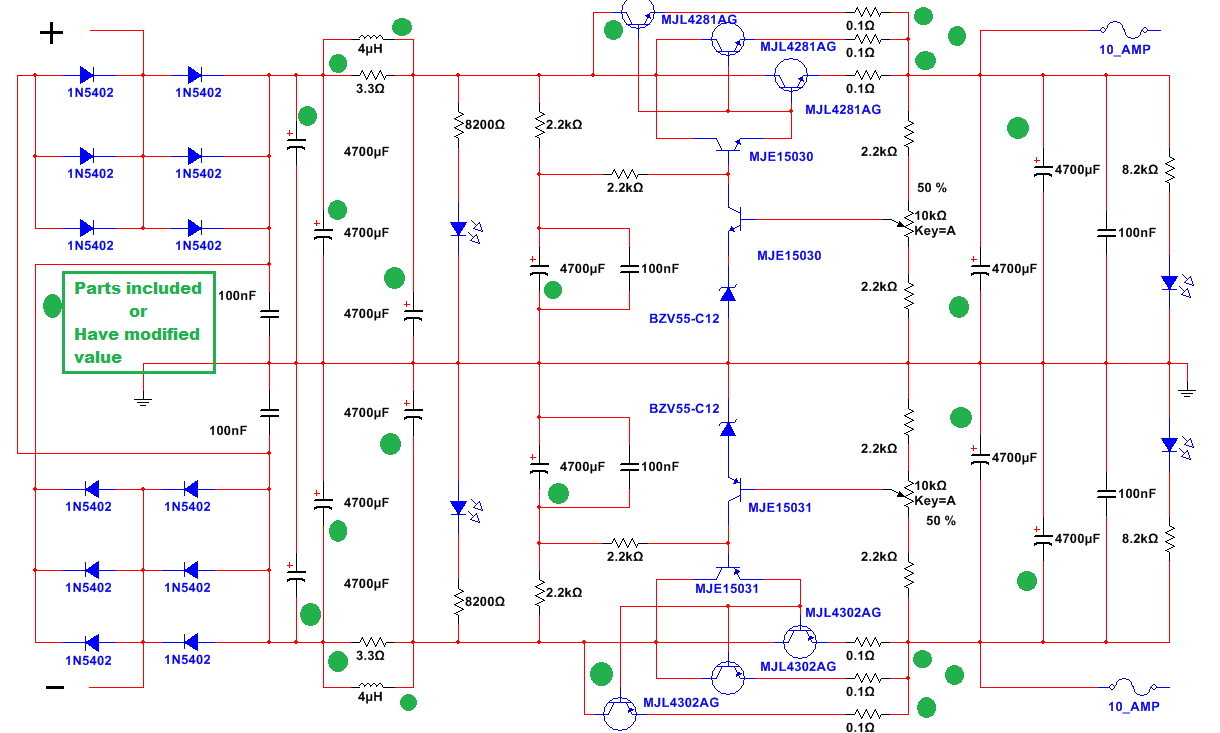

A small error remain in the pcboard layout... was not fixed by Juan
Zimmer informed the error remain there.
Please, do not assemble the last pcboard published in thread above till i post the fixed layout.

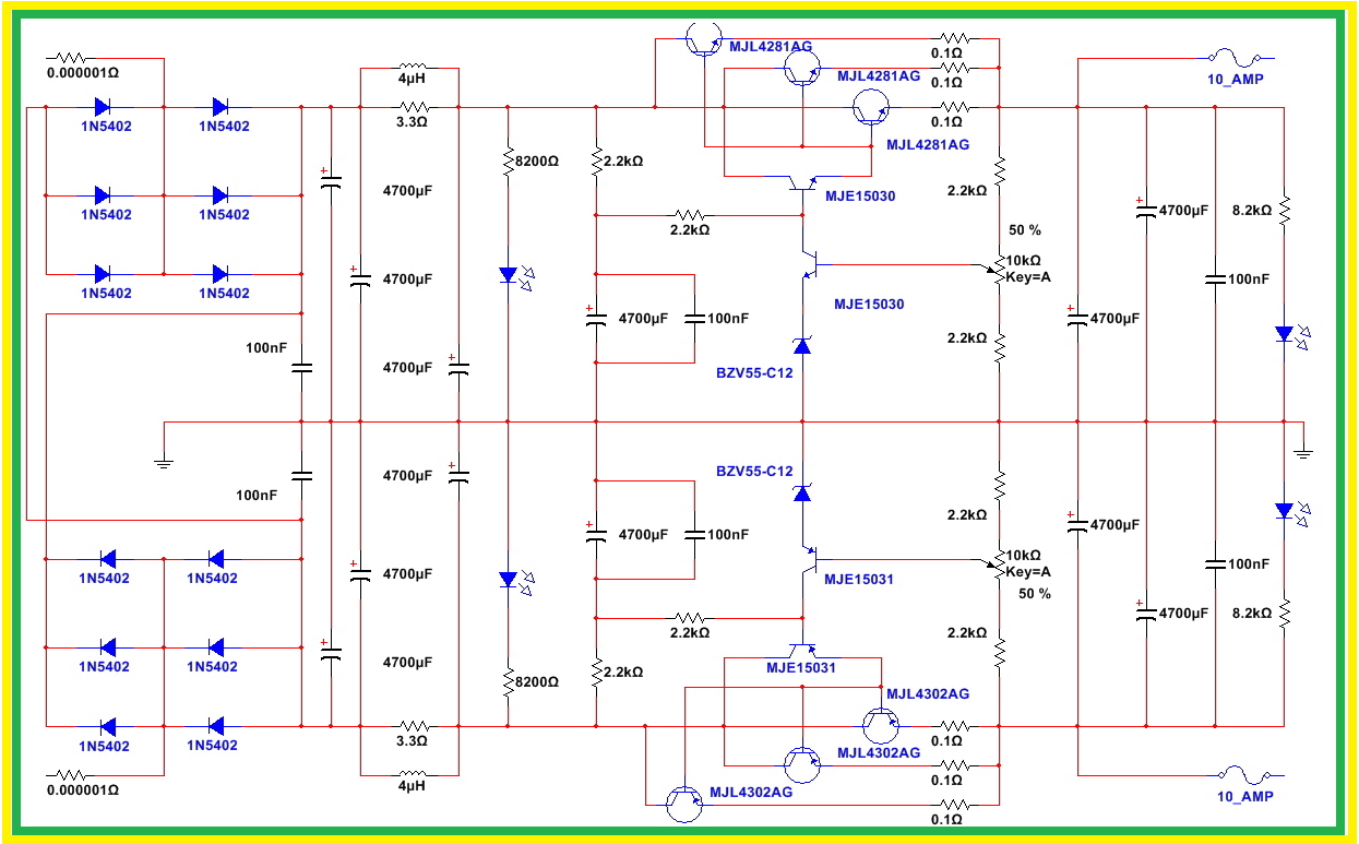

The schematic shows two output pair, in the reality we are using three, this is a matter to include on more only.
Soon we gonna have this fixed.
regards,
Carlos

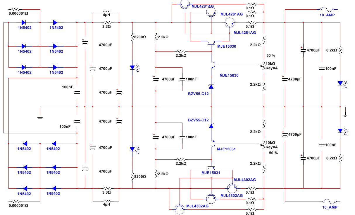

We are fixing the layout and also making an upgrade into the Dx Supply
It was made to be used together the Dx Super A.... good to feed two channels pumping full power... reason why i have changed something in the schematic..include more capacitors and one transistor more.
Resistor of 0.000001 is the resistance of the cable.... do not worry...it is nothing.
Coils are two layers, each layer may have 12 to 15 turns, wire is 0.5 to 1 milimeter diameter... total turns from 24 to 30 turns... resistor will be the core, as 3.3 ohms resistor, a 5 watts unit.

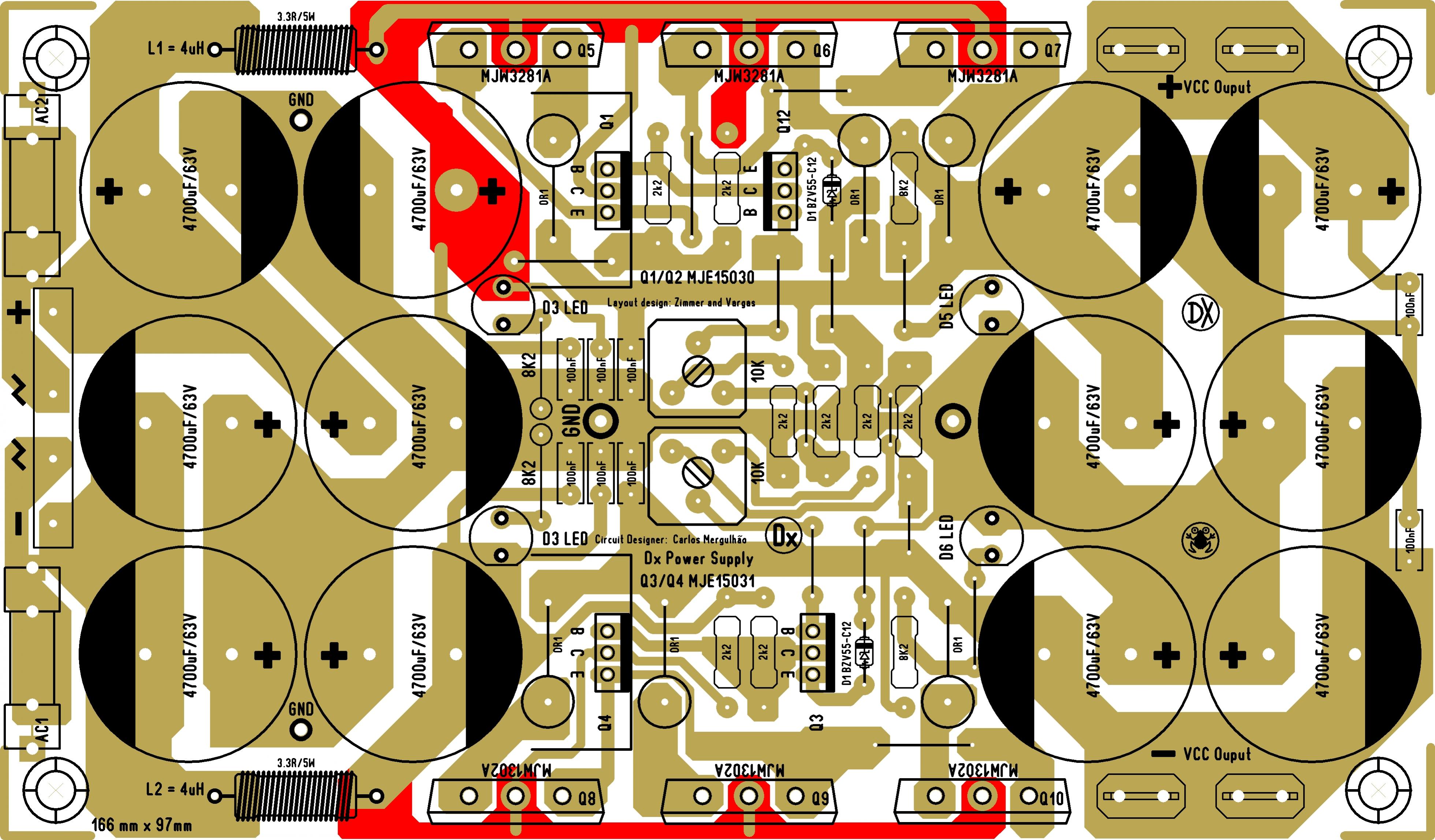

We are working into the Dx Supply layout..nobody sleeping here
Working hard...without stop.
Juan is increasing high current tracks width.

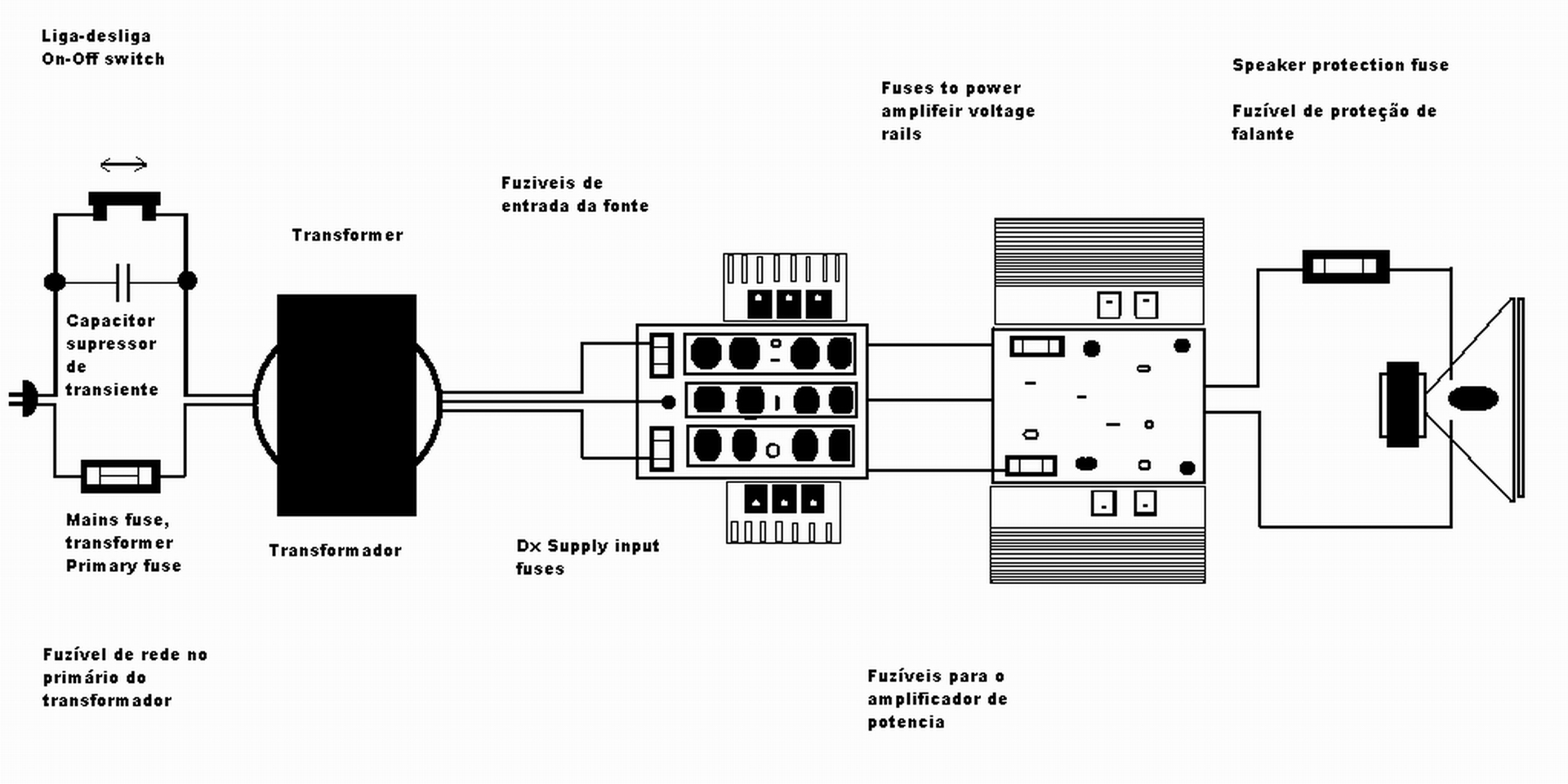

Here you have also an example of connections...observe fuses...each one of them must be calculated based into your parameters....if you are novice and wants some help.... a beginner...then come to uncle charlie and i gonna give you, gladly, a helping hand.

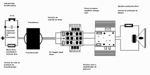

the switch must go in the same Live feed as the fuse.

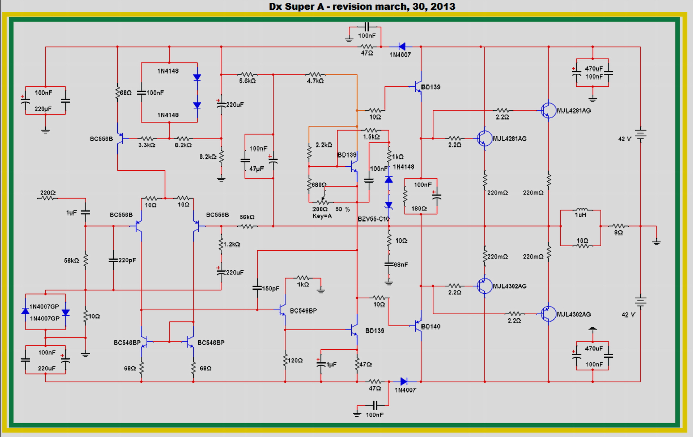

It is appointed to be used together the Dx Super A.... in a matter of fact, any series pass regulator will fit..the ones have error amplifier.
This one was hardly tested since they where published by Ampex in 1973...i have modified a little but it remains almost the same circuit.
Enjoy and be happy...here you have updated files about it.
Please, do not build before you have read all Dx Supply thread...if you need some help, then email me your parameters and i will give you some help about... Dx Supply thread is here

Juan made a mistake again
Because of that he will assemble the next fixed circuit at home in advance to publish images or send em to me.
I am sorry.
Do not assemble the last posted images because has serious errors.
regards,
Carlos

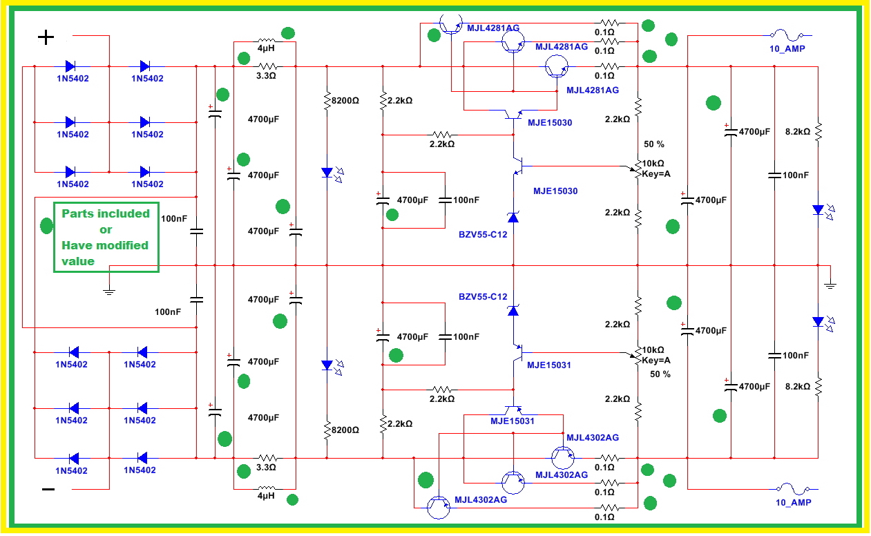

thank you for your information uncle charlie, but which one of the last posted image were mistake, i mean from what page / post.
No image is good...first because we made update... we have made a new
and better, and stronger supply.... all images posted after that...with the new supply, had mistakes.
So, you can trust in the last schematic posted (green and yellow frame surrounding it) but you should not trust in any layout published.
This forum does not allow us to delete posted images...better would be if we could delete the wrong ones..but i cannot..so..they are still there, posted and wrong.
Do not assemble based in ANY layout made to the Dx Supply.
One that i have made by hand you can trust..but that one is the first model that is too much weak and cannot face the drain of current of two channels operating full power at 2 ohms loads.
Answer is "no one!".... no layout is really fine.
Wait the Zimmer layout or Juan Vargas layout tested with photograph of prototype assembled and tested shown as certificate and guarantee of quality and reliability.

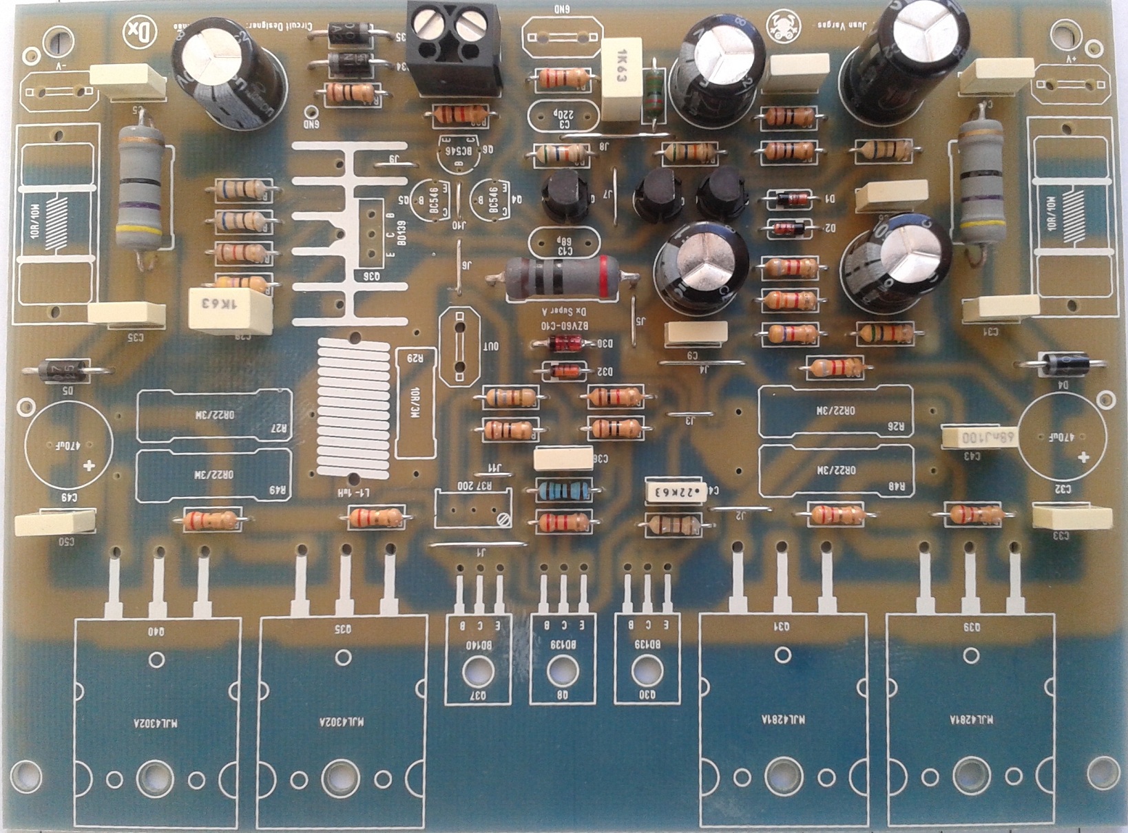

We are testing the Brazilian layout.
Here you can see.
It is the Dx Blame ST pcboard modified to receive the Super A circuit.
This layout was made by Zimmer..he said this is mainly to Brazilians..but if the devil pay he can ship to the hell.
For a while we have not ordered production...we are testing...soldering and dessoldering to see copper track resistance to solder and dissolder and testing watching the scope and some torture tests too.

Here is another photo.
I still have to buy the rest of the components to solder them, heatsink has to be cut from the middle too.
Zimmer, your PCB is looking nice, good work too.
Carlos, are friends planning to do regulator PCBs :rolleyes:
I also ordered some heatsinks for this PCB, fits exactly like the one Juan uses.

I have to wait for 3~4 weeks for these small heatsinks to arrive, so delay is not a big problem, what really matters is producing the same PCB quality for this regulator. Juan work was very good such that he correctly measured components leads diameters, it was a real bonus for me because once I inserted the component, I did not have to hold it back into PCB when I soldered its leads because drill sizes are very accurate.
