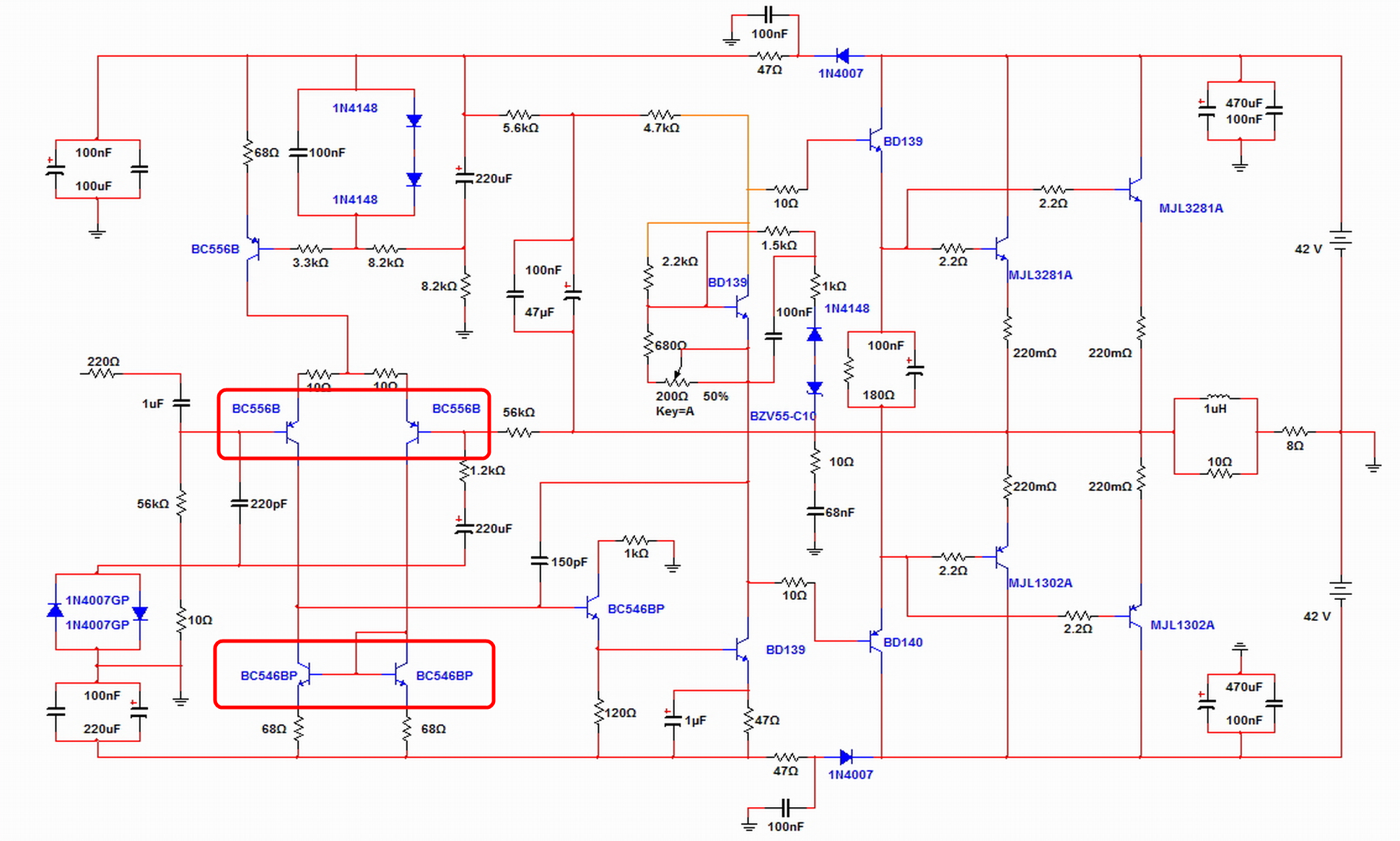

BJT matching and power supply
Hello Carlos!
Before concluding my SA DX I have a small question about the transistors of the input stage (see picture). Is it better to pair (matching) them or what is not necessary?
Then I think to use the power of DX (two mono blocks), it can go?
All 73's
Hello Carlos!
All 73's

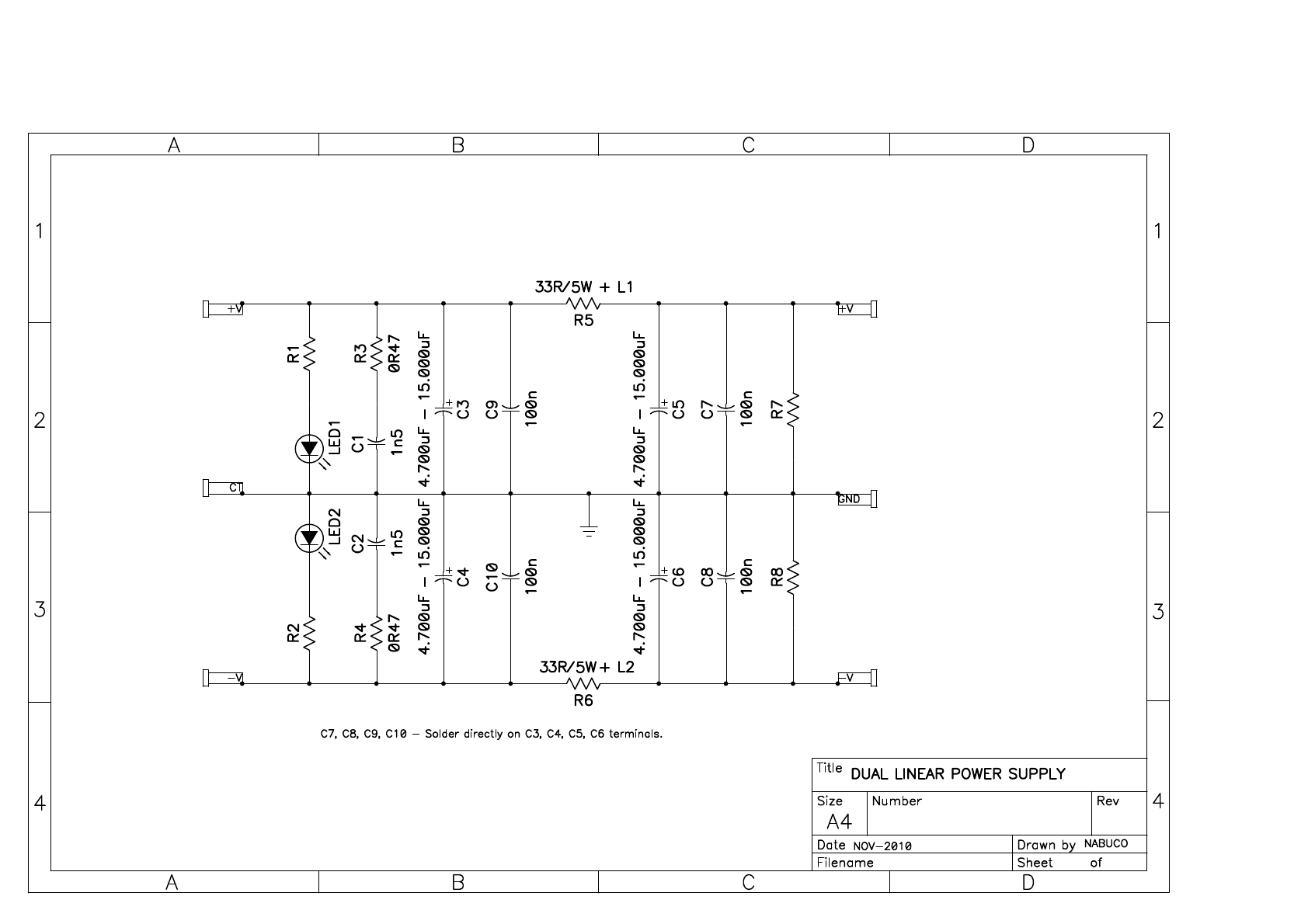

Yes. Dx Supply can be used
Match the upper ones only... if not matched you gonna have a little off set voltage (DC in the output).
It is normal to have from 1 to 25 milivolts off set there...so, do not worry and be happy.

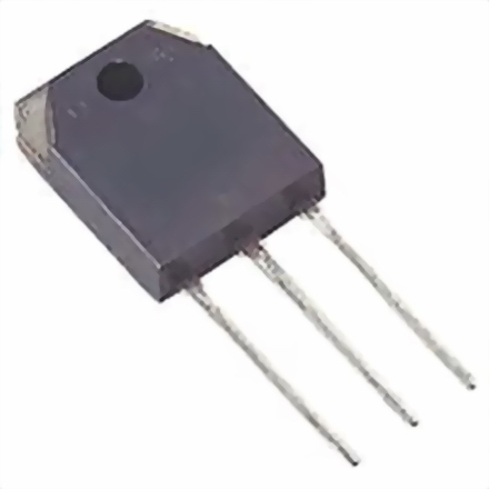

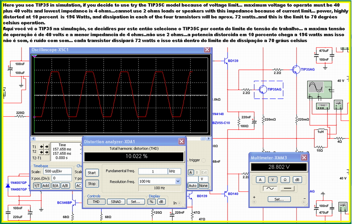

TIP35C sand TIP36C are very popular here
I do think these are the ones people will use here.
Amplifier was tested (already) using these transistors....but was not a destructive testing...was made within the limits studied.
Clipped waveform to 10 percent is the worst case scenario..and we must study the sittuation under this point of view.
Please, do not worry about the AG at the transistor end part number...these are the ones i have in my simulator, but the real transistor is TIP35C.

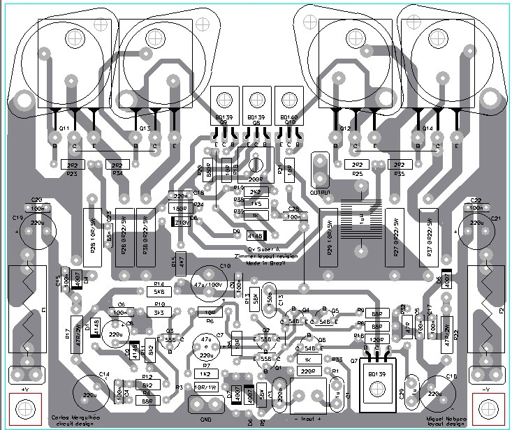

Zimmer tested his layout
This layout is to provide to Brazilians..but not forbidden to ship to outside Brasil.
Video in Portuguese.... a prototype pcboard etched at home to test the layout.

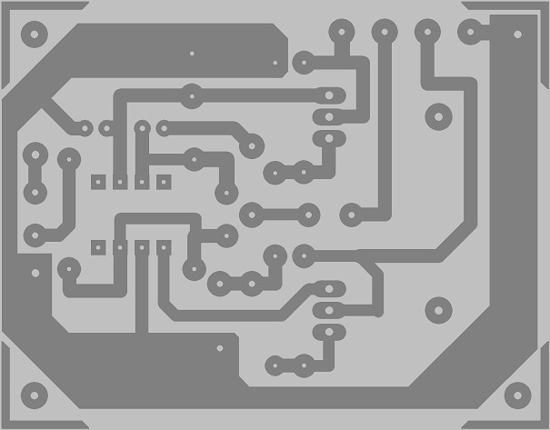

Now, as promissed, the Brazilian layout to the Dx Super A
This was made to provide to Brazilians...but, of course, you can have it ....also Zimmer will provide pcboards and kits of parts.
Search his adress in this same thread because was already published.
I do not accept orders...this is not my stuff..go to Zimmer.
Here you have all files together.... Dx Supply and Dx Super A:

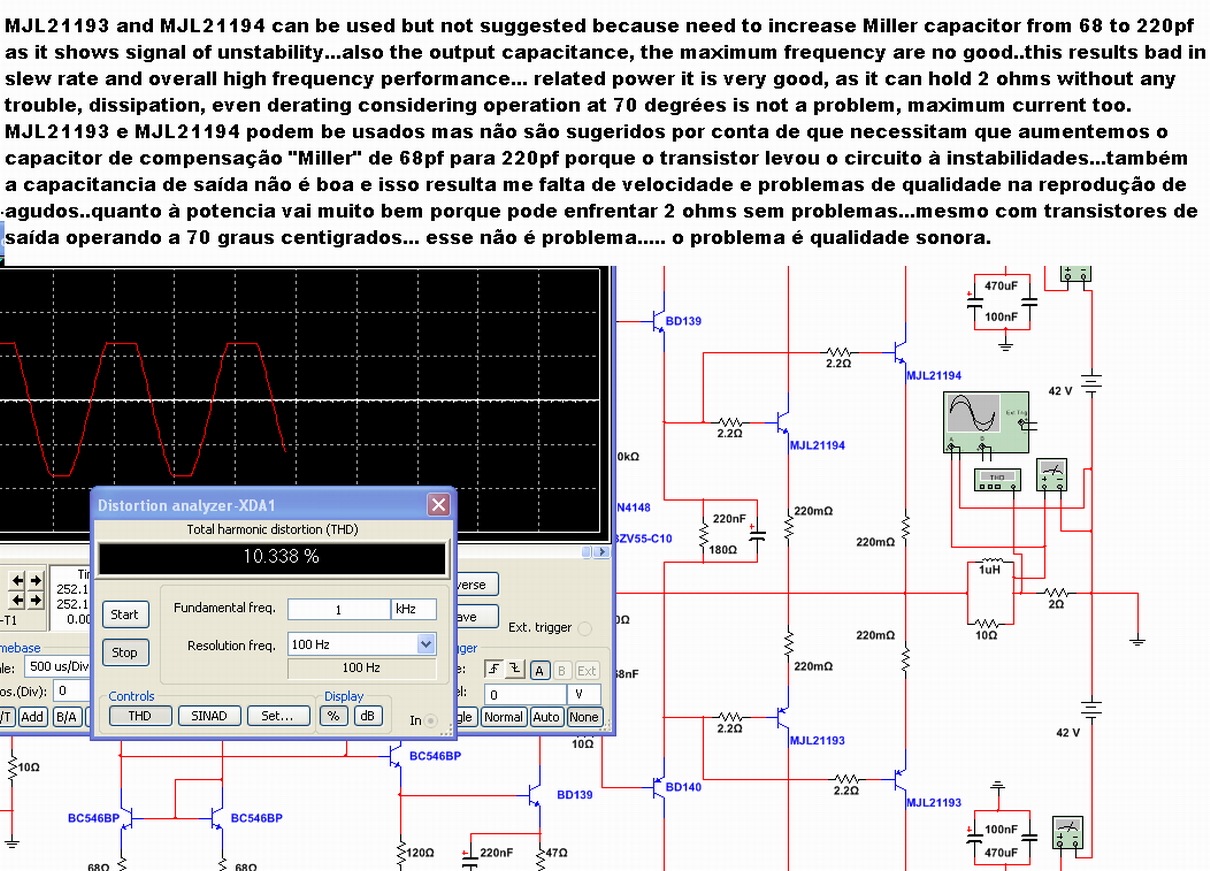

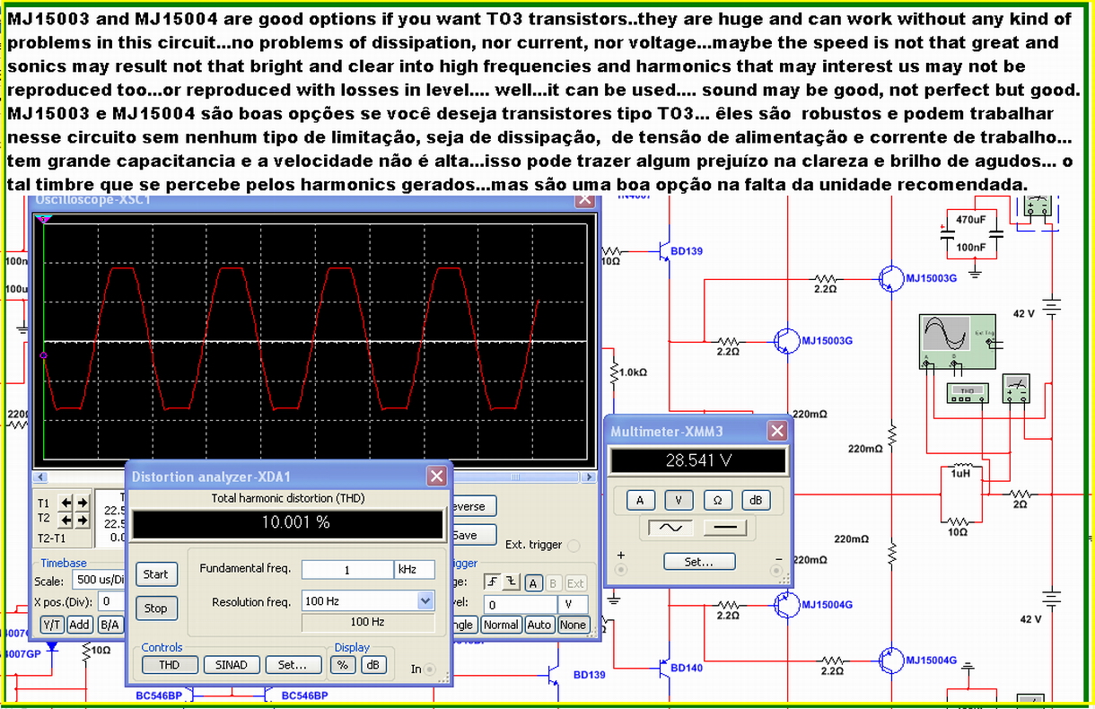

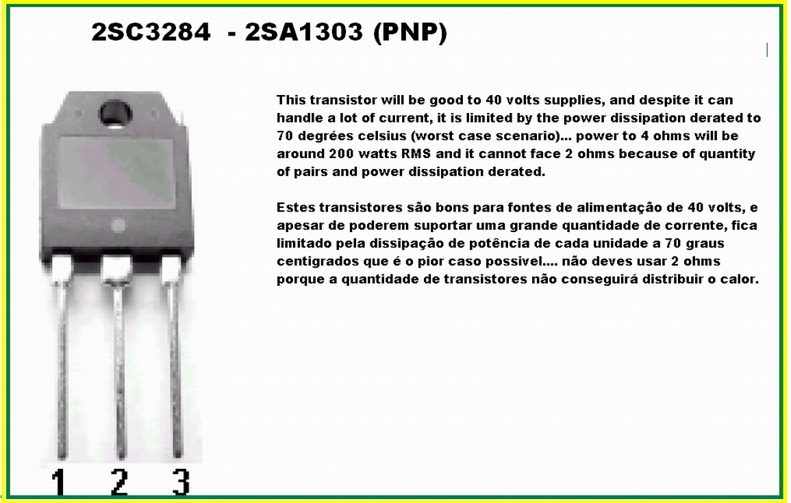

Output power transistor options.... the ones can be used
the reduction of the supply voltage needed...the derated wattage considering 70 degrées celsius (worst case scenario) and simulations was made at 10 percent of distortion.... SOA was considered.
So, images will show you safe use for these transistors, not only because you will not use them at 70 degrées celsius but also because i hope you will not listen at 10 percent distortion (worst case)

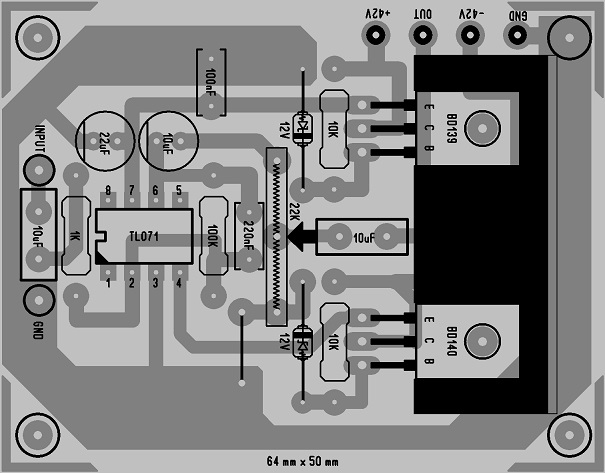

This is the traditional low pass filter you find in technicall books...this one was found in Ampletos (Video Rockola) and i have made modifications into the filters, sensitivity, slope and output level to match my amplifier.
Here you can see the original:
http://www.youtube.com/watch?v=fHLnb8hOJhA
This is not my design...well...this is in the internet offered in thousand sites...this belongs to mankind.

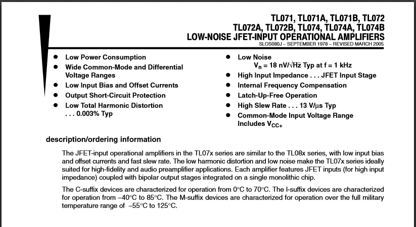

Thank you Carlos ! I have to try is not a really expensive project, the TL071 is really cheap, plus I have must of the components need it to put it together I made a few grid hot iron files so tomorrow I will get some print outs. Note: I'm going to test it out then I will described what can happen later .

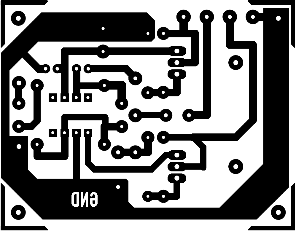

Yes that is true , hey Carlos I'm getting better at etching boards the problems is that the printed format is way to small still, I have to adjusted to no less than 120% or 130% maximum size, about the hydrogen peroxide works really good after is mix with the muriatic acid, but is tricky for me, iron time, time in the etching solution etc. Maybe someone that is reading this would like to share better tips, at least this one works great for me, I was trying to get the real etching solution but they do not ship to Puerto Rico I have check many websites "same story" so ( muriatic acid and hydrogen peroxide ) goody other than that is nice
that at least able to do it. the image is just and example. have fun guys like I do and Carlos too

Laminating machine is far better than iron for toner transfer
....I suggest to use laminating machine than iron, result is much better specially in the small tracks, using the machine with max heat, toner are well pressed and tracks are transfered balance upon pilling off the paper, well tested for me and the result works well and satisfied.
I got tired and irritated when i do the iron and they all end up to trash
But when i tested the laminating machine i stick on that method and have all my project rework.
As long as the copper is well cleaned, nothing to worries , i usually do 20-30 times back and forth on the laminating machine to insure will not miss the smaller tracks other wise will waste the time and repeat the process again, anyway good luck bro.... And Enjoy...
