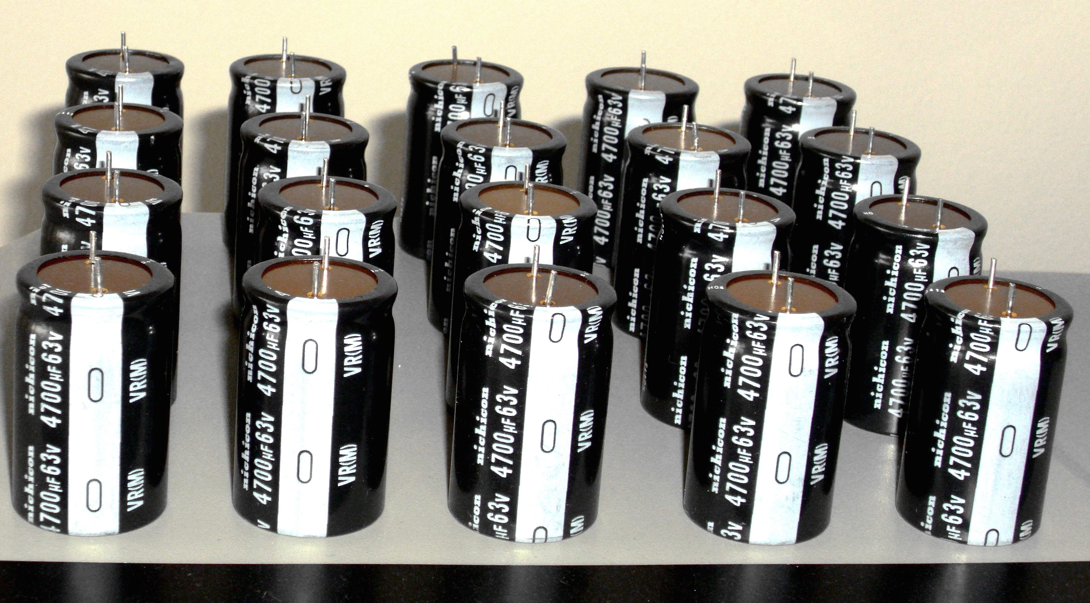

Hello Carlos!
Today i am more happy than usual.... when arriving home from my job, the janitor told me something arrived from USA.
Gift from Evette (Joseph Siejack) from Canadá and Dudainc.
Dudainc have bougth a lot of capacitors..then Evette ordered some and Duda shipped them to me.
Was a surprise... delayed 29 days and i was not waiting for this package anymore...i though the airplane crashed into the Pacific
Thank you very much folks...i am needing them now!
regards,
Carlos

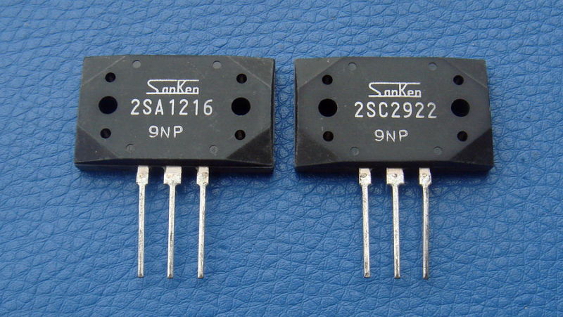

Because of that they want to know if they can use the most available transistor we have down here.... what they have to do to use MJ15025 for instance...or to use TIP36, or 2N3055, TIP3055, MJE3055, 2SC3281A, 2SC5200, MJL4281A, FLJ4215, MJL23194 and so on.
I am making some studies, at least with the units i have tested, to know what is the maximum voltage they can operate in the safe area..also the impedance.
The idea is to say:
If you want to use TIP36 and complementary, then adjust your supply voltage to 36 volts and it is better to use 8 ohms loads.... 4 ohms may be dangerous if you distort to 10 percent and 2 ohms is forbidden.
Hard work to me..but they gonna feel better having options.... they also will have the kit of parts to populate the audio amplifier pcboard and the Dx Supply parts too....maybe not all them..but the small ones, resistors and capacitors may be included.... we are not sure if we will put power transistors (their choice) and capacitors (also their choice to buy chinese units or not to buy Chinese capacitors, called here "ching ling"
I will make a video about that...maybe two..one in Portuguese and other in English studying, at least, 12 different transistors.

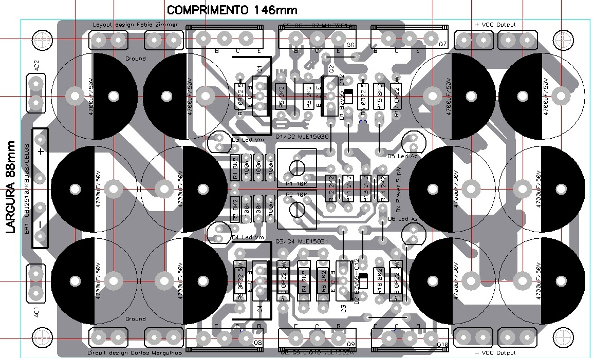

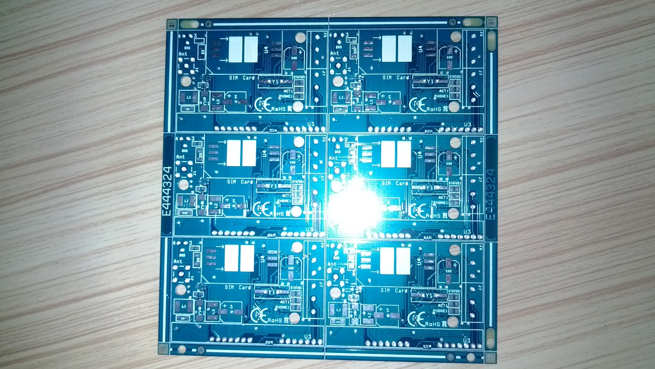

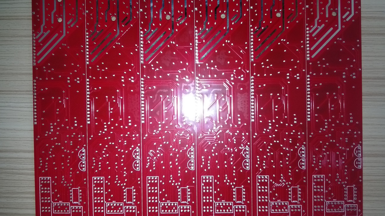

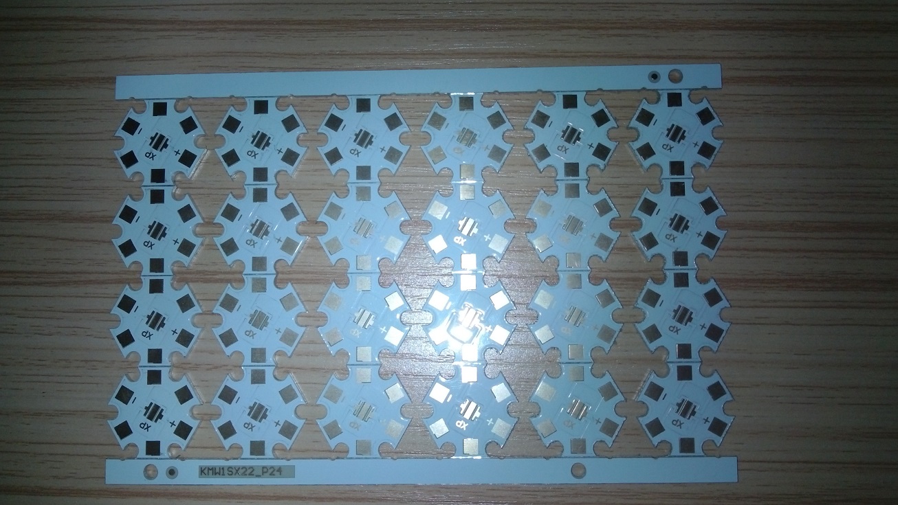

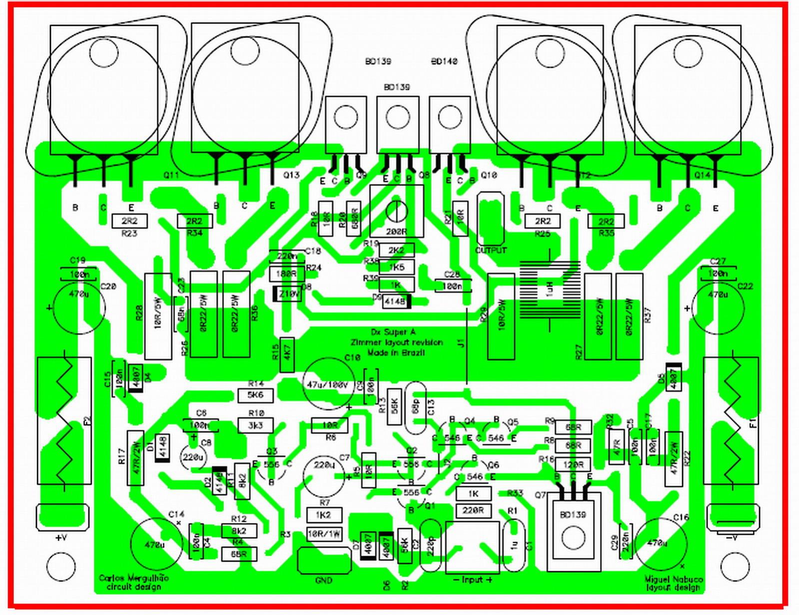

Hello guys!
Here are the board samples pictures from dear Vivian's the PCB factories.
What color would you rather have into the Dx Super A boards red,white,blue, or
green? I know Carlos hate the green jejejejejejeje :D
One more thing, she actually does not know much English so is hard to explain her that I want the board with the same color on both sides and she keep saying the same thing over and over damn!, chingiling is in my way :D
I already check other factories but the only one that is cheap and work faster is this company, China PCB Manufacturer, Quick Turn PCB Prototyping, PCB Board Manufacturing, Prototype PCB Production China PCB,pcb maker,pcb prototyping,pcb protoypes,quick turn pcb,express pcb,pcb Manufacturer .
Regards
Juan

Yes junior I'm thinking to get me another batch order, and I want to try other color option I'm thinking maybe red for now, as Carlos keep me update it with some minor changes, this order will have all the updates made already. So this
will be in the future, I will announce when I think I'm ready, this is more like "personal buy" but if some one is interested to get a pair please let me know.
When I say red maybe can or not be red because, Vivian can not understand much English I ask her a couple of time and she replay "yes,yes we can make it red both sides...", I say, "that is what you told me last time", :D jejejejeje but please do not alarm this order will be in the future do not panic is a not a "now" maybe in a few weeks.

I would be happy with white pcboards..because i already have
amplifiers from Dx line coloured red, green and blue....so...white is the one was missed...or maybe black with white silk screen..... the problem with black is that shows dirt because contrast.... dust usualy is lighter than black and by contrast we can see it clearly.
I am already happy because in Brazil i gonna have white pcboards...so...you can make your choice.
I would like Juan to produce Dx Supply pcboard too.

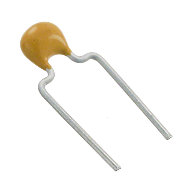

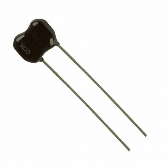

Hello guys!
I was thinking today about the 150pF caps, I always buy "mica" caps and I want to know if that make a difference if instead of mica ceramic is used will that make any difference ? I'm just curious. :confused:
Regards
Juan
People say that Silver Mica is more stable than ceramic
when facing signal that variates a lot in amplitude and frequency.... they say the capacitance stand still in the value even under extreme conditions of operation.
I am not sure....but just in case, in critical areas i do select Silver Mica.
There are extreme sittuations, for instance the output stage, power stage, Radio Frequency output stage of a Radio Frequency transmitter... a supressed carrier transceiver(SSB)..there, the signal goes from 0 to 70 volts in microseconds because of a carrier... there we have to use Silver Mica to tune the input and output circuit.
I have some suspections that may be an overkill.... excessive care...but, if cannot be bad... why not to use?
I do love ceramics dieletric...the most used....more traditional, proved along hundred years.... to my builders i say to use Silver Mica...to my own amplifier i use ceramics sometimes....depending if Silver Mica is available or not.... really, i cannot perceive any difference...maybe the scope can...but scope does not build my amplifiers..so, i do not care about what scope thinks about.

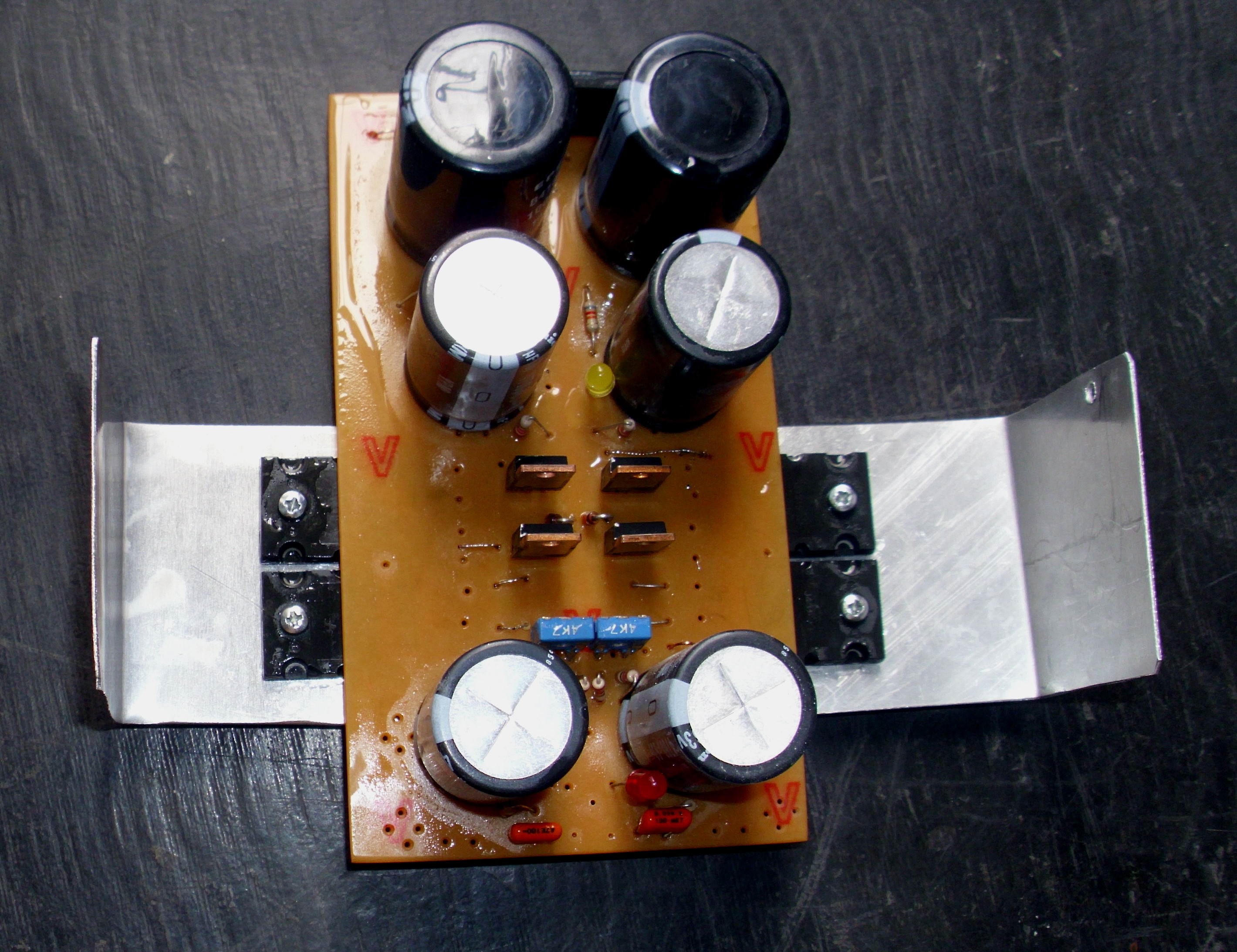

One more working fine..... not ready, i will replace heatsinks
by bigger ones.... photo shows the old supply assembled (some parts are below the pcboard)
This one is old model, we are making better one to face two channels operating full power at 2 ohms
Layout Picture shows new Dx Supply....made to go together the Dx Super A, reason why i use to comment here...but we have the Dx Supply thread too....here it is:
http://www.diyaudio.com/forums/powe...utput-adjustable-stabilized-power-supply.html
