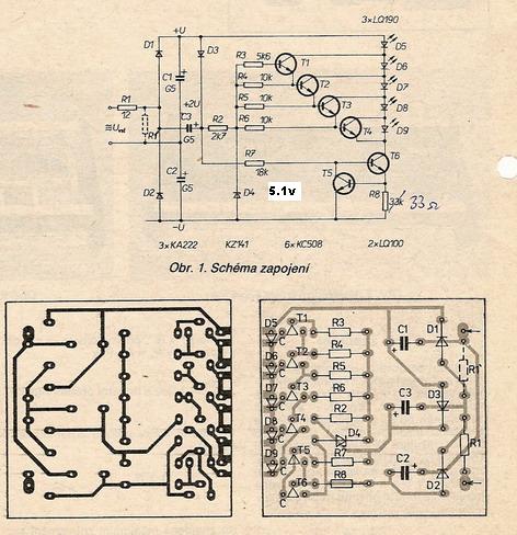

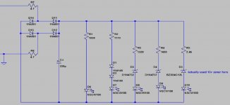

You know workhorse, you are one of the best engineers we have
your designs are really great and superior to the most high level designs i use to see..... i would like to have this meter with a different behavior...if you know, please offer us a design or some circuit clue to me to develop.
Something that.... when reaching the threshold, let's say 10 watts RMS, then a burst of ligth and after that the led goes off .... this way only small burst of ligth when reaching the threshold... half second pulse of ligth and then going off...this may produce a nice effect.
You know...not ligth and hold...but ligth and release.... can use other circuits.... maybe a flip flop...astable or bi stable multivibrator.l

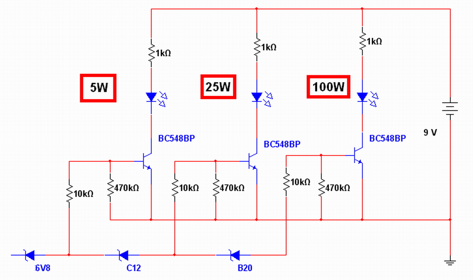

Configure a lm393 comparator for giving you Lo output every time the voltage swing rises above for 10wrms in to given load, lets say 6.3Vrms into 4 ohms makes 10wrms, this will do and the output of comparator goes to trigger pin of 555 timer into astable MV mode and connect the output to LED.

I think that Carlos wanted to build a circuit powered directly from the amplifier output, which is more practical.
If it was to make a circuit with external supply, I would use the LM3915 or LM33916 - you can set for dot mode (the Led will light and release) or bar mode (led will ligt and hold).

Oh yes!.... Mitchel got the point..but i asked to workhorse
Something more sophisticated...then he came with the chip.
We have already several chip options...i want that discrete... and not powered...in a such way we can use portable and measure everywhere, also to install inside a speaker without batteries or power supplies.
Using supply...well.... better to use a dedicated chip...and this is what i am trying to avoid and Mitchel got it....without supply is the main idea.
Ostry circuit is nice too..i have adapted and seems worked fine......i may try it not using a supply to see what happens.... this battery is the problem.... we can do these things without battery sockets or power cord, without transformer and all stuff.

Roly3055.... looks good this one..thank you very much
Nosotros, brasileños gustamos mucho de los cubanos....we.... Brazilians..we much appreciate Cuban culture.

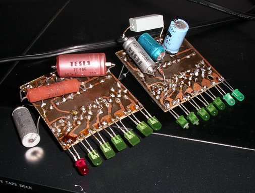

Long time passed when i had these Tesla capacitors in my home... from the sixties...lovely ones ...was good to watch them.
I will simulate...i really like the style...all transistors...simple circuit...the way i like...but seems to make Q5 operate we should use Germanium transistors...as 33 ohms will not develop voltage to switch Q5 on....nice.... really nice.

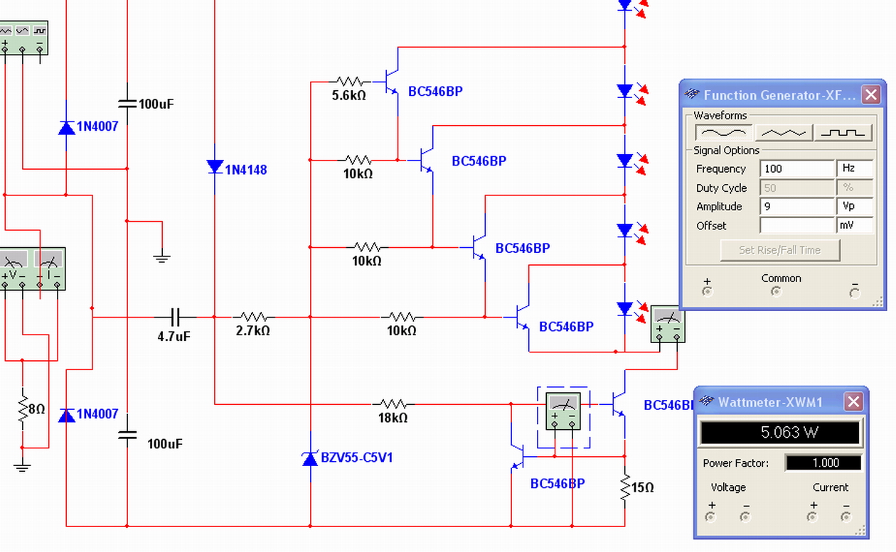

50w Power/volt meter
Here is my 50w version of Carlos's original design. Enjoy

Just made to this design. A copy of yours but for 50w power. At 1w power the 1st led lights up. Only ever so slightly. Will mount it in a box to show people what small power level is needed to make a large volume of noise/music.
