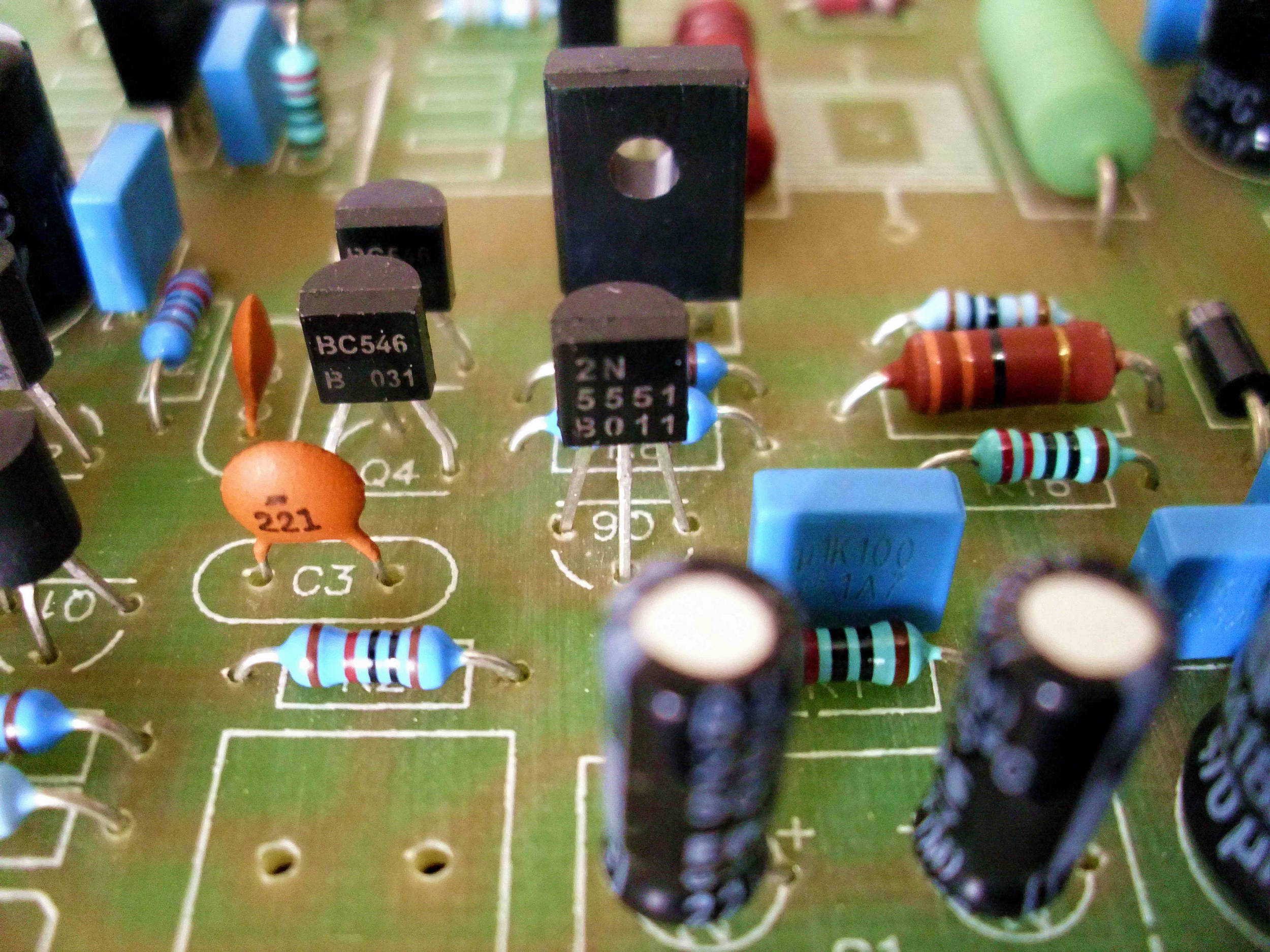

If you push your Dx Blame ES or Dx Blame ST above it's limits
entering clipping..then you may experience Q6 burning... then substitute it by 2N5551 because this one is stronger...accept more voltage from colector to emitter and more current than the BC546.
Happened in Brasil, some guys here drive the amplifier very hard... two had BC546 burned.... one use generic counterfeit BC546.... the other used square wave generator, high frequency and high level.
We had one friend from Germany that had troubles too.
Another way is to increase emitter resistance value..from 220 ohms to 1K...but really sonics changes a lot..better to replace it by a stronger transistor and be more kind with the volume knob.
Supercharged blue boards already use 2N5551 to Q6 position...so.... this one is already replaced...but also you can use stronger transistor there if you want....just avoid to replace the 220 ohms resistance.
1K there is an excelent electrical and technicall advice (Doctor Self uses this value there)...but sonically i have found 220 ohms better...also simulating was better.

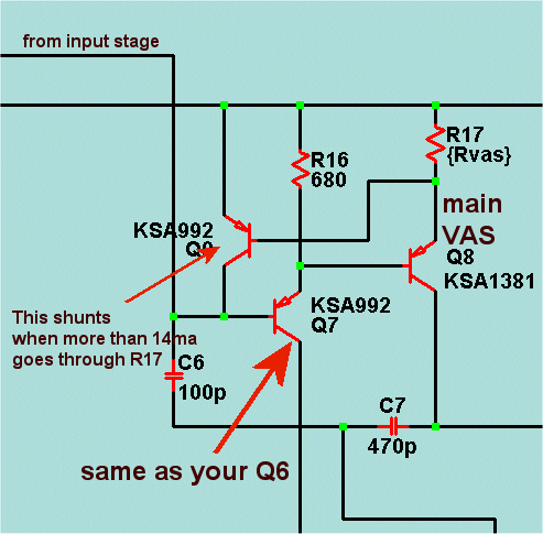

I will share the ultimate solution to the Q6 issue. I have implemented it , and tested it with full clip and dead short on my small output stage. (below)
with a 2R load , it will soft clip. VAS is limited to 14mA ... period. Only drawback ... one more device. :(
This does not affect sound at normal or even very high levels. Just with OP shorts and gross overdrive of input stage. Mine does 130V p-p @ 11ma VAS.

I see.... i have use this method in earlier amplifiers...the Precision has this
circuit....but know i cannot use anymore dear Ostry..there are hundreds of boards provided spread wide world.... the solution must be offered without modifications in the board...there's no room to protection in that board.
Interesting thing...i have several amplifiers playing here....not only or two..i have 8 stereos...and i had no troubles...but happened not more than once...but twice and three times...so...for sure this needs some care.
I cannot ask people to solder parts below boards dear Ostry...they bougth boards in group buy...cheap boards for sure..but offered to do the job without parts soldered bellow them.

Solution changing circuit is not a solution....is a problem dear Ostry...is create another amplifier..and my Dx Blame models are definitive.... the last and best wide world possible sonics...the greatest design from Doctor Self that i had the good idea to tweak to my style.

You can replace Q6 by 2N5551, because some guys reported failures in Q6
We had three guys that informed had Q6 burned..it is a 100 miliamperes transistor, really not too much strong...... 2N5551 can hold more current, more voltage.....or more power if you want.
But you should twist your transistor 180 degrees, because 2N5551, the new transistor for Q6 position had different pin layout.
Supercharged and blue boards does not need that, as this new board was made to 2N5551 and 1N5401 transistors to all models.
But Brazilian blue boards and the original Todd Johnson layout will need to twist the transistor....watch the picture and you see that it is assembled 180 degrees twisted.

A common solution as given by Stochini (EE May 1983) and later Doug Self but an improvement, mentioned by others (inc Andrew T), is to split the VAS degen to ensure premature operation of the protection device doesn't arise at any turn-on voltage.
I modified my "DX-Precision" as shown.
Brian.
Yes , the leach amp does it this way. Referencing a 47R VAS degeneration resistor gives 12.5mA - 33R=21mA - 22R=27mA (Cordell's example). With my low current 6.1mA setup , the 12.5 is quite enough.
Like Carlos , I never had any issues with the beta device (Q6) besides a little warmth. I added the extra device just to make "damn" sure.
