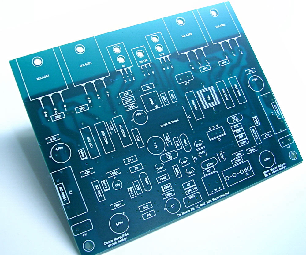

Blue boards are much better....next year you gonna see people building, as we are delivering 100 blue boards (only 24 to outside South America).... january people will be receiving these boards...in the first week of 2011...then some pictures may appear in this forum....mine will arrive before Christmas.... i will be the second one to have them...first was the layout reviser...in this case almost the designer, so many modifications was done if you compare to the original Todd Johnson layout.
Finally i have values instead of part numbers printed over the board....as silk screen..only the interchangeable parts have part numbers alike R1, C3, Q9... this was a big struggle along these last years...i was trying to convince layout designer about that..but they won't to go against the tradition...now i could have boards the way i wanted them...i am very happy with that.

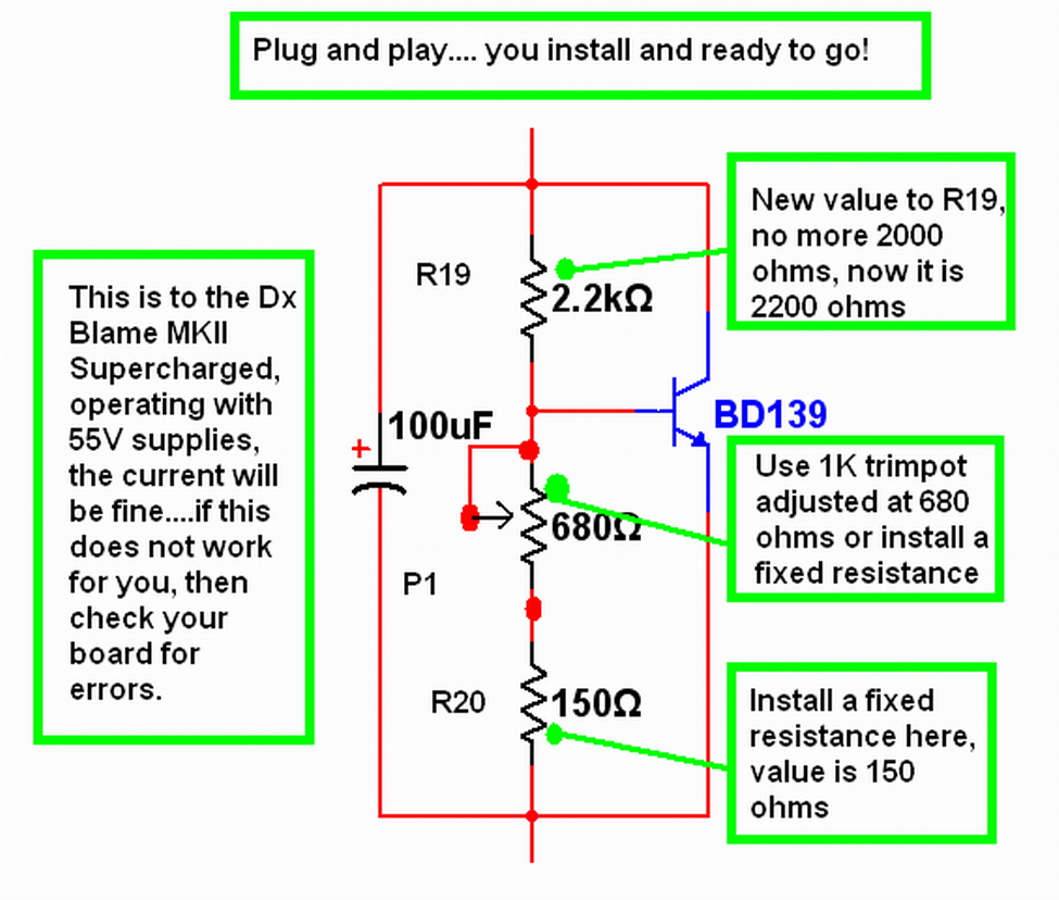

There's an error into the Supercharged bias circuit
R20 should be increased to 680 ohms and the trimpot preset must be 440 ohms..this is only to the blue boards, 55 volts supplies models.

I would like to publish the image of the "plug and play" feature.... removing the trimpot and installing ad 680 ohms fixed resistance in the place..increasing R19 from 2K to 2K2 and installing 150 ohms in the place of R20 (originally 470 ohms) you can just switch on and listen.
Of course if no mistake was made in the board construction....if everything is fine, then the current will be around 50 miliamps and the amplifier will sound beautifull.
People should be carefull with C13....this position does not accept mistakes..if you increase above 100 picofarads you will loose treble..if you reduce it will oscilate and will burn your power transistors...value is 100 picofarads..check this before power your amplifier on.
