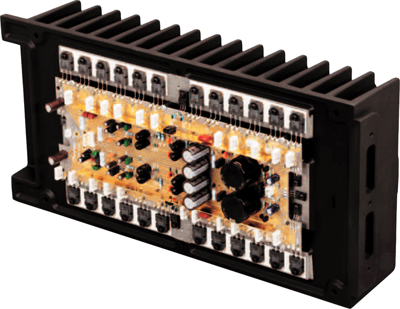

OPTIMUM CASE DESIGN . .
@ CaféNoir,
As I reapply in the post 251 I wonder to ask You if You can produce an Image size like in Yours latest post 281 but with my suggestions below I repeat once more here so it will then be more evidently visible on the picture what are my suggestions, so for the power amp possible the most optimum solution, of course, and not the cheapest one.
1. PCB boards flush to the ALU Heat-sinks and rotate vertically PCB boards that trannies become at a bottom instead at the top !
- This way mounted OP semis will be at the bottom of the H_sinks so the term. convection would be at its best possible NO L BRACKET at all. Transistors are mount directly to the heat-sinks and theirs legs nicely round 90 deg. up. then all should be (mounted on the heat-sinks . . screwed & tightened with all needed supporting hardware firstly... On the PCB boards should be mounted the appropriate standoffs, screw them on to PCB and now insert the PCBs on top the the previously mounted transistors on the heatsinks, with legs of transistors come throe holes on the PCB, now solder them.
- Than for best design practice the PSU Elkos from the main Amp PCB boards should be mounted on separate PCB BOARDS or hardwire them ... they mus be mounted vertically because of electrolyte inside so mounted this way they can do their work 100%. Appropriate min capacity of Elkos should be 60K uF @ each CH supply side for this amp if it is to be as designed. Please move also the OP Coils + Res. directly to SPKR binding posts - this way You removing strong Magnetic pulses (coils generate) from the AMP Board ! Look at the Acuphase designs and You'll see how they do. . . the Masters.
2. extend the height of the heat-sinks so the internal height would be min 150 mm for the diameter size of a standard shielded min. 750VA toroid or R Core transformer!
3. extend deep of the case (two 150 mm Fisher H_sinks) to accommodate 2 pcs toroid transformers min. 750VA each !
4. make an 2 mm Fe L or even better an all closed U bracket for the toroids or R Cores and mount them "INSIDE" (two 750VA toroids) vertically ! Such an mounting arrangement brings also a quite reduced EME - a strong magnetic fields from the transformers.
5. Now You have plenty of room for the missed additional PSU PCB boards with min 60K uF of smoth. capac., the rectifiers, start up & protection boards with assoc. small VA transformers etc.. etc.
And here some more info from the masters of art
Pictures will tell more than 1000 words.
Romero
[image][/image]

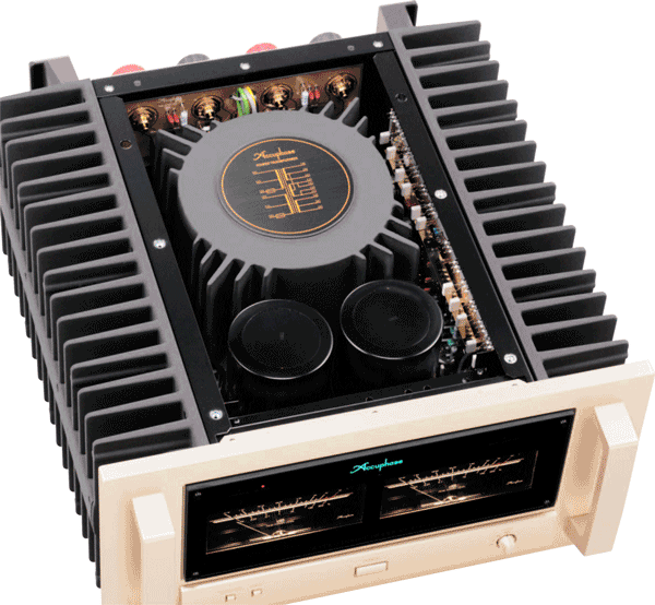

SOUND_Rays, I will try your suggestions, as well as other possible layouts I have thought about. Unfortunately I am at work now, I will try as soon as I get home.
One question: is mounting the PSU caps vertically away from the boards (UNlike the Accuphase you showed as an example, if I understood correctly) really necessary? It could complicate the build quite a bit.

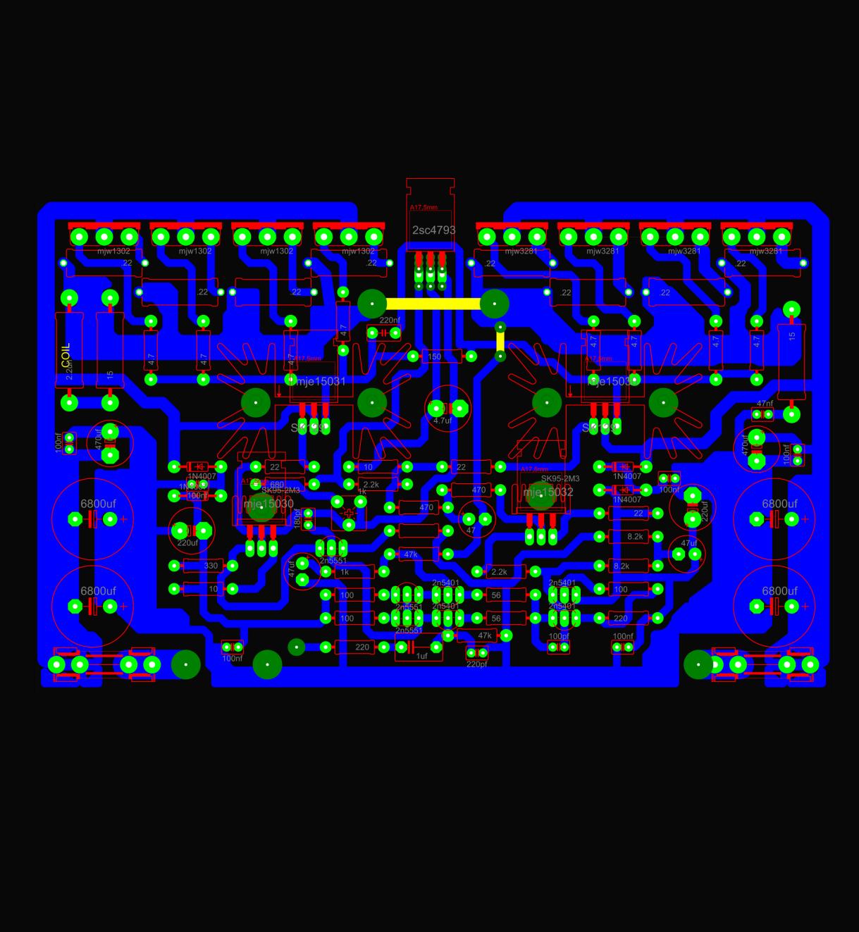

im working on it and almost finish.checking it on gerber viewer online.i will send it to your email and also i have to check some pads and make some small edit.and also can you check clearance of mkt capacitors and power output transistor if exact in size.i use 5mm in mkt.
Send them to me...to my email.
This can be copied and pirates will produce and will sell in Ebay...i do not want to make pirate's life easier.
regards,
Carlos

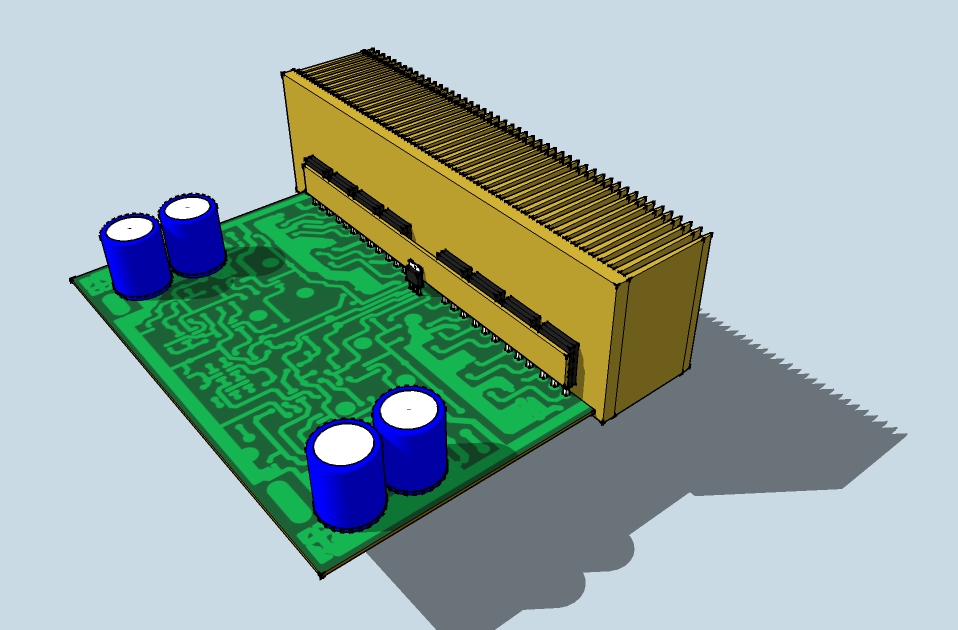

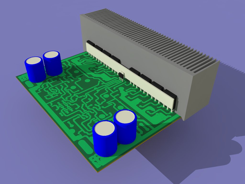

3d layout
just having fun.
for you carlos thanks for teaching me.
just having fun.
google sketch up
my office mate did it.Thank you very much.
What is this software you're using dear Tayag?
regards,
Carlos
