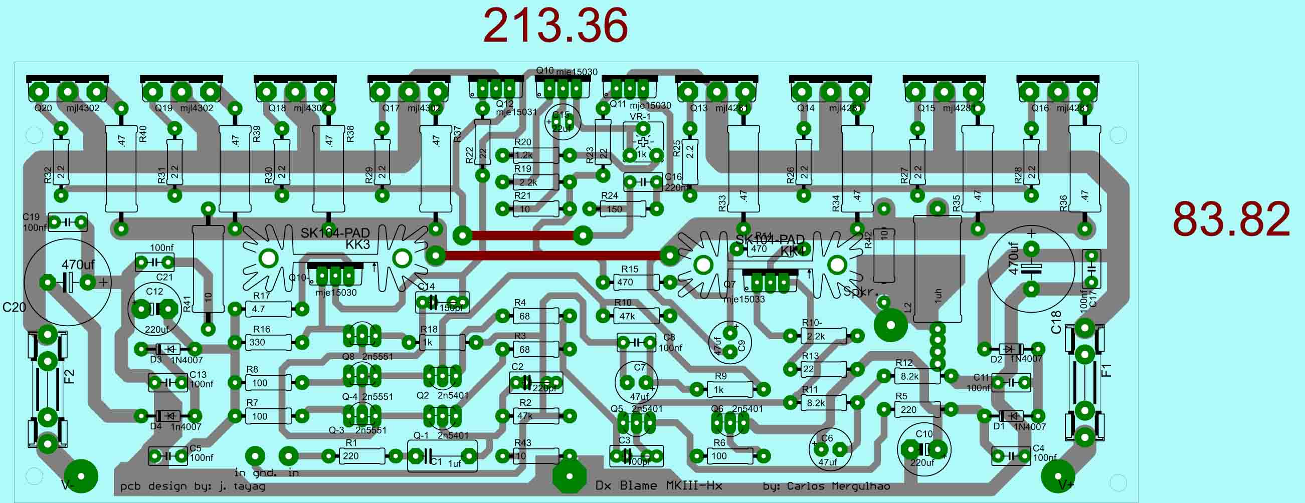

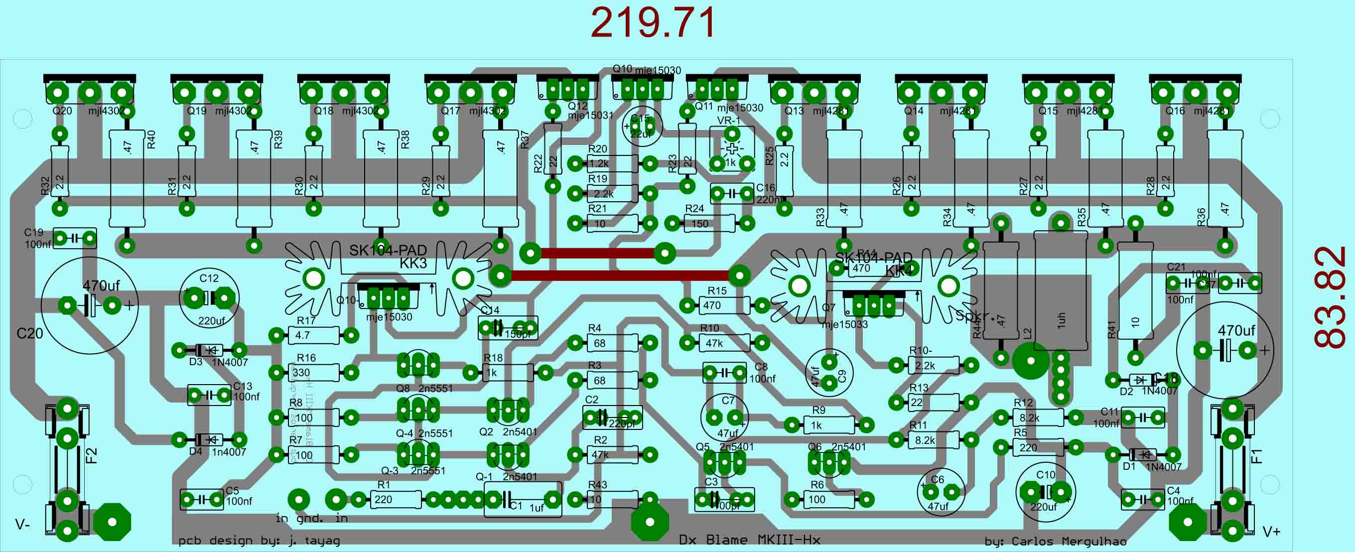

This time i have made amess, and adjustment instructions are in the group buy thread
please, vistit this link below:
http://www.diyaudio.com/forums/grou...uy-dx-blame-mkiii-hx-pcbs-11.html#post2654184
There's a video about adjustment, but better images and detailed text, are in the link i have posted up this paragraph....sorry, this information was to be posted here.
Adjustment to Dx Blame MKIII-Hx - YouTube
New updated schematic attached...it is almost the same.... off set adjustment resistor removed and bias circuit resistance values changed.
We gonna have, soon, a part list...a bill of material.... Byron is producing that for us..... visit group buy from time to time...link is in my signature below...sometimes we have interesting things there.... even if you are not interested in boards, but wants to know what is going on...i am there too...and daily.
regards,
Carlos

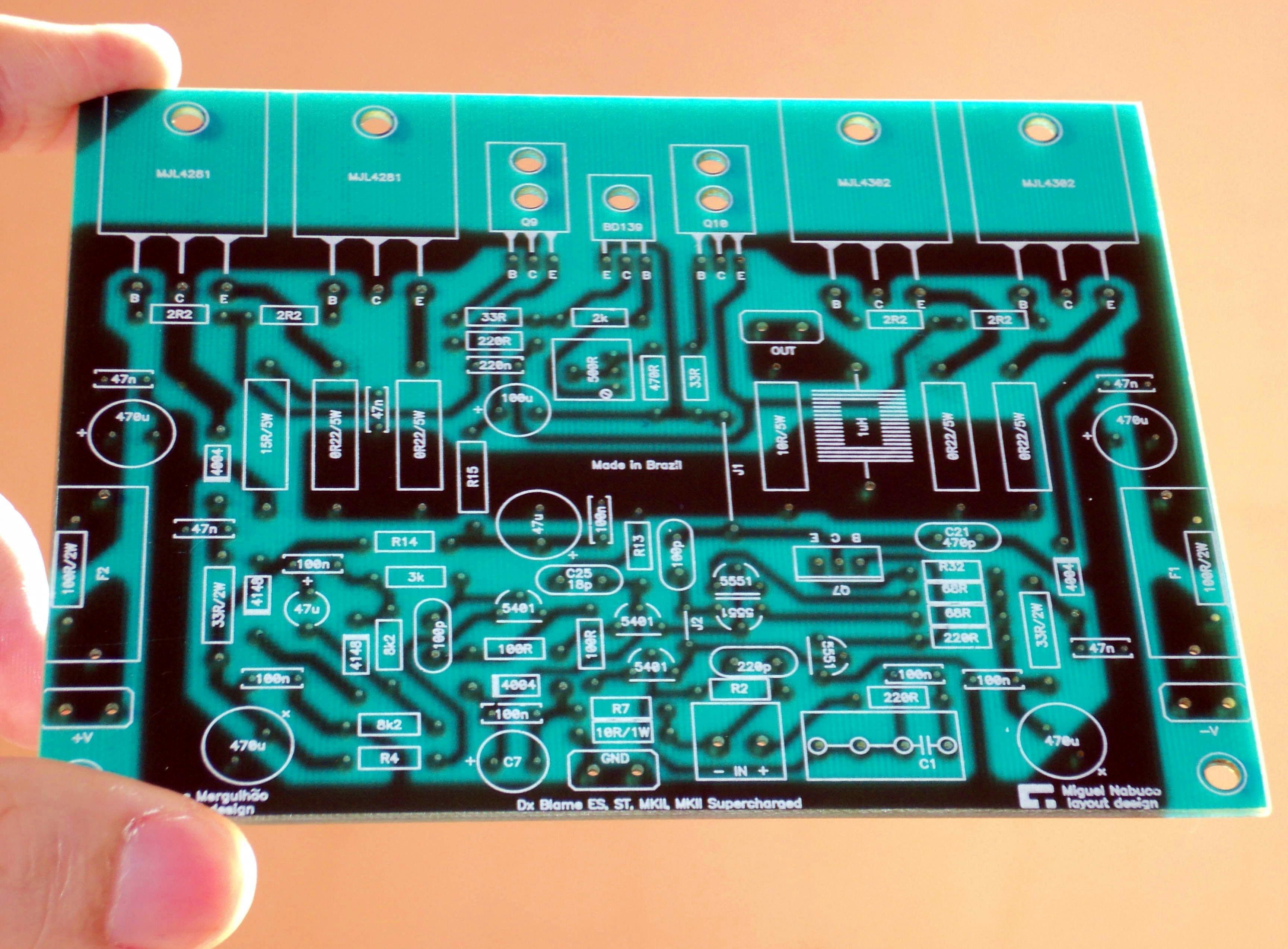

I cannot say as i have not these boards to compare
but seems they are almost the same, both pcboards made based in Alex mm pcboard layout.... small modifications made, thickness of some tracks and colour as Byron ordered blue and Meanman ordered red.... this is all i know about.
Zimmer, from Brazil, have ordered 10 boards and will send me a set as gift, then i will know something to say..... our postal system is slow these days as they have just re started to work after a long strike and Fabio Zimmer have not received his boards yet.
These boards where not assembled prior to delivery, we have just check them several times before Byron nd Meanman ordered production.... it seems they are fine as a couple of guys have assembled and no one have detected problems.
This method of work in group, without test samples price included into the group buy cost list is not good, a risky method i regret to work this way.... very unsafe, we are lucky that we are not facing problems.... was my decision to operate this way.... i regret related this choice i have made.
Boards should be tested, it is hard to be sure about possible oscillations without assemble and test watching scope and injecting test signal, bursts and music while the amplifier is connected to real speakers.... inductance, capacitance and resistance produces complex tuned circuits that may drive stages into oscillations.
Another friend from UK have produced some boards (authorized to do whatever he wants with them), but this one is operating in the old safe style...prior ton distribute boards a sample is already travelling to Brazil and will be tested at my home.
These boards are called MKIII Hx ..... to be different from the Supercharged multimodels blue boards....layout is different and circuit have some modifications that changes performance a lot..... MKIII Hx is the Top Performer from the Dx amplifiers line till today (unreleased MAKO II is even better ... but does not compete as remains unreleased)

r44 should be 10 ohms.
sori forgot to replace when i copy the 5 watts resistor from RE of output transistor.should not be .47 ohms
schematics still the same
