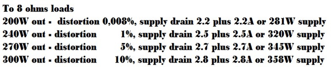

Byron's 300VA transformer will result in a perfect 200 plus 200 watts amplifier
With a very low harmonic distortion.
As i can see, his decisions about are very clever, he may work with 8 ohms (standard impedance, easy to find drivers to match that power) and can search for soft to move speakers, high compliance woofer drivers, 12 or 15 inches units that may fit so good as a glove can fit into your fingers.
Having 200 watts of power, working in a very low distortion range, 60 percent of the power will go to the woofer (musical standard ratio), so, 120 watts RMS will go to woofer...he may find units that are easy to move (not hard centering spiders, not a hard rubber suspension) with 250 watts (IHF) that will be perfect for him... he will save money and will optimize sonics this way.
60 watts (120 IHF) midrange drivers and 20 watts tweeters (40 IHF) will work great too.
Eletrolytic condenser bank can be from 10.000uf plus 10.000uf to 15.000 to 15.000uf to each channel, and this will save money too ... his 20 thousand plus 20 thousand may be good too.
Heatsinks will not be that big, and this will allow him to use two supplies, and this is excellent!

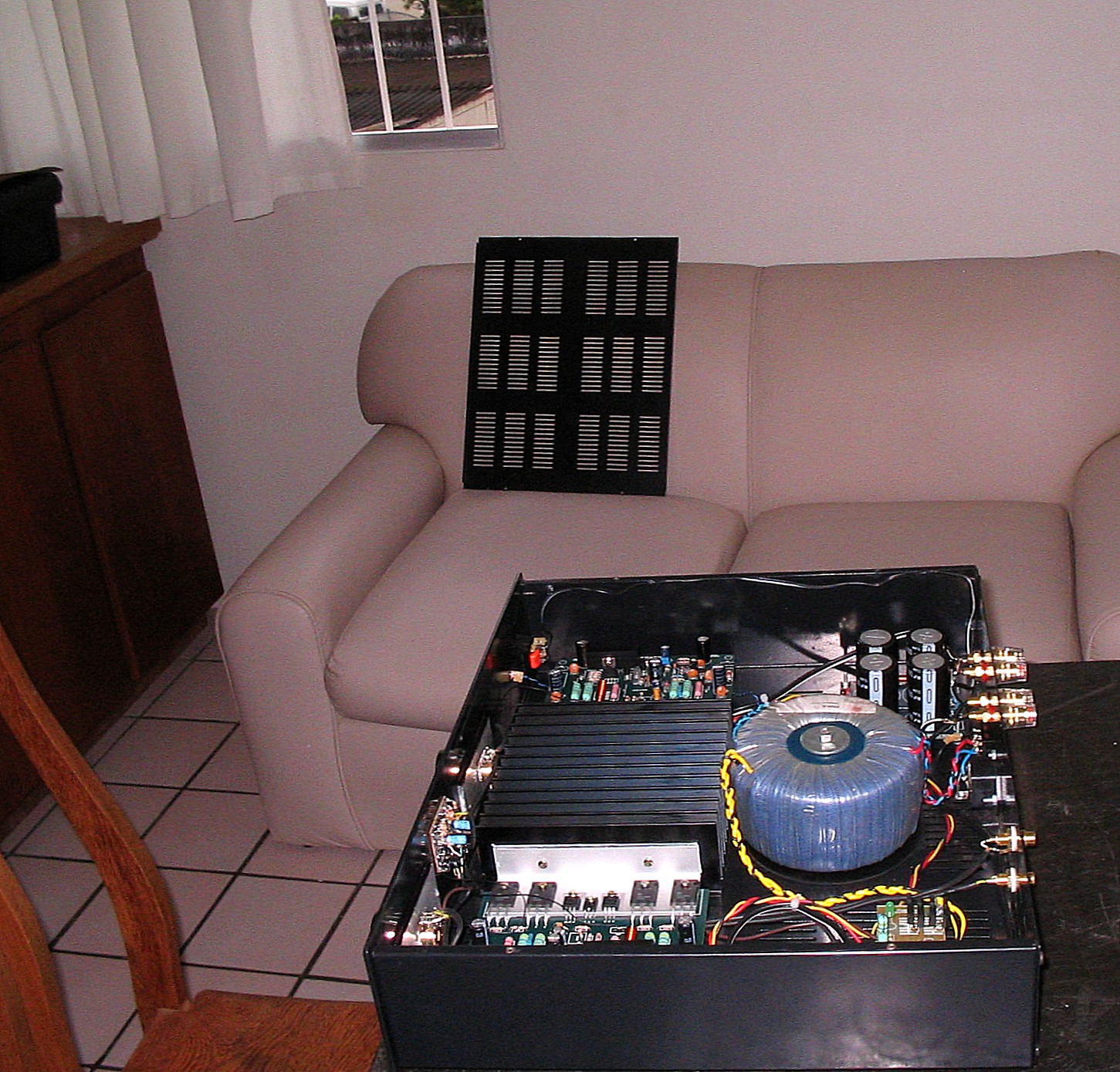

I do think his decision was perfect, or at least matched my own decisions about.... i am using the MKII Supercharged, in that range of power too, and i think that range of power was a perfect decision..not bigger or smaller than we need in the real world... and the MKIII can operate into this power with a lower distortion you can have with the MKII Supercharged.
Picture shows one of my Supercharged units.. i have three, sometimes i connect them together in a pile, then i have stereo bass, mids and treble channels having separated knobs to control volume for these three semi audio bands.
I also plan to use 45+45/300VA power supplies per channel. This will also permit using only 3 output pairs in place of 5, which will cut down $18USD per amp board (so $36 of saving for a stereo amp).
