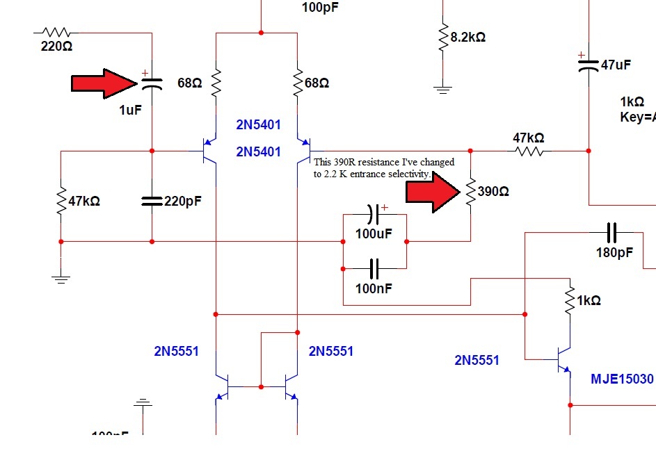

How do I lower the gain?
Thanks, Terry
I probably didn't say that right. When I say I don't think it is a loop, I meant one caused by connecting both sides of the source. Obviously I don't completely understand ground loops or we probably wouldn't be having this conversation. I am not presently driving the amp with a preamp. I am using a CD player directly into a 50K pot and into the amp. None of the other amps I have are displaying this hum so I believe the source is not the problem. As for gain, I believe the DX Super A is higher gain as it is louder that the MKIII with the same input signal and the MKIII is +-80V rails and the Super A is +-37V. The Super A is dead quiet.
Thanks, Terry
Hi Terry,
I have this resistance changed to 2.2K
Rudy
The change Rudy shows reduces voltage gain from 120 to 21. Gains of 20-30 are typical for most power amps.
Terry I'm also using a 1uF film cap for the input cap and have changed the 390R resistor to 1.5k to reduce gain.
I also use a 1.5K for gain control. It gives a 30dB gain. The initial gain of 121x with the 390R (42dB) is OK to avoid the need of a preamp with low-powered sources (MP3 players). It has the drawback to amplify every little stray interference... big time.

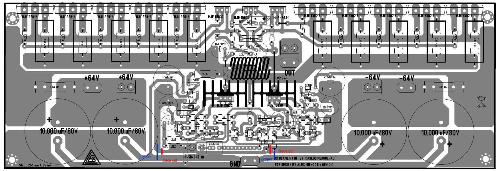

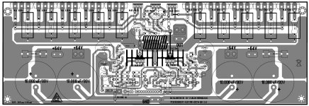

OK, I have looked over the boards and it seems that two trace cuts and two jumpers can solve the lifted ground issue. I am posting a couple illustrations for discussion. Please look them over and let me know if you see a problem with this change.
Thanks, Terry

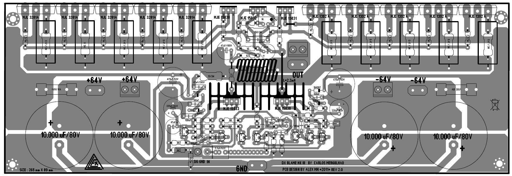

Terry, did you try modifying the lifted ground traces? Btw, Make sure you use the correct PCB plan (i've joined the correct one)

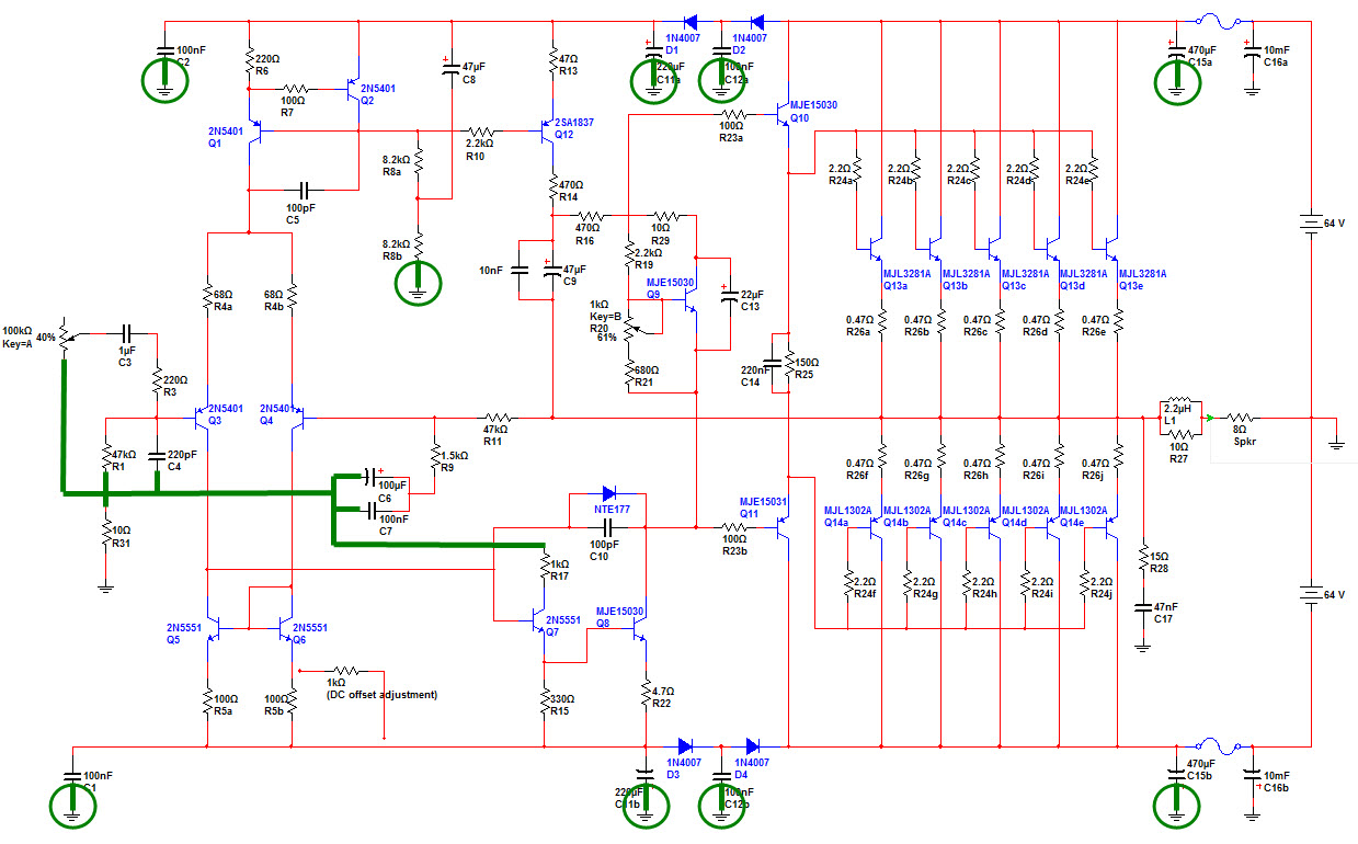

Question to all: what are the components that should be part of the lifted ground? I've joined a picture that shows what actually uses the lifted ground. It's... it seems wrong to me.
Martin.
Martin.
R17 should not be part of the lifted ground circuit but should go directly to the star ground. The same is true for R8b and R15 which are currently part of the lifted ground.
Steve
Hi Martin,

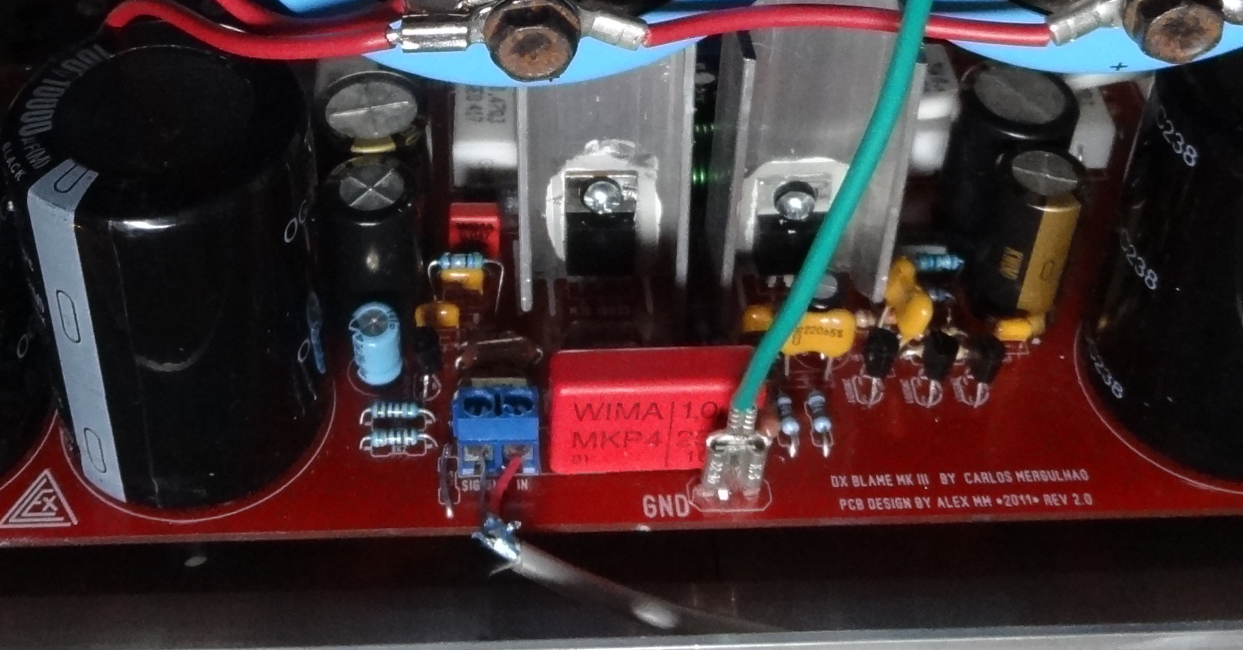

Yes, actually I just did it yesterday. I made two trace cuts and added two jumpers. I didn't include R17 in the lifted ground. I can include that if necessary. I also added a ground loop lifter at the earth ground. It is better but there is still a slight hum when something is plugged into to input. The left channel is worse than the right. I am attaching a pic of where I made the cuts and added the jumper. I installed the 1w/10R resistor at R30. I left the resistors that I have at the RCAs. I may try jumping those to see how it affects the hum.
Blessings, Terry
Blessings, Terry

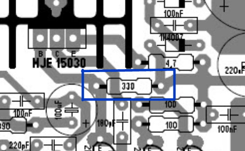

Hi Steve,
R15 doesn't go to ground. I goes from D3 to Q7E. I didn't notice R8A. I can swing that and attach it to the main ground. I'll try that tomorrow.
Blessings, Terry
Hi Terry-
You're right about R15 as it appears on the schematic. I was looking at the board layout as posted by Byron and there seems to be a connection from the left side of R15 to a trace going left across the board to the lifted ground. I haven't confirmed this on the actual board so maybe the posted image is wrong or I'm not seeing it correctly. Since you have your amp apart perhaps you can confirm that R15 is properly connected to the negative rail and Q7E.
Steve
