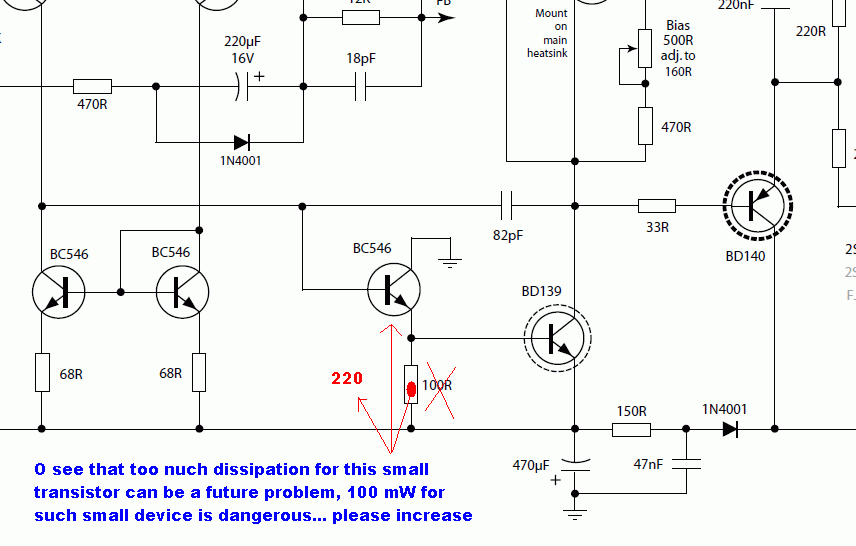

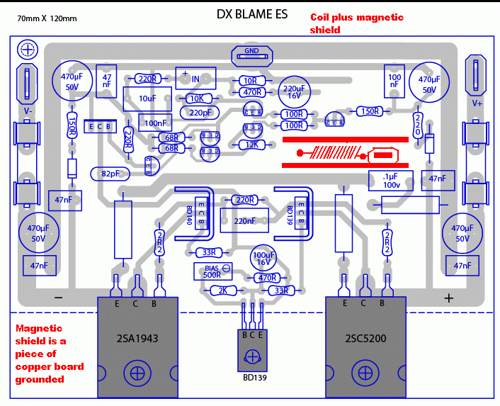

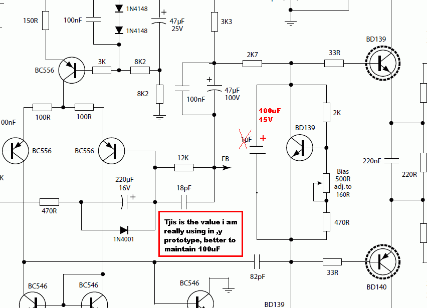

I was thinking, after some Doctor Self book reading and thinking about
Eva, Wahab and GV, that i have to make some changes.
The first VAS current was too high, too much dissipation to that small transistor, i have decided to reduce the current, increasing the emitter resistance.
Also, i found that i am really using the 100uf and have tried 1uf without advantage to stability in the VBE multiplier, also i have reduce and tried to unstabilize the amplifier to see some advantage... i found none, so, will keep the electrolitic condenser as it seems not be bad there, also Doctor Self is using.... it may not be so annoying.

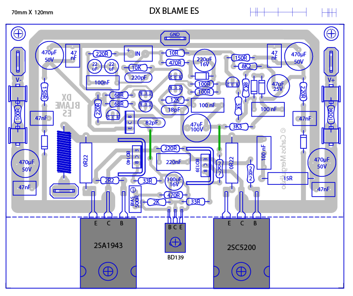

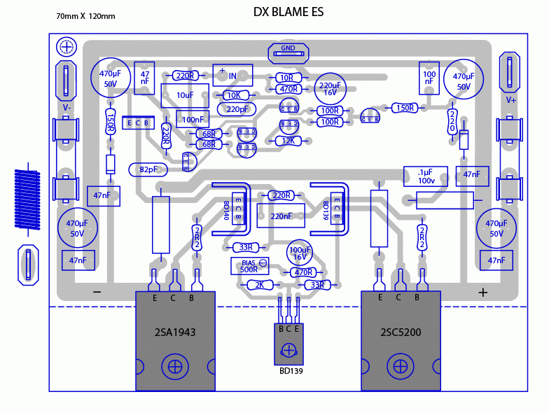

Todd has produced the earlier first try prototype, and as usual
a very nice work, very good to my eyes.
He gonna start to analise to make it even better.
To beginners:
Magnetic shield is a piece of board not etched, soldered, or glued or fixed using wires as leads soldered in the board the same way you solder parts, holes and leads crossing holes and beeing soldered, the copper side is connected to ground.
The output coil is crossed by several amperes, also a lot of volts are there, there are power, and this produces electro magnetic energies that can be picked by the surrounding parts...doing this way you shield and nothing will happens, you can even install near the input capacitor without troubles.

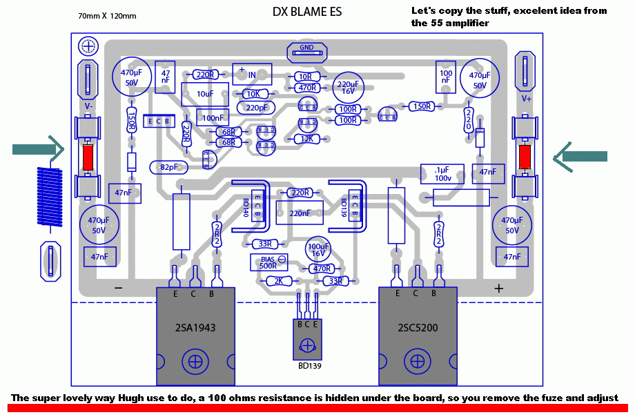

To beginners, the resistance hidden under the board
a feature from the old and good Aksa 55 from Aspen Amplifiers.
Two hundred ohms resistances are soldered bellow the fuse holders, under the board, so, they behave as protective resistances when you remove fuses.
You install a DC voltimeter and switch power on (or two voltimeters, one to each rail), then you will measure a DC developed over these resistance extremes, 4 volts reading means you will have 0.040A crossing.
Ohms law application, current is voltage developed into a resistance divided by teh resistance ohms value:
4 divided by 100 = 0.040
Carlos
no wonder that i adjusted the value to 330R in the revised schematics
i sent you...it was not by chance...
also, for good bass, the booststrap capacitor is strategic..
47 uF as in all old schematic is to meager if the amp
must be used at high power output..
220uF is more adapted...

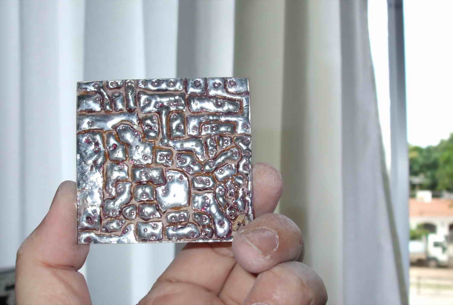

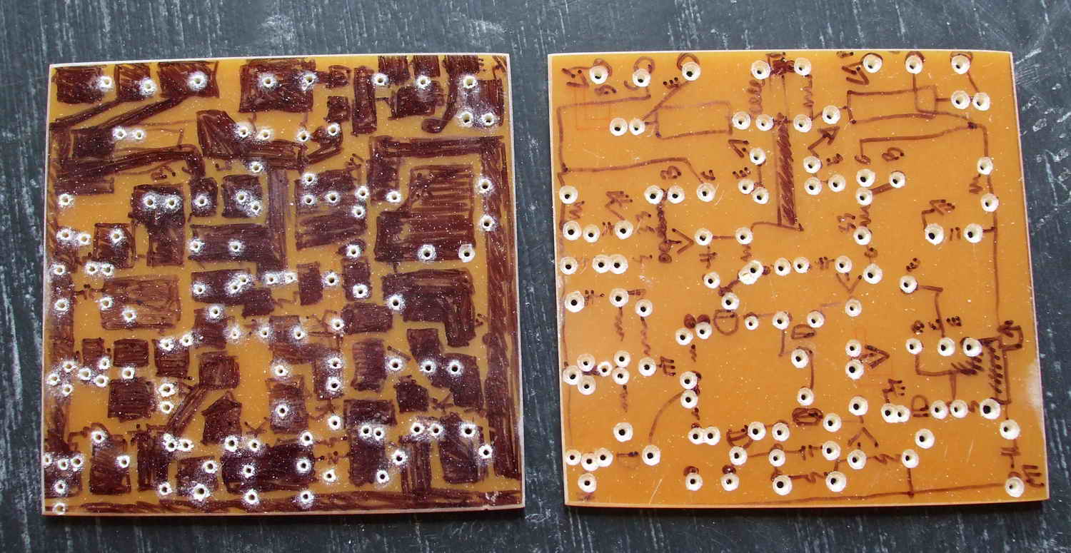

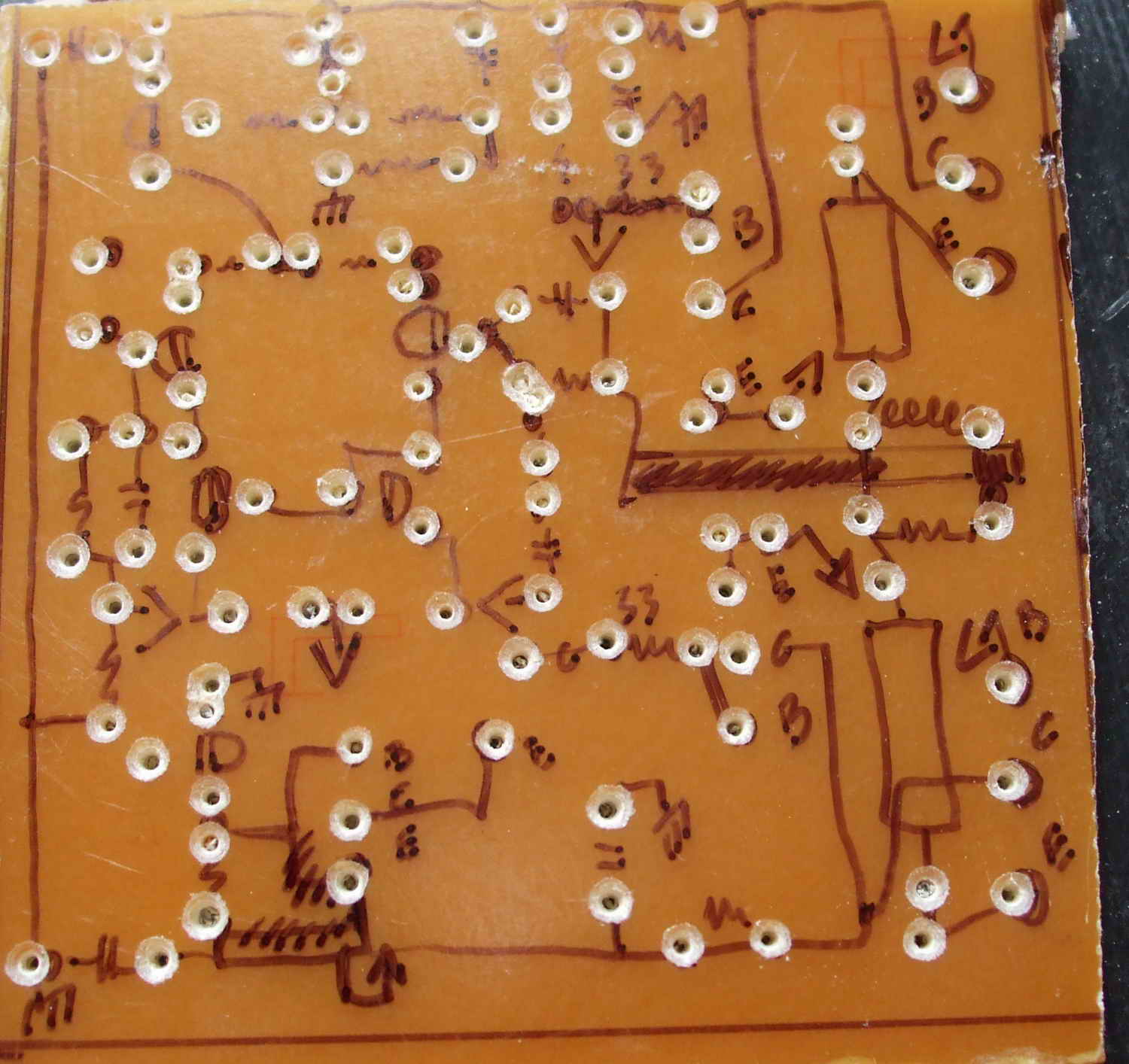

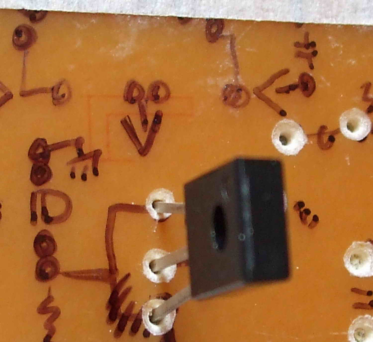

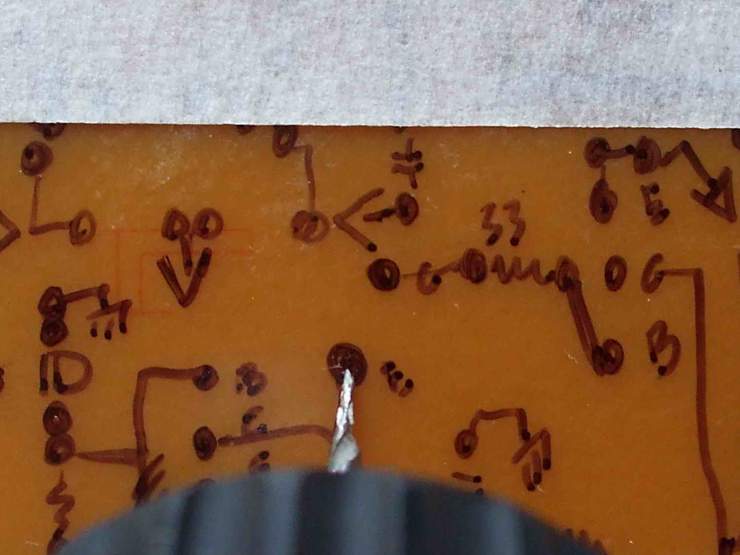

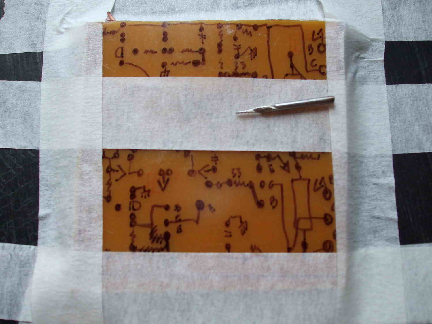

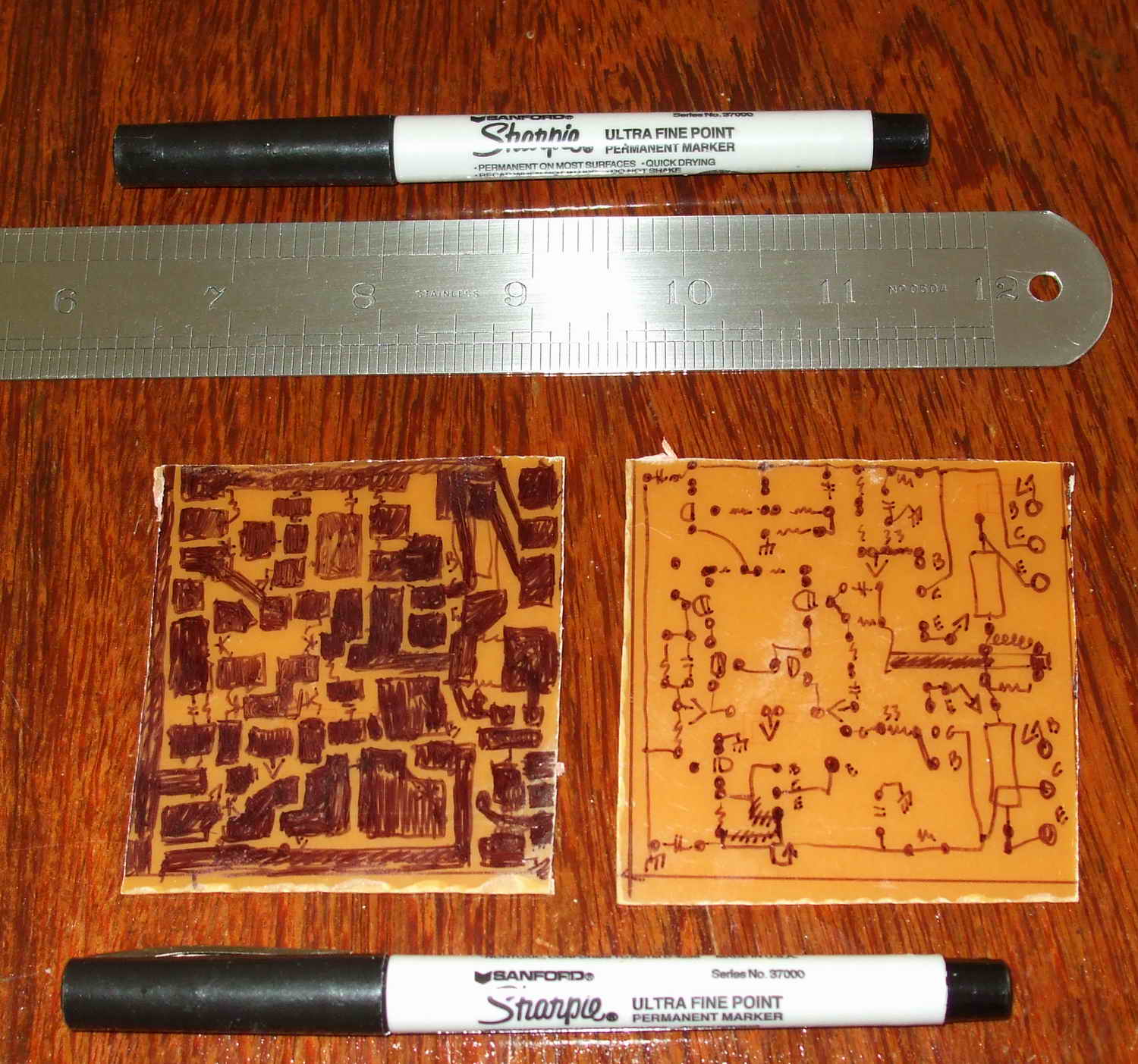

The amplifier is playing, and while i am listening the production continues to run
I am doing another board, smaller and better, made using another way, using Dremmel high speed drilling machine to erode copper.
regards,
Carlos
regards,
Carlos

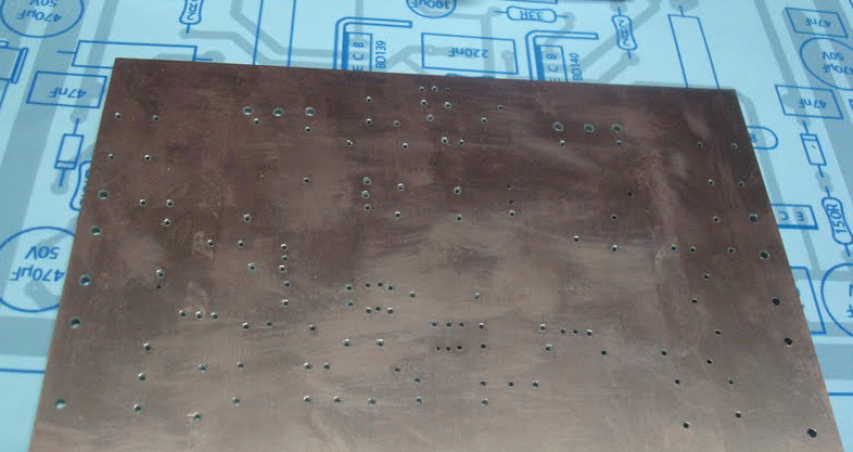

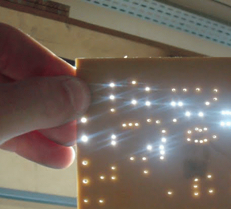

My people, from the Orkut group of builders, are already building
Mr. Comerllate is already trying Todd board, even not having the final revised layout (minor modifications to be made, nothing that can impeach the good operation).
Also we have another one, Danilo, that is trying our own group local layout, Orkut layout to be build for us too, a second option, not the official option that is Todd Johnson pcboard layout, he is the board and schematic designer, the Art Director from the Corporation, overseas director.
the layout was not checked, this one dark blue was not even revised, i am just showing and informing you what is going on this side of the Globe.
Brazilians are moving their a---s.
regards,
Carlos
- Dx Blame ES .... based into the Blameless, i am trying a new amplifier
