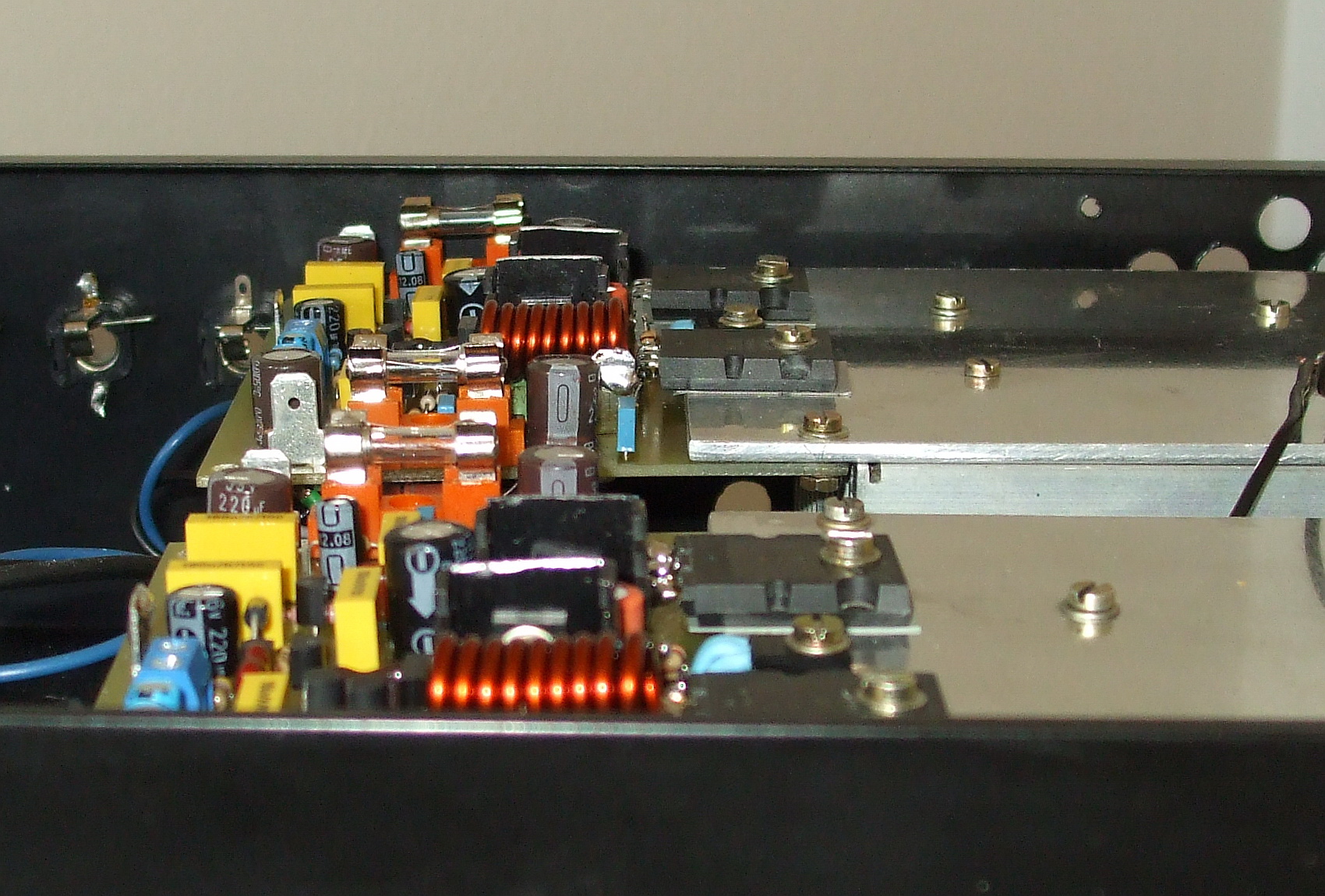

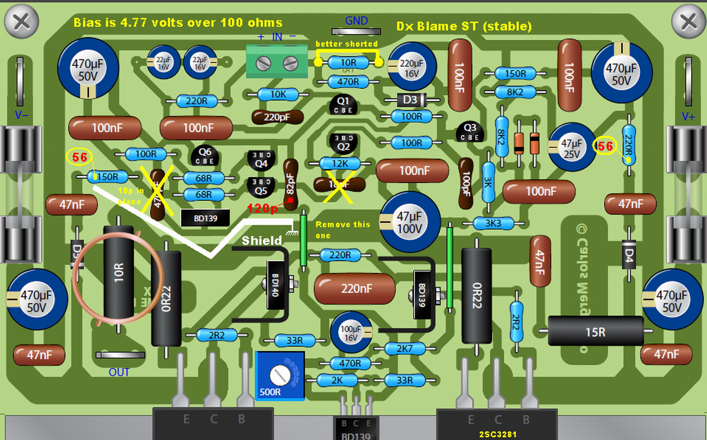

Fixed!...now rock stable...Guaranteed@.... Build it!
Builders...now you know how to stabilize.... thank you WAHAB and thank you KLACHKISTE by your cooperation.
I do not know about sonics..will test this latter.
The shield is a piece of food can... something that have iron....soldera wire on the blade and run it to the ground...you can insulate the blade, painting or covering with some plastic foil...glue it to make a shield, a wall, a barrier between the output coil and the input circuit.
The image show you what to do..... all informed there.
Be happy.... i hope sonics will be good..... i do not know...doing other things this morning.

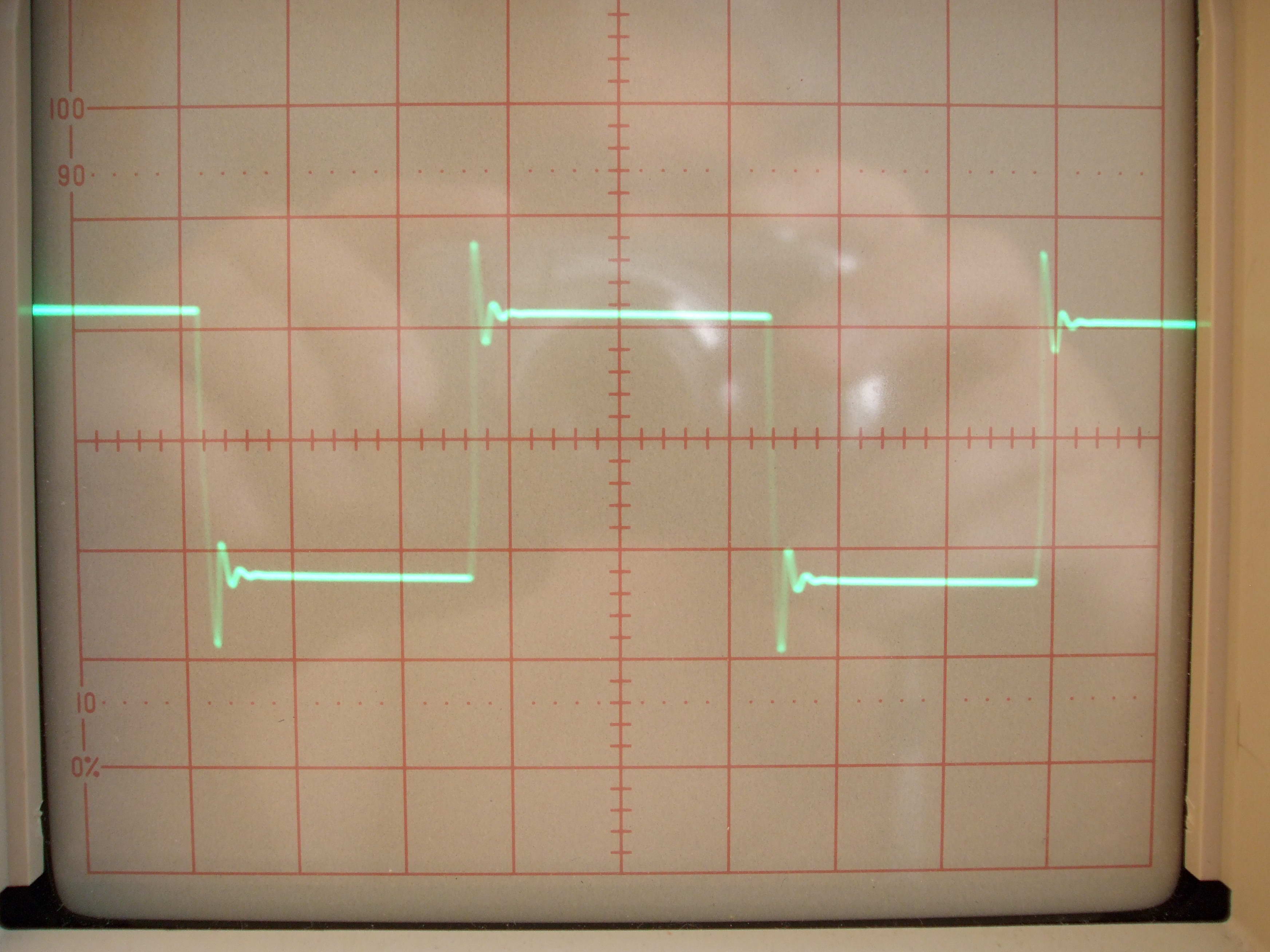

Image shows 25 Kilohertz waveform with 7 ohms inductive resistance as a load... square wave entered.... full power, below the clipping naturally...but can clip without problems....tested till 100 kilohertz and several volts have entered..rock stable...not dangerous anymore.
Other image, is 20 Kilohertz with 2.2 uf in parallel with the 7 ohms inductive resistance... square wave entering, and below the clipping threshold naturally...almost full power.

Update is in post 866, the artistic image has some new values, parts to be removed
too.... the schematic is almost the same, exception are these parts.
New schematic will delay a lot, as Todd is really busy those days.
So, use the 866 image after assemble the amplifier, you will remove two capacitors and will substitute 2 resistance values and other small things...you can do that after construction following the schematic provided, version 1.3 and layout provided, version 1.4.... also the artistic view from Todd Johnson is very helpfull to assemble and to check parts.
I suggest you to build using the Dx Blame ES schematic and layouts...after finish, then you will remove some parts, will substitute one capacitor with a bigger one, or will solder 47pf bellow the board to increase the 82pf capacitor value,will solder a jumper in the input lift ground resistance, will produce a small shield or will remove the output inductor instead to use the shield, installing it in the output connector.... well.... the Dx Blame ST is almost the same amplifier...small modifications only.
I have not idea when we gonna have the St schematic...so..if you decide to wait, maybe will wait a week or several monthes.
Dx Blame ES boards are not modified, all modifications can be made in the same board...no special board..there's no copper track modifications.

Hello Meanman.... means remove the 18pf capacitor, C18
Not the condenser and nor the jumper...the white line is not a jumper, it is a metalic sheet, alike the ones you have in food can.... a shield, alike a magnetic wall to insulate magnetically the output coil that can send magnetic field to the input circuits..the big white line means the metalic shield that has a wire soldered to it, and the other wire extreme is connected to ground.
The metal shield must be glued into the board, positioned alike a wall, and the metal must be insulated using plastic tape, paint or other idea you may have.
Other thing you can do, not to use the shield, the metalic piece of steel..is to remove the output coil, also the 10 ohms resistance associated, and install them in the output connector..the place you connect your speaker wires..this way you do not need to use the metalic barrier..the shield (idea from Andrew T)
regards,
Carlos
Hello Pocoyo!
