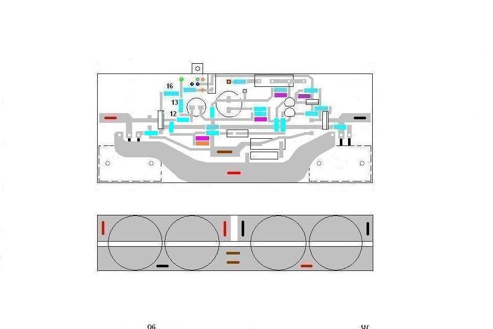

What about installing the output in the middle of the PCB?, because there is a big track there, just where you wrote "remove this one" in yellow letters. This way we respect simetry and a certain distance between power rails, input section, output devices, and we can instal the zobel on the speaker's binding posts...just a couple of holes with a Dremel
Hi, sorry to hear the troubles

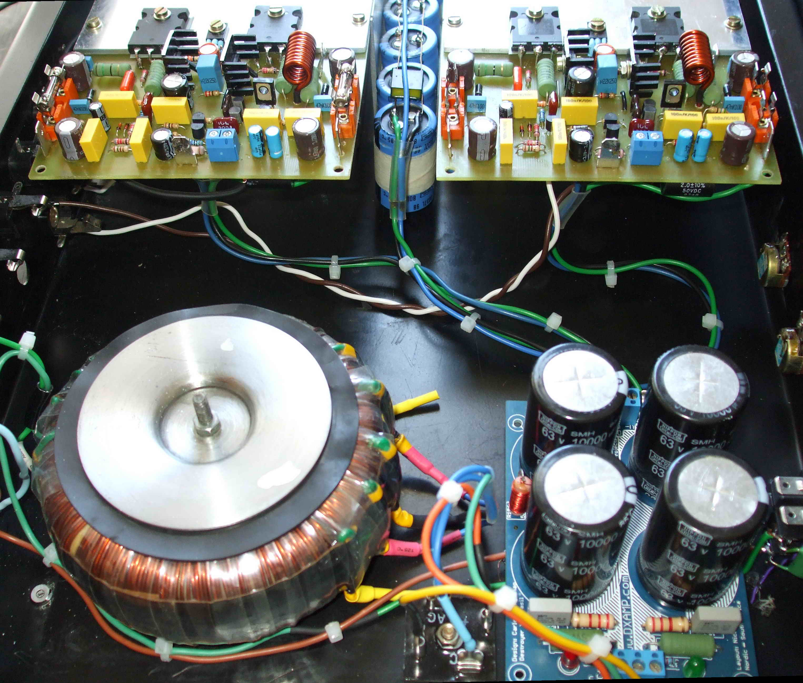

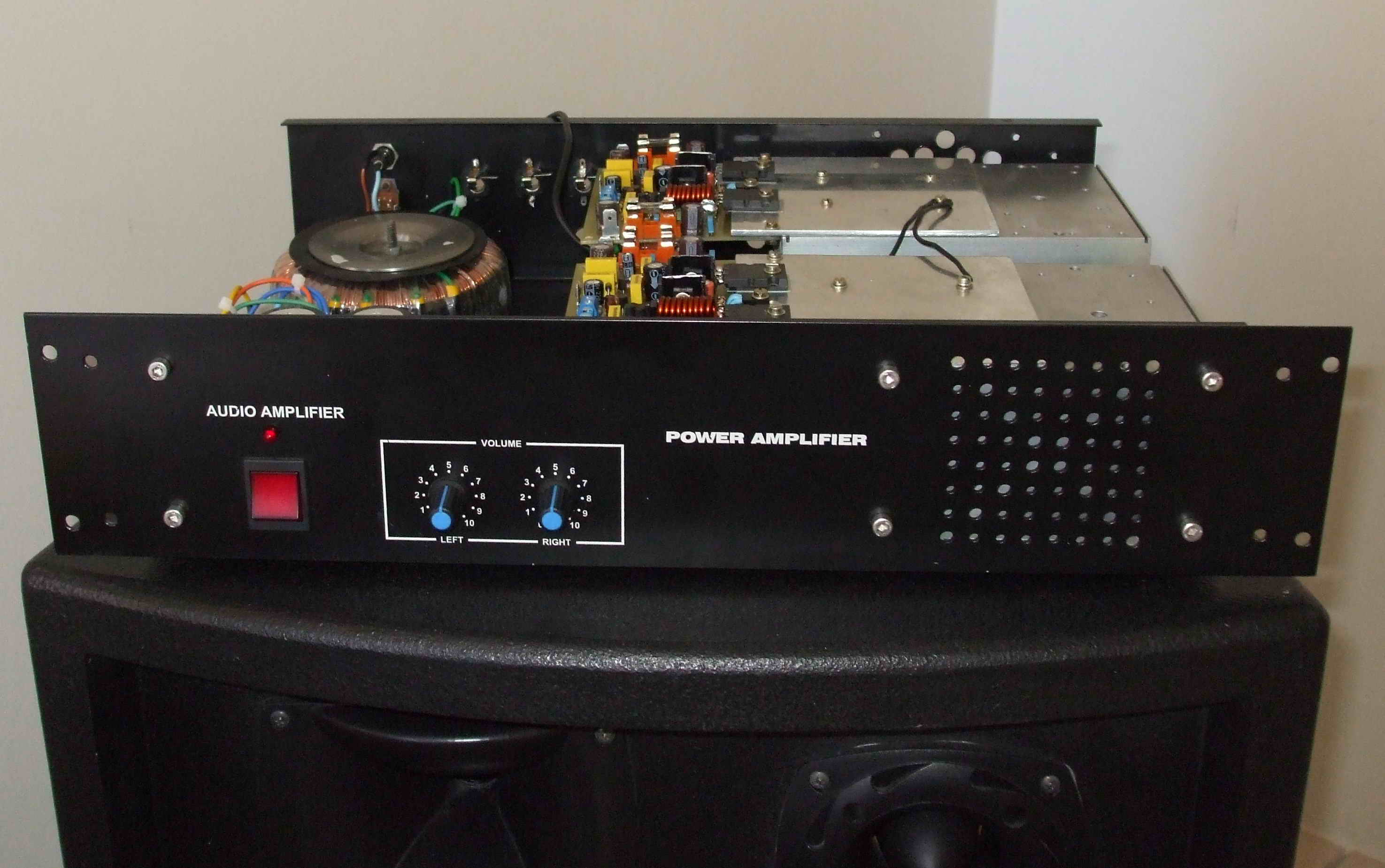

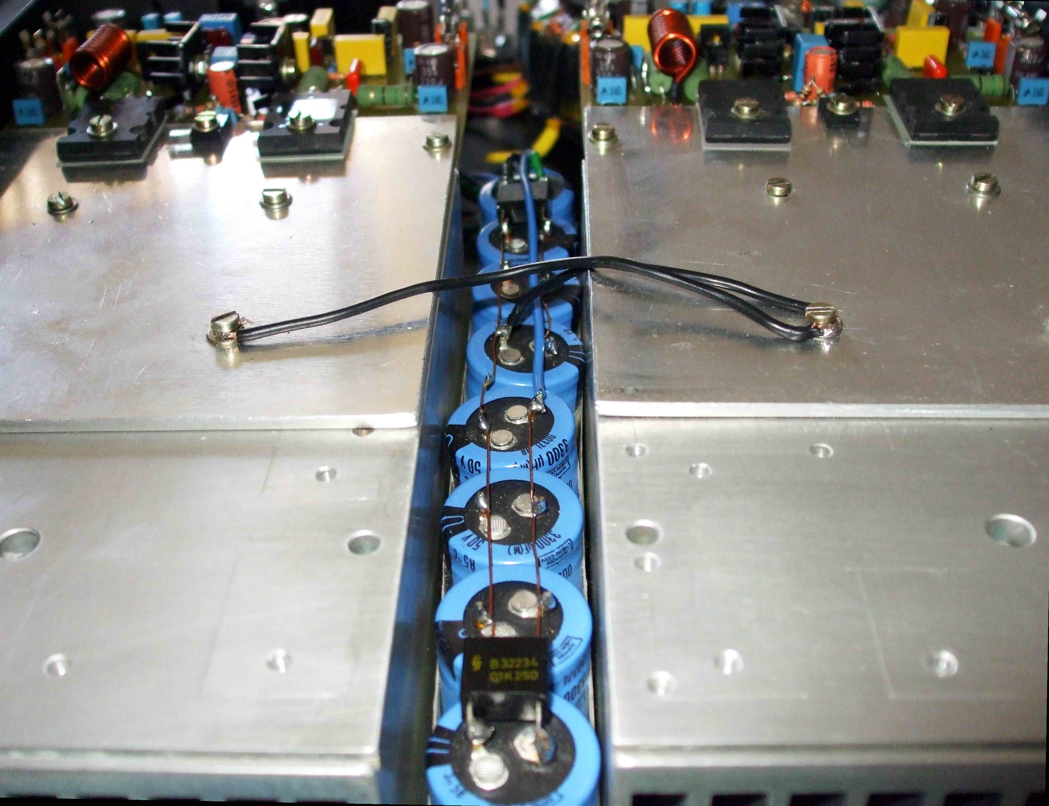

In this Dx layout I have tried to "reverse" output transistors, just to see what happened
Note that board is mounted flat on heatsink, upside down
Should fit a relatively cheap 80mm box height
Wires from supply to amp board are straight and very short
But I have had enough layout headackes even with the much simpler Dx

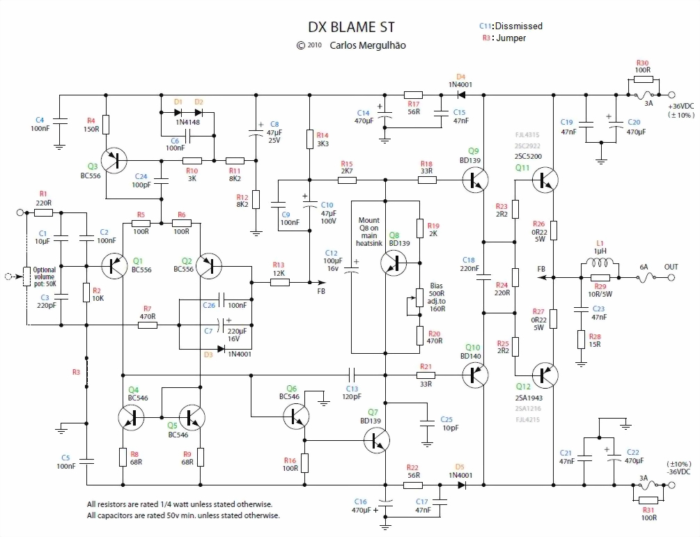

Soundbuster have prepared a provisory schematic
this one include the minor modifications, so, it is the Dx Blame ST schematic, the stable one.
This will help you, an interim schematic while Taj is busy.
Not to complicate things...build exactly as the Dx Blame ES schematic, use the artistic view to check your construction...then, replace rail resistances by 56 ohms or 68 ohms (R17 and R22), increase Miller capacitor, from 82pf to 120 pf, or install a 47pf unit in parallel with the 82pf (C13) capacitor, remove C11 and substitute C25 by a 10pf unit, use wire jumper and short R3.
Remove output coil and zobel filter and install them in the speaker output connector, or install the shield as posted, and explained previously.
Increase your stand by bias to 4.7 to 5.5 volts and enjoy the lovely sound from this, almost perfect, audio amplifier.

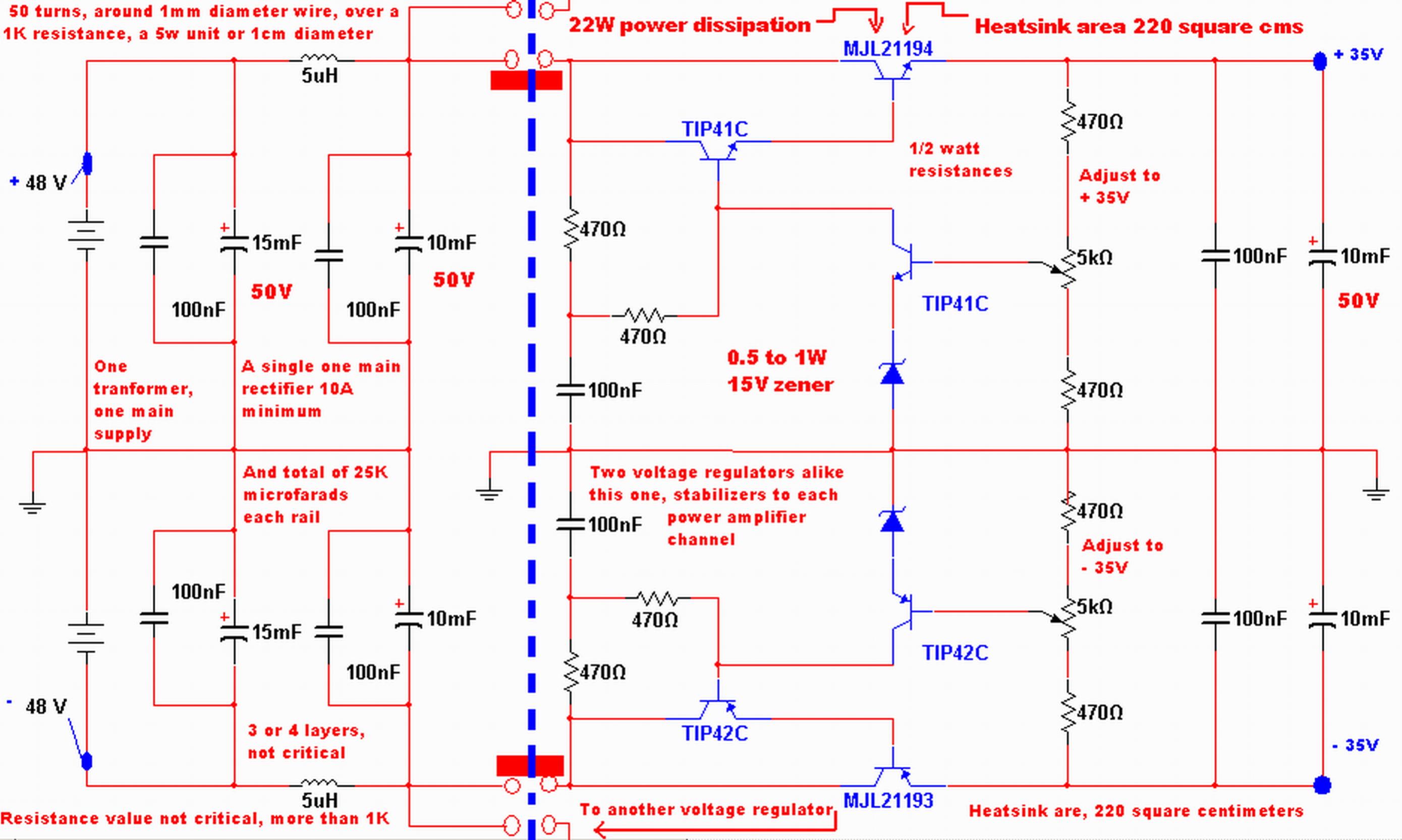

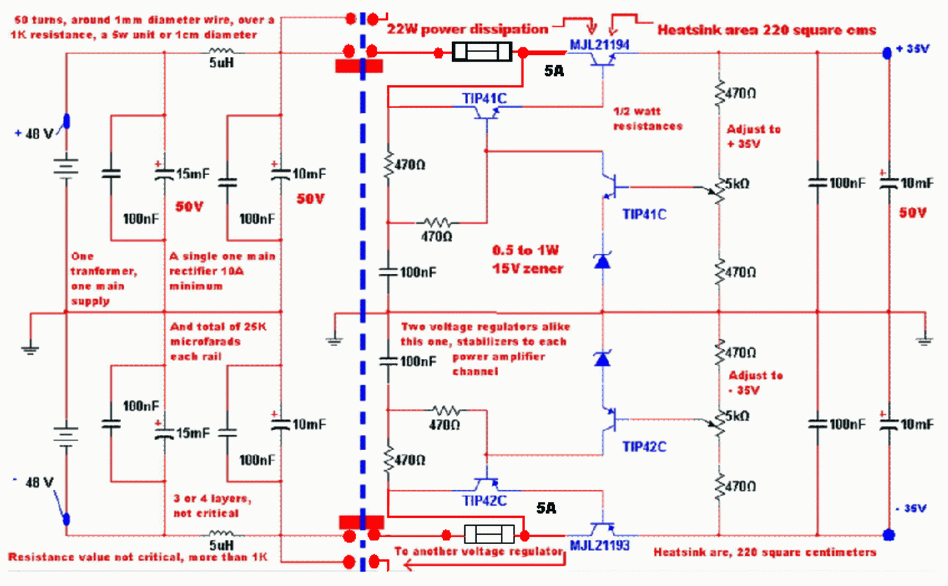

Dx Corporation Voltage regulator, an electronic, adjustable, voltage stabilizer
Made to my needs, but can be used as a Workbench regulator, and can be used with several amplifiers..input voltage to the electronic stabilizer circuit (with error amplifier) can go from 48 to 64 Volts.
This was made to the ones (me!) have only a single power transformer and want to use it, connecting to two Dx Blame ES, or ST, or Dx Amplifiers, or HRII or any other amplifier you want....but having not interaction of voltage drops between these 2 stereo amplifier channels
This way, i am using a single transformer, a single 10 amperes (minimum) rectifier bridge or discrete diodes connected in bridge mode, and a single bank of condenser to face 5 plus 5 amperes (each rail power drain).
This was calculated to 35 plus 35 volts, and 2.5 amperes each rail...so.... i will use 2 (two) electronic voltage regulators, despite you see only one in the schematic rigth size referenced by the vertical blue dotted line.
The voltage drop is 100 milivolts when power amplifier will working full power (undistorted) and can face clipped signals till 3.5 amperes without big losses, big drop of voltage...this keeps voltage stabilized in the output despite other channel variations of current drain..... it is the way i found to use a single transformer, a single condensers bank, and them to have stable supply without any interaction in between these two channels used in a stereo amplifier.
Is this better than 2 transformers, two rectifiers and 2 condensers banks....i think it is not better, also voltage regulators must be very fast, as power amplifiers in the microsecond one may have 100 miliamps and then in the microsecond may have 2.5 amperes each rail.... electronic supply must be fast enougth to follow these fast variations, so, they must be so fast as the amplifier, and better if electronic supplies be faster than the audio ... amplifier.... as my voltage regulator is not faster than the power amplifier current drain variations, then i am using another electrolitic condenser bank to supply electrons while the voltage regulator will be thinking "what to do next".... the electrolitic, in the output, will do the job while the electronic regulator will be thinking.
This is some sophistication that some folks loves, other hates, works fine, i have made hundreds and were applied to Radio Amateurs, when their transceivers jump the consumption from 500 miliamperes to 30 amperes in microseconds when transmitting in USB mode.
Heatsink size, series transistors pass transistors quality, will variate depending your input voltage (in my case 48 Volts) voltage and current consumption...so...it is shown to 3 Dx Blame ST and using 48 volts in the input ...... other cases may be studied if you need.

Todd Johnson is beeing invited to produce boards...of course others can cooperate too, but Taj boards will be official unless he decline to do the job.
Board wanted!..board layout wanted.... a single board, having two rectifiers, two voltage banks ( i will, personally use a single one) and two simetrical voltage regulators.... the smallest possible please..the condensers are already big enougth..but may left room to bigger condensers, because people may need to install higher input voltage, needing high insulating voltage condensers, that usually are bigger in diameter.
Series pass transistors can be any power transistor able to face 64 volts and 10 amperes, also other transistors can be replaced too..zener is 1 watt and resistances are 500 miliwatts or more...capacitor insulating voltage will depends your input voltage selected.
Is this better than the traditional, common and standard supplies?
I do not think so, it is an interesting resource to use in several amplifiers, also to you to "feel" that difference, can be very helpfull, but it is complicated and expensive.... serves when you have NO 2 transformers to use.

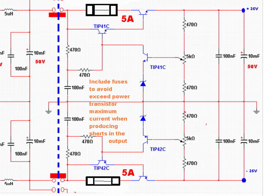

For safety reasons, install fast blow fuses before the series power transistors
So, exceeding the transistor safe limits, then the fuse will blow and no more excess of voltage will go to the power amplifier.
Attention, the Dx Blame ES and Dx Blame ST (they are almost the same) have the output fuse in the schematic, but have not the output fuse in the board...it is needed.... because amplifier failure will send rail voltage to the output, and this will go to the speaker and may burn the speaker..so, use, always, a fuse for speakers.
Install a fuse in the power output, in series with the speaker, 5 amperes, fast blow is fine.
regards,
Carlos

Dx Blame ST output fuses
Use 2.5A slow blow to 8 ohms loads...or 3.0A fast blow fuses.
Use 5.0A slow blow to 4 ohms loads...or 6.0A fast blow fuses.
This is when using 35 volts supply...other voltages must recalculate.
regards,
Carlos

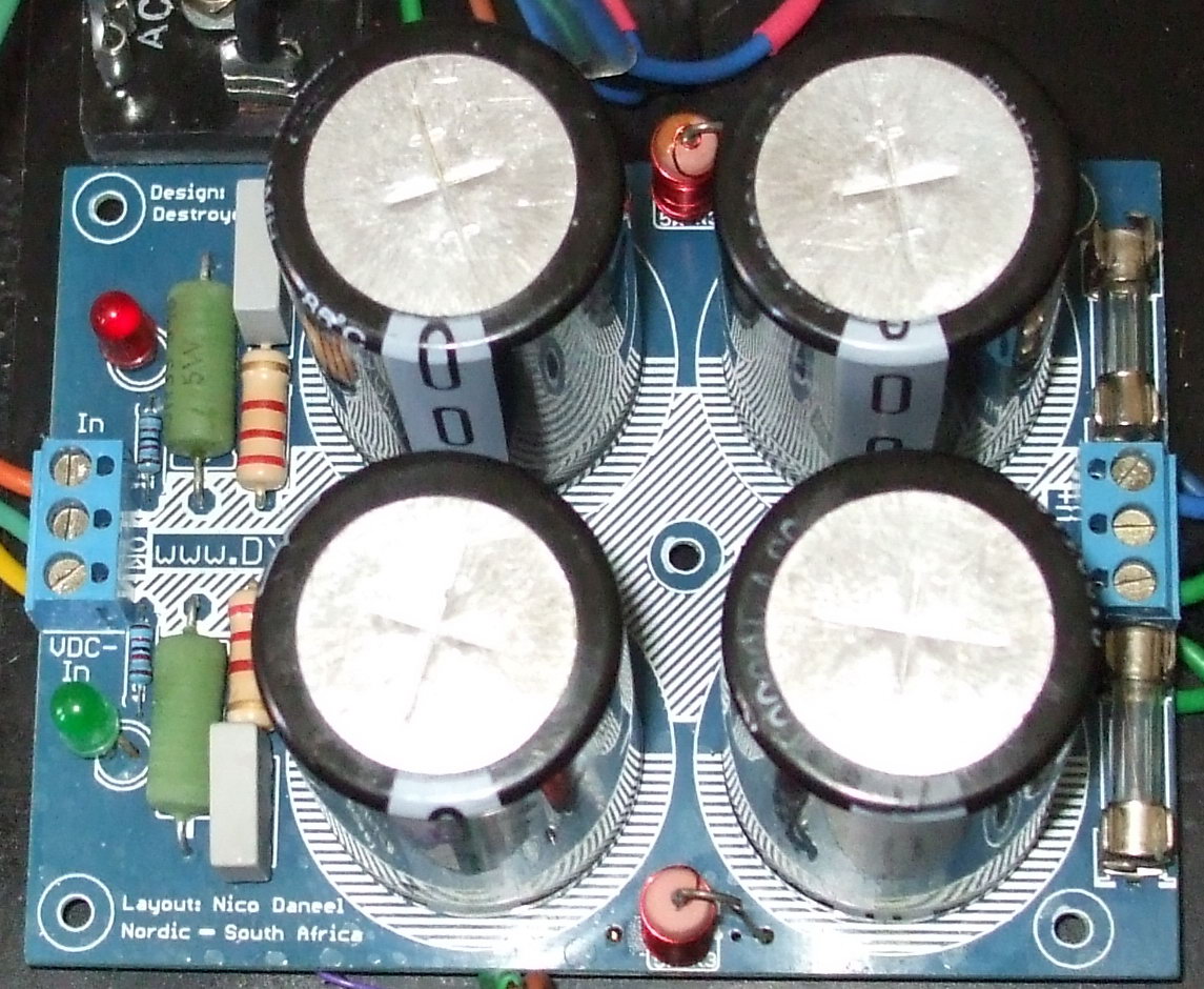

Dx regulator with fuse position fixed.
Transformer primary also has a fuse.
The power amplifier has fuses to protect the power amplifier.
Also the Dx Supply has fuses.... electrolitic condensers can short, then fuses blow... if mains fuse does not open in advance.
Do not forget fuses to the speaker output
Carlos
