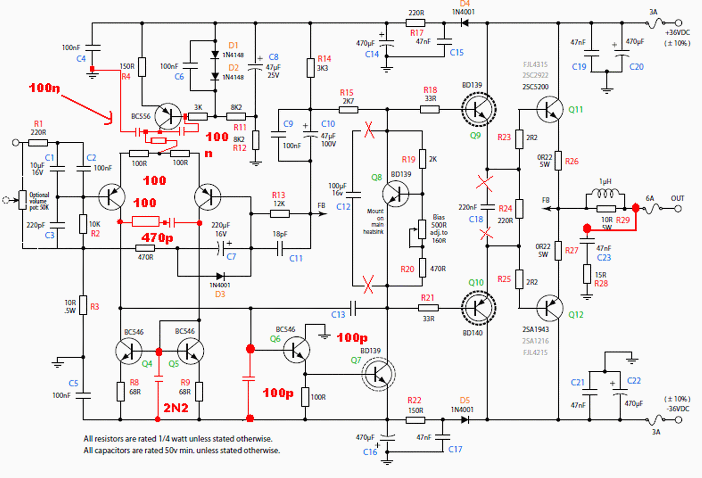

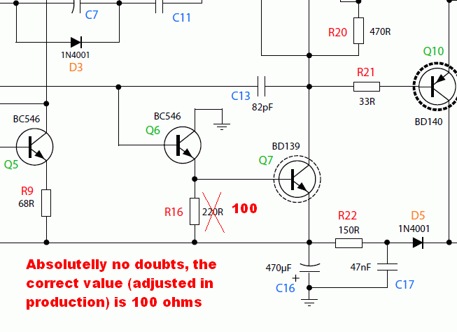

Dear Taj, having free time, please change the first VAS transistor resistance
This second amplifier confirmed to me this need.
We have Renato already producing your board...soon it will be tested.

Please, if you intend to build, wait for us, we are testing the board
and we have found a small mistake to be fixed...wait my okay, because my local friends are building to test.

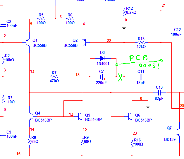

We have discovered a mistake on the PCB. I will correct it later today.
On the PCB, if you have already etched it, you can cut a trace and add a short jumper to fix it. I will illustrate that later today as well. Otherwise wait for the PCB layout to be fixed.
..Todd
Maybe will not be needed, Sergio Vaz have experience the troubles i had with this
amplifier, same troubles, overheating and bias control non operative after some minutes playing, even with small stand by current, it may be oscilating, triggered by the audio signal entering, you know, the amplifier is in the threshold of oscilation, excessive gain i think.
I have sent him these ideas to try (attached schematic), we gonna see in the next exciting chapter, if will work stable or not, i have two operating, but after a lot of hard work to stabilize the unit, after several parts damaged during the work to stabilize....will see if will work, otherwise the amplifier will be buried into the Blamecrash family graveyard.
regards,
Carlos
