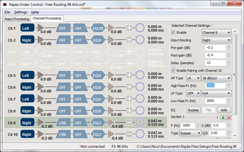

In my first Najda testing I use it as 2 channel PEQ.
I find in IIR mode Channel Processing PEQ limit 10 is too few for my system. How to get more PEQ on one Najda Channel Processing? I know on Input Processing is also 10 PEQ possible but for Input Graph is not possible to load frequency responses and see summed result as is possible for Channel Processing on Output Graph. As input processing is not seen on Output Graph, then I not see how Input Processing PEQ influence on summed frequency response.

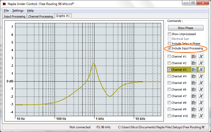

From this problem I see one additional function what NUC needs: It is good to have on Output Graph settings what will enable to see Input processing + Channel Processing results on Output Graph or maybe better even if additional Total Processing Graph will be added.

Do you mean something like this?

Yes. When it will be available? In NUC 1.0.0 I not had this.
Strange that nobody early had find this function is missing.

It's part of the next release, and it has actually been requested.

I might also increase the number of biquads per channel at some point (maybe 15).
Nick,
Concerning the biquads, is it possible to add the Custom biquads function to the crossover section increasing the biquads in the EQ section migth work too... But I think that separating them would lead to a better way of controlling the resources.
