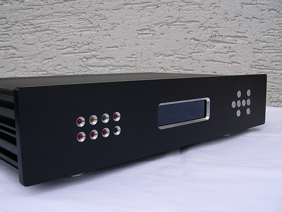

Hi Nick
I tried this IR-Receiver: OS-OPTO OS-0038N > Datasheet
Because it is so easy to install as an LED. It's the last one in the row of LEDs. But it does not work.
Any chance to make it work?
The Vishay's work. But are much more complicated to install.

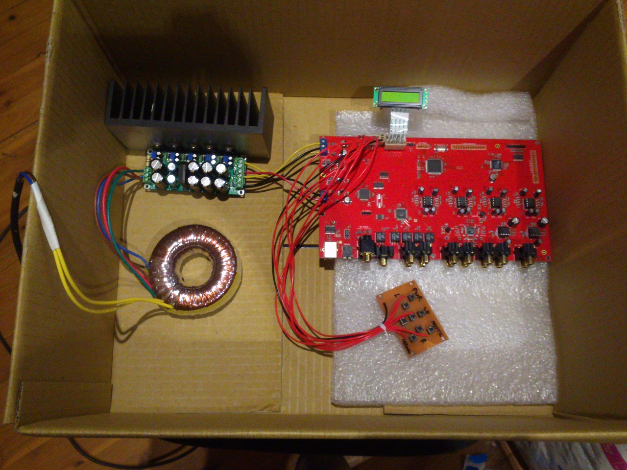

Hey look, i'm quoting myself :) I realised that the 4 channel external volume control could actually be useful in a couple of cases - certainly the HT application of jiri but also in case we need to reduce the level on a 'hot' analog source before passing to the ADC. My phono stage is borderline too loud for the ADC and I'm sure there are other cases when people will need to adjust the level of inputs.
In other news, a photo of my prototype! I'm using a (DIY) linear power supply from JLM Audio and oversized toroidal from Tortech. Both Australian companies and I'd happily recommend this PSU to anyone who wants to run a linear - the JLM (either power station or better kraftwerk) PSU is designed for microphone pre's, so it should be quiet, gives 5 rails (3 +pve, 2-ve) and voltage is set via a trimpots - I'll be using the remaining rails for other random junk that'll appear in the box with my Nadja.
