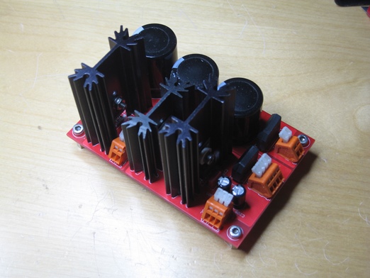

Yep heat is the price we pay for linear. I am putting together a hybrid power supply that will efficiently provide 5v 2.5 amp and dual rail linear at 1.5amp. I am just fine tuning the layout before I get some boards made up if your interested.

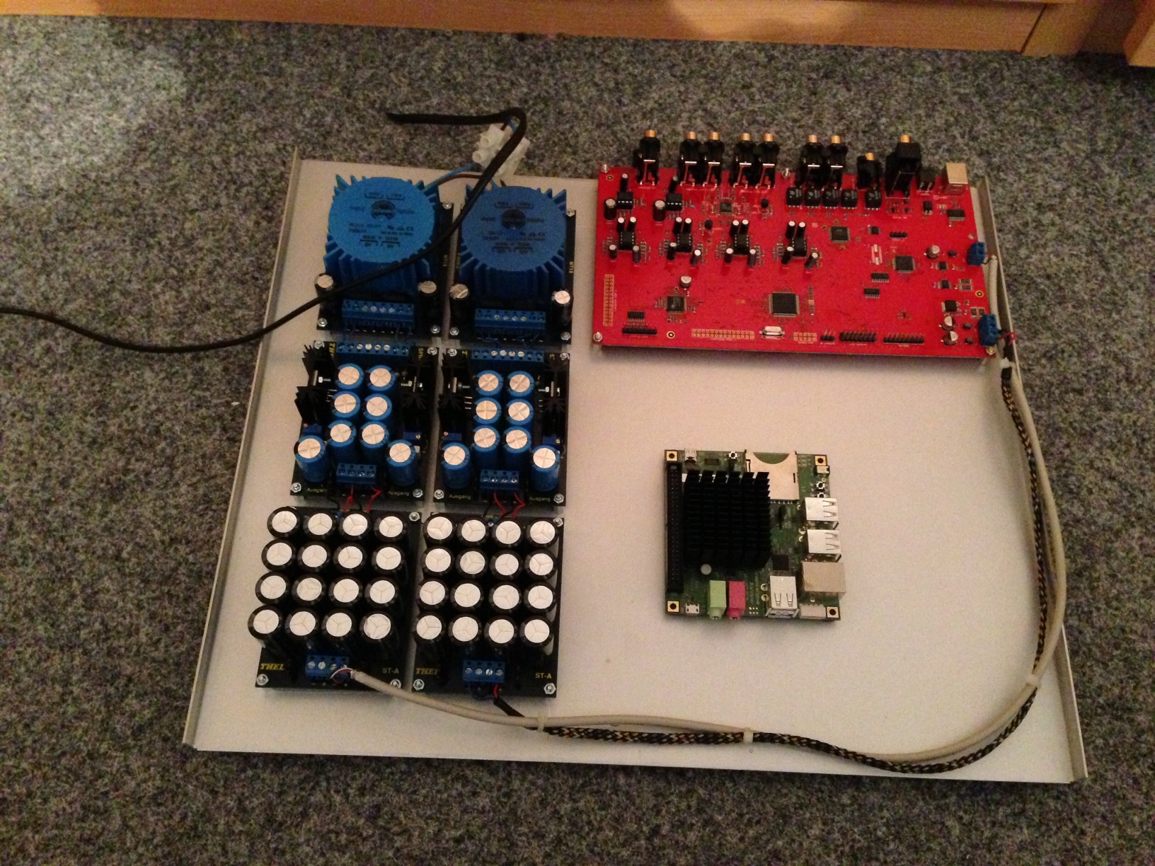

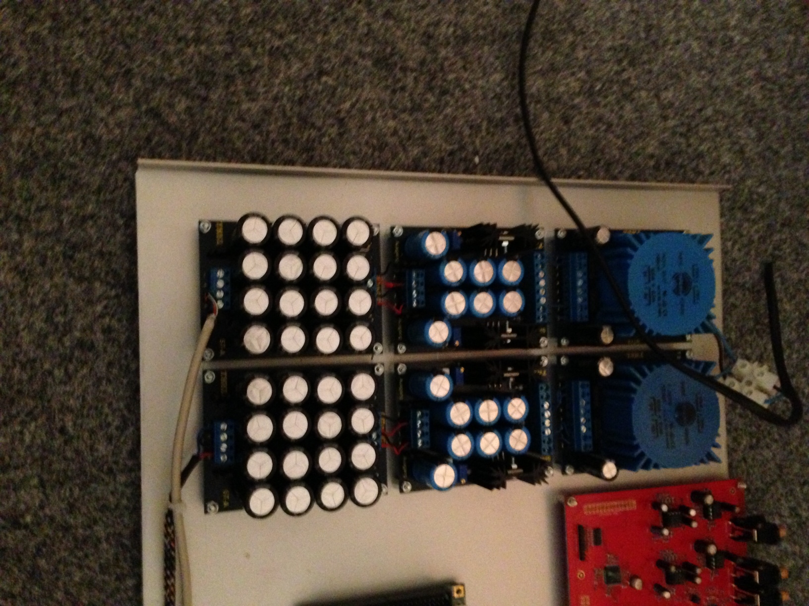

First Bench tests are very promising. As power supply I have choosen two low noise regulated power supplies which will give me -+12V +5V and +9 V for the hardkernel X2 controller. The plan is to have the device controlled headlessly without USB connection to the host.
Ultimatively I would like to develop a couple of web services tp remote control the najda DSP board.
Hi Markus, good to hear from you. That's an impressive power supply you have here! Looking forward to your progress.

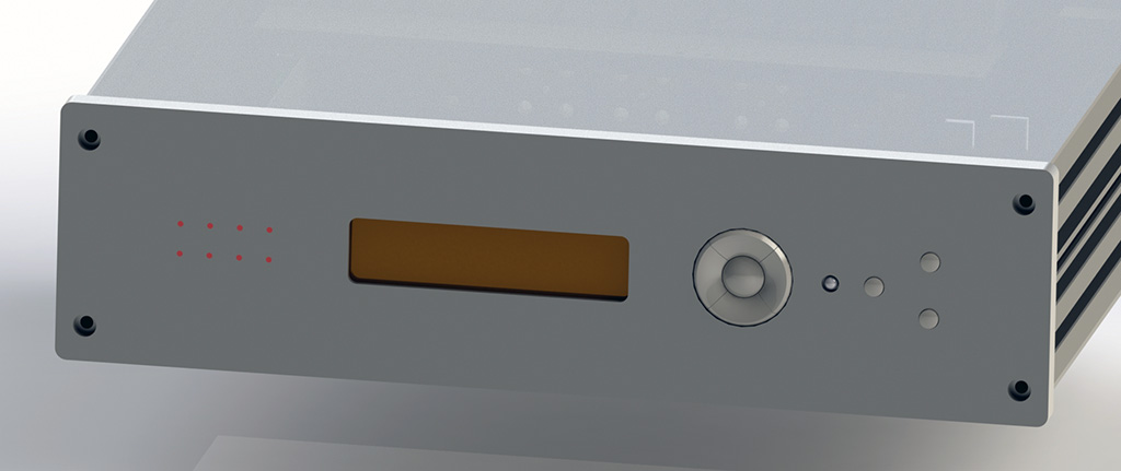

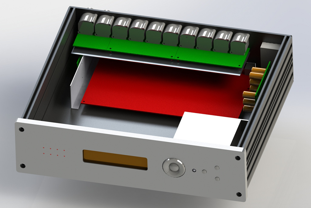

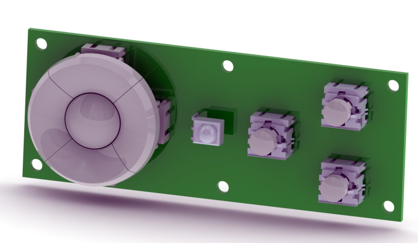

I've made some progress on my Najda build...
I will use MEC navkit and 5G serie switch along with the Vishay IR receiver for the navigation panel
I will use two rows of 4 leds (2 mm flat top) :
one row of four red led for all clipping indication
one row for general indication with yellow and green leds. For the time being only two are for Najda
A meanwell net35C will give me +/-15V & 5.5V and a LDO regulator board (right hand side) will bring those to +/-12V and 5V.
An Amanero USB-I2S will be mounted verticall on a shiel that could accept an optional isolator board also.
Still some space left for future use...
Now I have to make it real !

Hi Jean-Claude, that's gorgeous! Have you selected a display already?

hello jean
what package do you use to do your 3-D modelling ?
do you use sketch-up ?
regards
trev
Nick
Yes, after some thinking, I will keep the Artronic Big Black Double Negative ABC016002C41-DLW-R
Jean-Claude
hello jean
regards
trev
Hi Trev,
I'm lucky enough to have access to a workstation with Solidworks installed !
Best regards
JC
