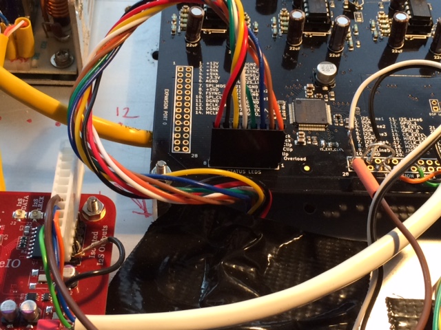

Najda does not recognize WaveIO i2S
I have put together Najda to test it together with the WaveIO and made the necessary connections as described in the building manuals.
Than it was time to start up and test. I ofcourse connected fromWaveIO to exp. board 1 of Najda:
V+ to pin 28 (5Volt)
DT to pin 1 (i2S line1)
LR to pin 25 i2S_FSR
BC to pin 23 i2S_CKR
Isolated GNDs to pin 2 DGND
I connected Najda's pin 10 to 13 (DGND to IS_EXT1\ for letting Najda know there's an external i2S source on this port.

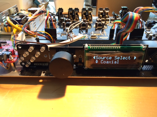

However: I am still not able to select the i2S source in the Menu. Only analogue, coaxial and optical are options.
I think there's nothing wrong with the WaveIO, because it is recognized by my computer. It plays music I think, because the LED's of Host Active, Audio Streaming and Sampling Rates function properly when I stream music.
In a way Najda won't see the WaveIO board.
Do you have suggestions what the cause could be of the problem?
Greetings Peter

Please check if you really connected pin 10-13 with a bridge!!Hi,

Start NUC again and you should be able to to select the I2s connection. Did you give the I2s connection a Name?

Yes I tried but upon restart of NUC it was reset to default. I believe ext 1

Yep I bridged pin 10 and 13 and soldered it on the top. Are pins soldered thru hole or should I solder backplane also?

I just soldered the 2 Pins with a short copper wire. Are you shure that you are identifying pin 10 and 13 correctly? I never had a problem to select I2s after bridge implementation. A control if backplane is connected can't harm
Indeed, there's a common issue with pin numbering for 2-row headers.
Numbering on the upper row is 1, 3, 5, 7 etc right to left.
For the lower row (the one near the PCB edge), that's 2, 4, 6, 8...
That should help
Identifying pin numbers
It sure helps!! I was not aware of that rule. Glad I learned something.

To be correct, it's not a rule; rather a pin numbering style specific to the type of connector (header). Other connectors may or may not have the same numbering order.
