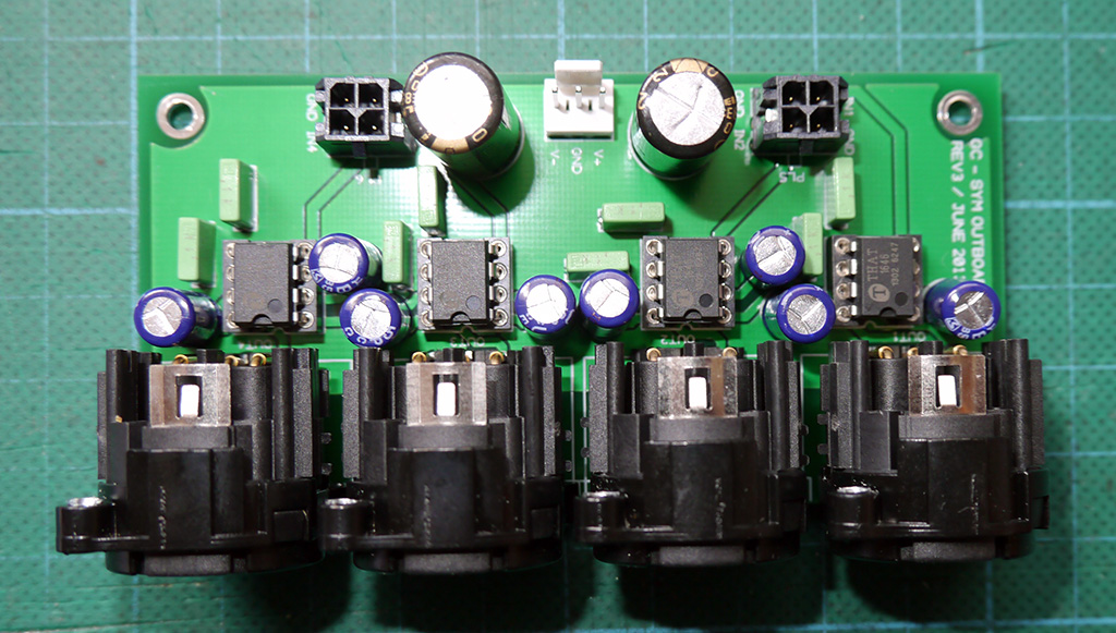

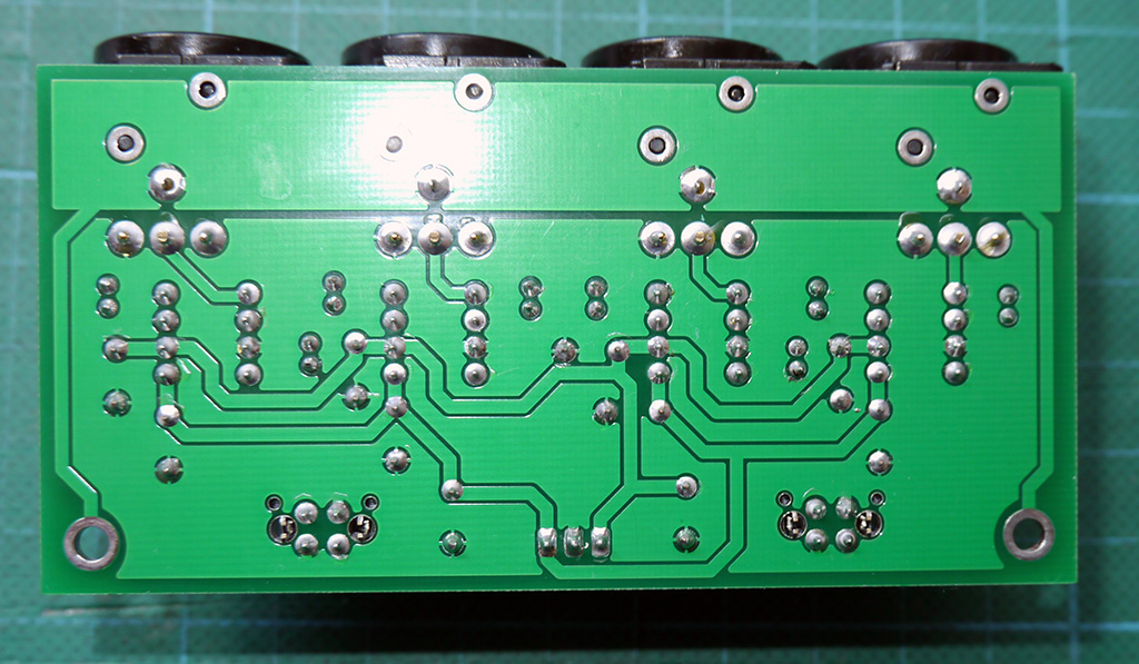

Anyone considered this for single ended to balanced conversion of Najda output?
Are there other good alternatives?
ghentaudio --- RTX (unbalnced RCA to balanced XLR) Module
I did my own iteration a while ago already with the That 1446 and it is working great

3) JC do you have some boards left for the conversion to balanced? Or are you making another charge. I would be interested! ;-)

MP sent
JC
