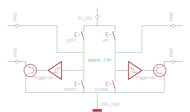

As for the rotary encoder and menu buttons, I found a possibly nice all-in one solution (as I want to keep the front panel very clean and minimal):
http://www.grayhill.com/assets/1/7/Opt_Encoder_60A.pdf
It has a rotary encoder, 4 direction switches and pushbutton integrated.
However, the X-Y-axis has only two outputs that are pulled to 5V (for UP and RIGHT respectively) or GND (for DOWN and LEFT). While the second is as intended for your board and should work, the 5V output would have to be converted to pull GND to the appropriate pins instead.
But meanwhile the other direction would see 5Vdc.
Would something like the attached schematic work with the keypad input on your board (excuse my sloppy Eagle skills)?
What happens if 2.5V or even 5V (the same digital supply from your board) gets supplied to the pins? Will that fry something?

The keypad port consists in 9 pins, 1 is GND and the 8 remaining are the inputs for the 8 switches.
These 8 lines are normally pulled up to 5V with a weak pull-up resistor, internal to the micro-controller.
When you press a button, you actually pull the level on the corresponding line down to GND: the button short-circuits the line with GND.
What the micro detects is a Hi-to-Low transition.
The inputs are high impedance and won't be damaged if you set the level anywhere between GND and 5V.

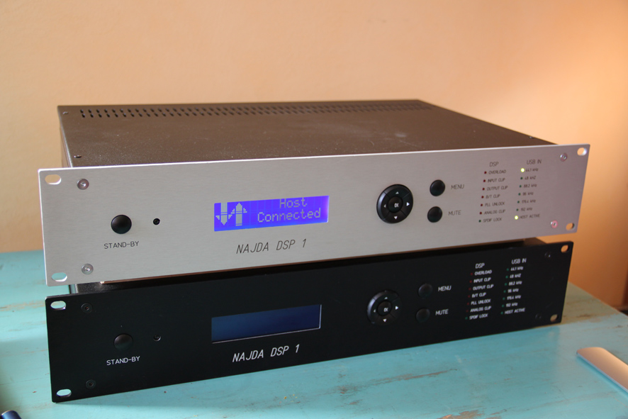

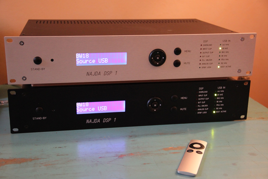

I've received pictures of a pair of very nice builds from a French user (Pascal, not sure if he's a member here):
