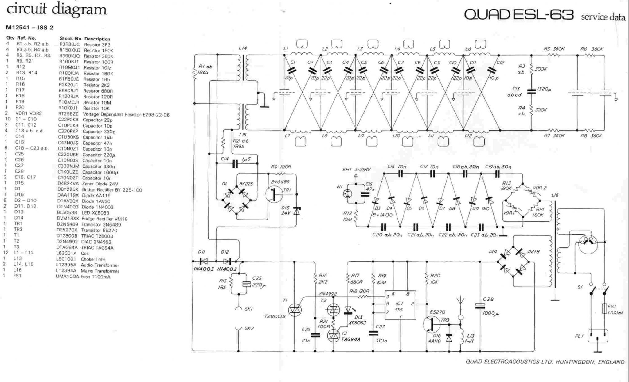

OK, That's good to know. To be sure I get it, I assume the extra panels are in parallel with the rightmost panel shown in the attached, which are the 8th panels in a '63 if I am correct.
I am going to pick up a derelict pair of Gradient subs which I will rebuild. Curious how that improves the '63 and/or betters the '989.
BTW I find the '989s gorgeous in a majestic way. I have 'm covered with a soft white sock. :cool:

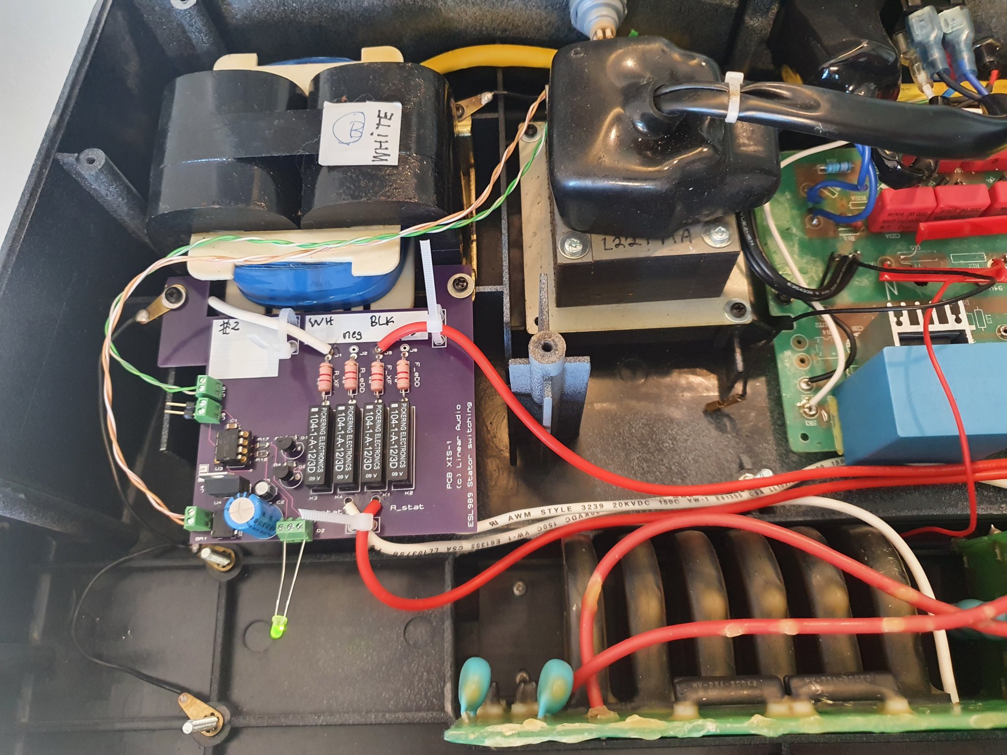

Made some progress today. Finalized the little HV switch PCB, tested it and mounted it in one of the ESL 989's.
This will allow switching the stator drive between the step-up transformer output, driven by a conventional amp, and the output of my direct-drive amp.
The cabling between the DD-amp and the speaker has a control line to the little controller on this PCB, so the amp can control which output is playing (and a few other things), and that in turn is IR-remore controlled.
That should give an interesting comparison opportunity.
The main HV amplifier boards are nearing completion as well.

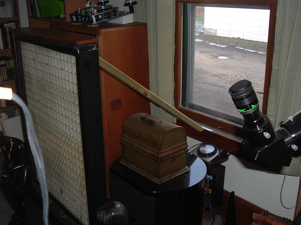

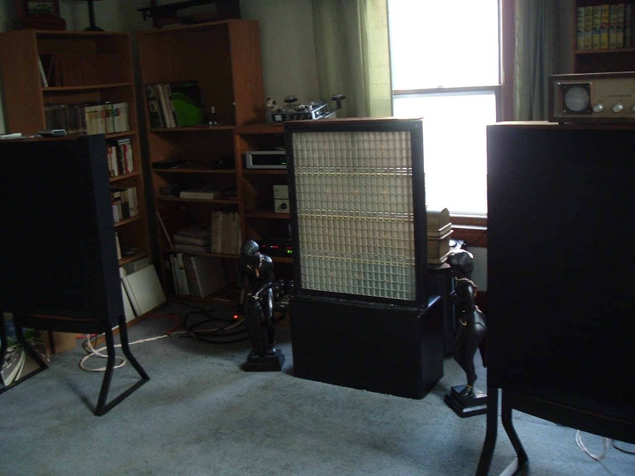

Back maybe 15 years ago I was in my "full Quad63" mode - nothing better to do than rebuild panels and experiment.
Decided to build up my own '63 subwoofer so acquired all the necessary parts for a 63 panel but had a friend build up a base that would enclose the the electronics - placed the panel assembly about as high up as the Arcici stands did for the side panels. Drove 4 full-range panels in parallel. Built up a L/R channel combiner which fed a plate amplifier and included a 3-pole LP filter set for around 100hz. Panels blended well and enjoyed the system for many years, till humidity took the rebuilt panels down and I gave up on them. Placed the center channel maybe 18" back from the sides and added a top reinforcing support. Also had the 989's for a while but they overloaded the room too easily.
Charles
