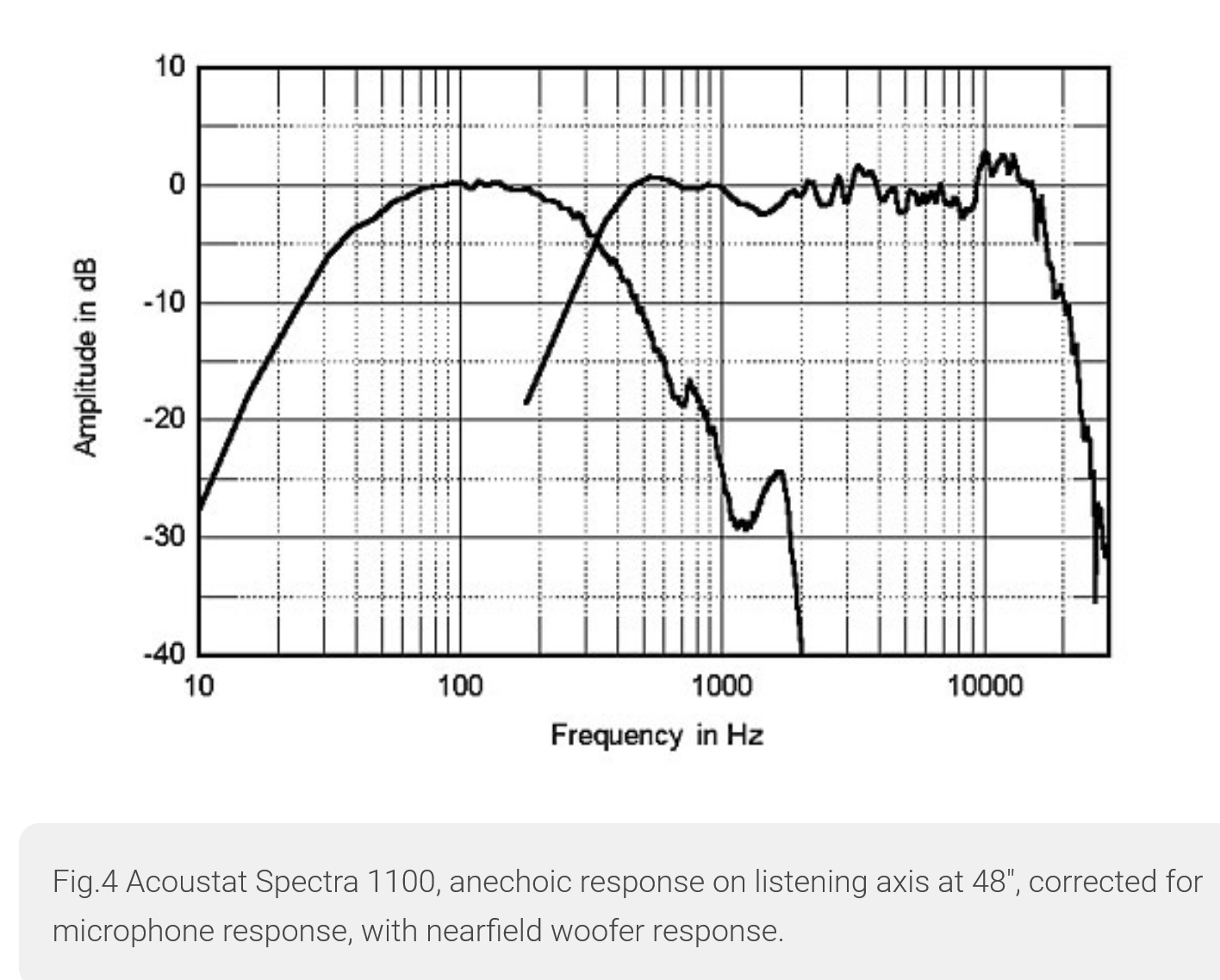

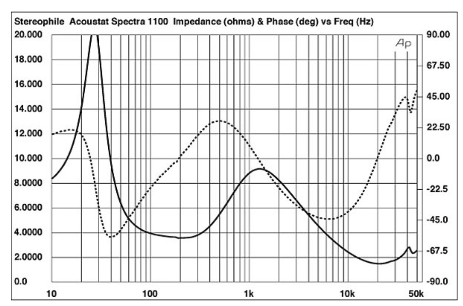

target load for ... DD amp.
I wonder how Acoustat panels would respond to DD amp drive if they are unsegmented and driven full range? There dont seem to be any impedance plots of raw Acoustat panels - can that actually be done?
Published impedance curves from Acoustat includes the transformer while the Stereophile has transformer and a woofer crossing over at 300Hz:
It should be possible to do freq response and impedance measurements on the panels, as long as you take care of safety.
What I did with the Quads was to measure level vs. freq at the xformer secondary, which is the panel voltage vs. freq.
I also used a small resistor in series with the panel and measured the voltage vs. freq across it, which gives me the current vs. freq.
Then V/I of course gives me impedance vs. freq. The phase angle will give you an idea of how 'capacitive' it is.
Of course you can also measure the pure capacitance part directly.
