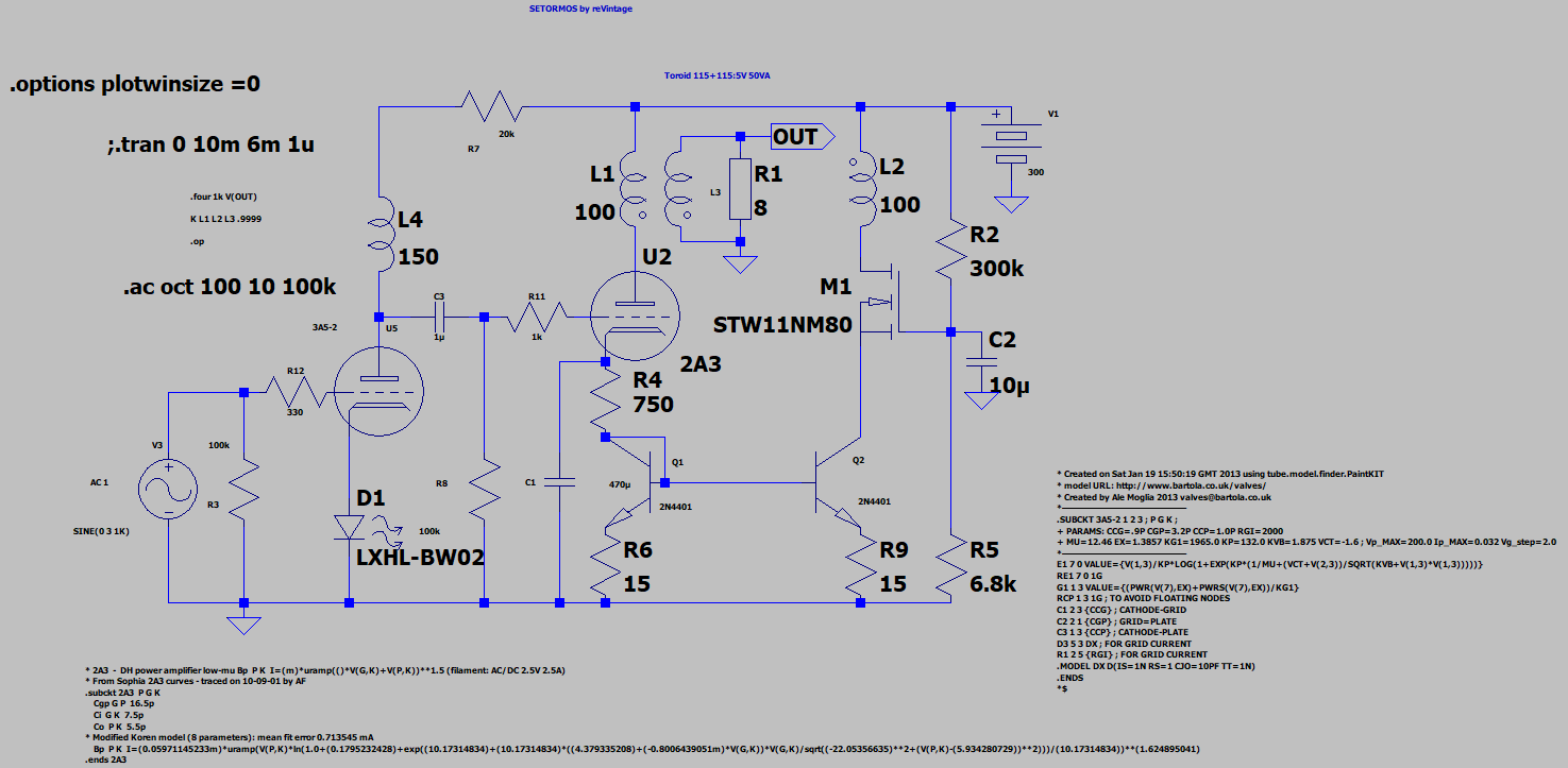

Hi Jaap, yes, you could certainly try it, though whether you need it very much will depend on the type of output valve.
But with all closed-loop systems, please take care to see that frequency compensation is correctly applied.
I imagine that you are using a high-performance, wide-bandwidth transformer - it will be needed!
Place the compensation cap in parallel with the output resistor. Take care that ferrite-beads are present on all the susceptible nodes (anode, PNP base & collector), and that they are lower-frequency types - losses in the 500kHz-10MHz range are needed for these.
screen the feedback wire, and keep all of the circuit small.

So this is what is arousing your curiosity.......?
Driving a 300b is one of the basic challenges in SE amp theory and practice, and has been for many years!

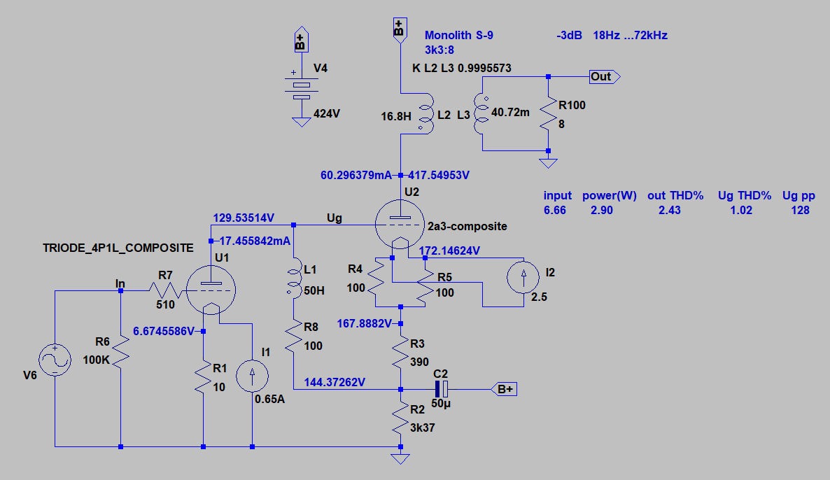

Indeed. Well, I've been experimenting with different drivers as you know. Not needed for a 4P1L stage, but if you look at 300B, 814, 813, GM-70 and other transmitting valves, is key to get it right.

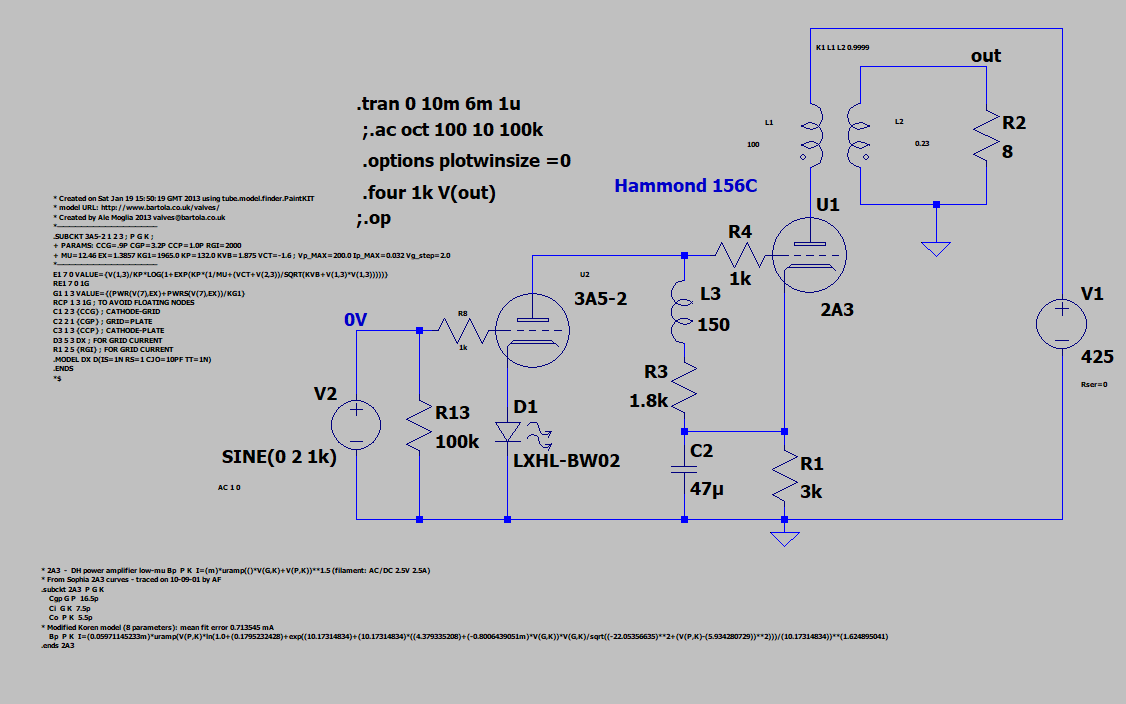

After ten years absense while doing other fun activities not involving electronics, I stumbled upon this thread and had to give it a go. This concept seems to work OK in the simmed world with parallelled 3A5 as driver, Had to spend half an evening brushing up LTSpice commandos.

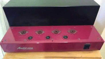

Just a small try to see if I still had some knowledge left. Went through the neglected electronic workshop, to sort out things as we a have bought a new house and found this stereo 6B4G PP chassis with wired cathode circuits and a handfull of 3A5´s, but without drivers. Next sim will be a PP version.

Thanks pl802!
Hadn´t given safety a thought.
Can absolutely be built, but I would go for 6B4G with its lower heater current. Probaly needs some tweaking.
Senstivity is on the low side with just over 2V for 2W out.
Anyway, I pulled the 3A5 and got 105mA, 101V, 10,3W over the output tube, so it should cope. Also shorted the driver anode to ground and got 36mA, 350V, 12,5W.
