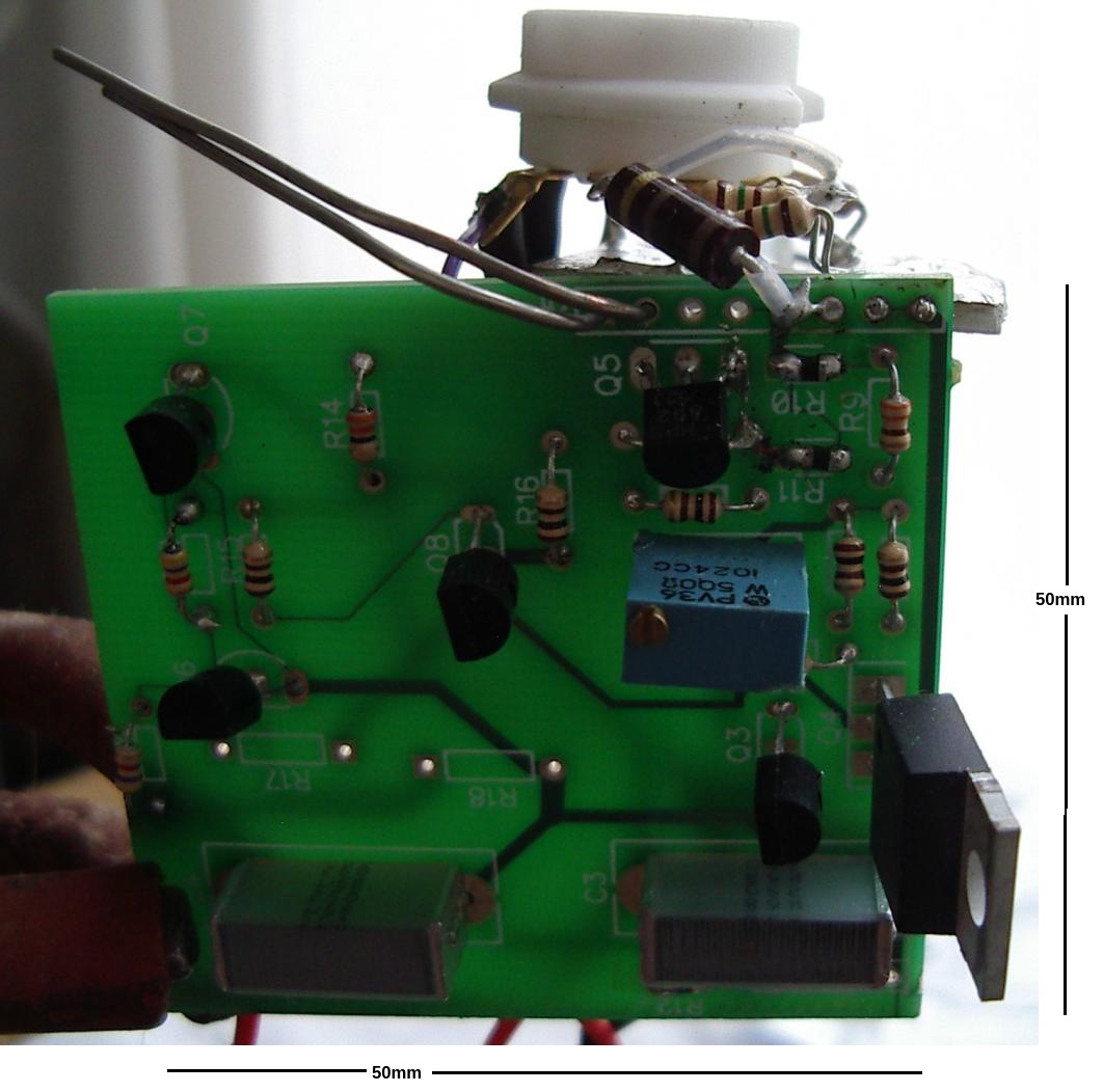

Here's a practical implementation.
This 50mm x 50mm board does not hole the shunt regulation, but it will in the next spin.
Shunt regulation seems well worth the trouble for a few extra parts.
