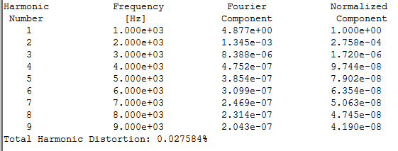

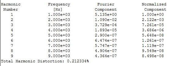

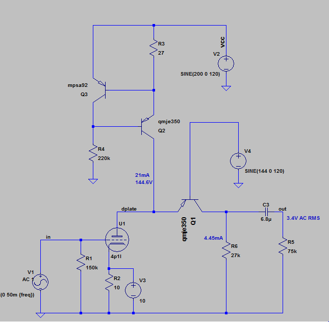

I'm trying to make sense of this. Granted, this is only simulation and the tube is 4P1L, but will repeat the sims with the 3A5.

Ikonflexer,
the difference in current source schematics between two circuits can be responsible for the difference in harmonic spectra. Try to use the same current source in both cases. One can take MOSFET version and for Shunt Cascode circuit just disconnect the left end of R8 from divider R6-R7 and connect it to the plate of U1. (So R8 will be in parallel with C1, C2). This will fix DC levels.

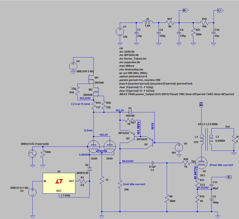

Rod, what is the trick to select right operating points for both 3a5 and MPSA92? I tried lots of combination, and got the following in the sims. Everything looks amazingly good, 0.63V input at 3a5 which 2A3 output 2.1W w/1% THD.
Now if you could please tell me how to make a good stabilized voltage source for MPSA92, then it will be super prefect!:):D

Choose about 20% to 40% of the value of anode idle current in the output resistor.
The higher the ratio, the more stable it will be, but the gain will drop.
You can divide the 150V with resistors (and cap!), and buffer with another MPSA92 follower, to produce the cascode voltage. but for best results, a shunt regulator can be used.
BTW, I produced PCBs for the shunt cascode, including driver heater regulation, and shunt regulation for the incoming voltage, and the cascode voltage. I just haven't had time to characterise them, and support them yet. too much industrial work!
3A5 12R cathode resistor with 2.76 Vk would require 227mA cathode current.
Something looks wrong with that sim.
Rk should be 336.6R for the indicated 8.2mA anode current.
The circuit makes use of a fixed bias method, which called filament bias. 3A5's filament current is provided by the LT1085 current source. Current provided= (1.25V/5.6ohm) = app. 223mA, at the same time this current generates 2.76V over the unbypassed 12R cathode resistor. And this bias voltage will in turn draw 8.2mA anode current.

The circuit makes use of a fixed bias method, which called filament bias. 3A5's filament current is provided by the LT1085 current source. Current provided= (1.25V/5.6ohm) = app. 223mA, at the same time (the filament current + anode current) generates 2.76V over the unbypassed 12R cathode resistor. And this bias voltage will eventually draw 8.2mA anode current.
Correction:eek:
