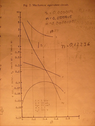

The optimal open area is, according to a white paper from researchers at Panasonic, 42%.
However, the graph in the paper shows that anything between 30 to 60% will do.
This is for a theoretical transducer without insulating stator coatings and it is the lower Velocity curve you shall look at. The X-axis represents the open area, Beta. The speaker in this case has an electret membrane, but the physics are the same, I think.
