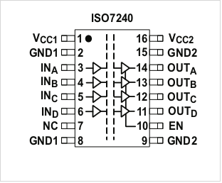

iso7240mdw pin out
The attached is the pin out assignment for the isolator
I have a few questions :
Vcc1 and GND 1 correspond to power supply input between 3.3 v to 5 v dc ?
VCC2 and GND 2 also need dc power between 3.3 v to 5 V ?
INa in correspond to OUT a?
INa , IN b, IN c and IN d pin corresponds to input i2s signals of MCLK, FSCLK, CLK AND DATA ?
thanks and apologies for simple questions
