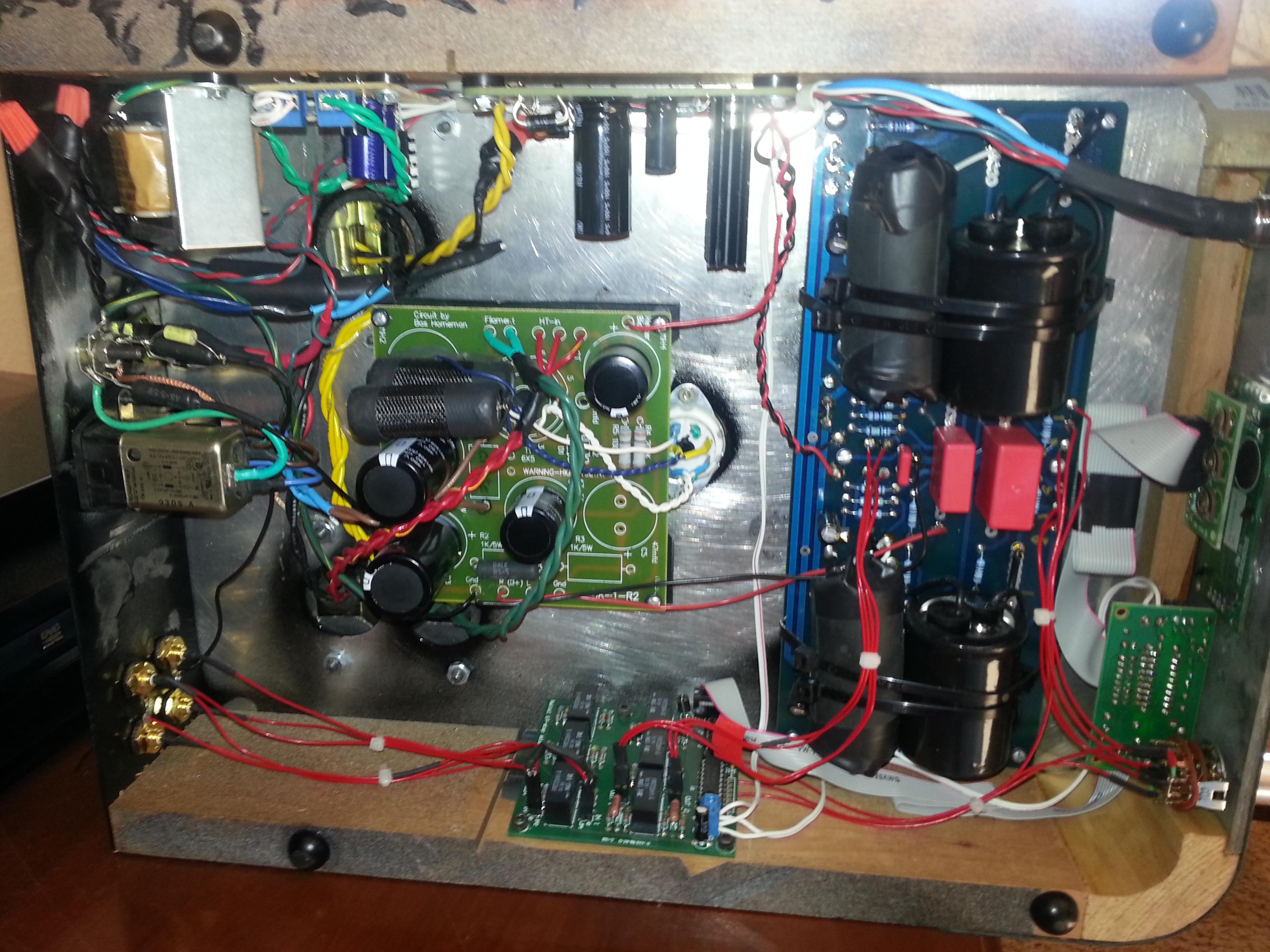

I'm using the same 12V TX as in my 6SN7 preamp, it has 2 TXs and zero hum. Proper grounding techniques helps. OS, you are the master at this, I've read some of the long thread on CSA vs. VSA. Mostly way over my head, but I'm learning. Thank you.

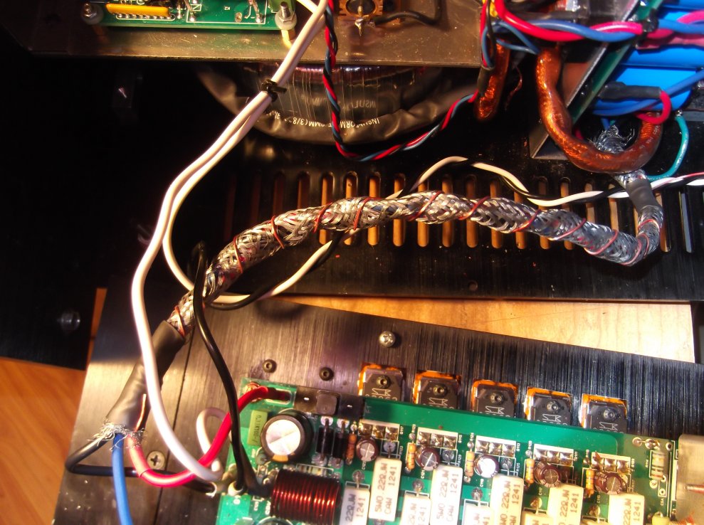

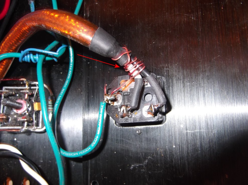

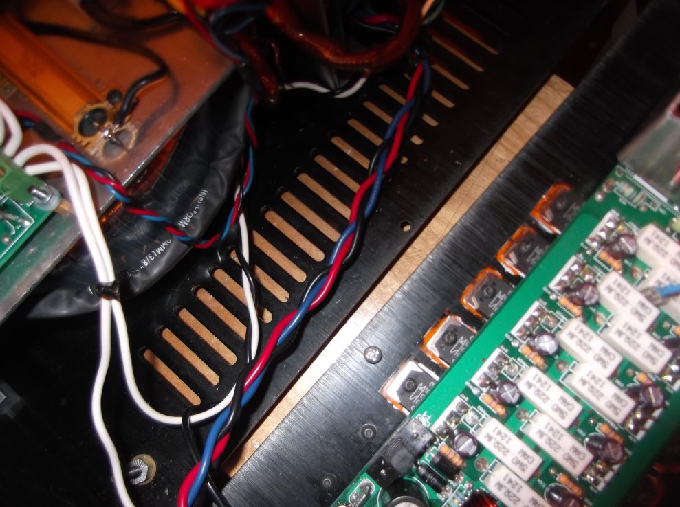

I'm running everything to a common isolated star point , which I have going to a 35A
ground loop breaker. Short of the breaker , the isolated star would of gone to a solid
chassis ground (along with the inlet earth.)
The loop breaker works better and you can parallel a 10R-1W +.01u across it ...
to eliminate RF from the isolated ground.
Rod Elliot (ESP audio) has the article - Earthing (Grounding) Your Hi-Fi - Tricks and Techniques .
Required reading - don't build the amp till you read it !!
As a finishing touch ...
- Shield your AC and litz braided triplet rails (shown Below 1/2/3)
- #1 is the litz , #2 is the braided finish - connect the little bare wire to chassis earth.
- #3 is the AC and ESP's loop breaker.
Combined with the ESP article , your HB will have @ -117db hum/noise.
Tested on the wolverine (badger cousin) ....
Better than a 5K$ amp !!! (Pass Labs - Parasound)
Edit - you can obtain the braid from old IDE PC cables or monitor connectors.
OS

no problems with electricity and being safe, I've been wiring houses for 20 years and understand what 120 and 240 can do if your not careful. Wife finally stopped bugging me about wearing a ring. Took 18 years.
I lifted the ground on the tube preamp in the photo above. Zero ground hum.
I read that article a few years ago and it's a good refresher today.
Great tip about the braid from an IDE cable, I love stuff like that.
I'll implement all of your suggestions above.
Thanks,
Ron
