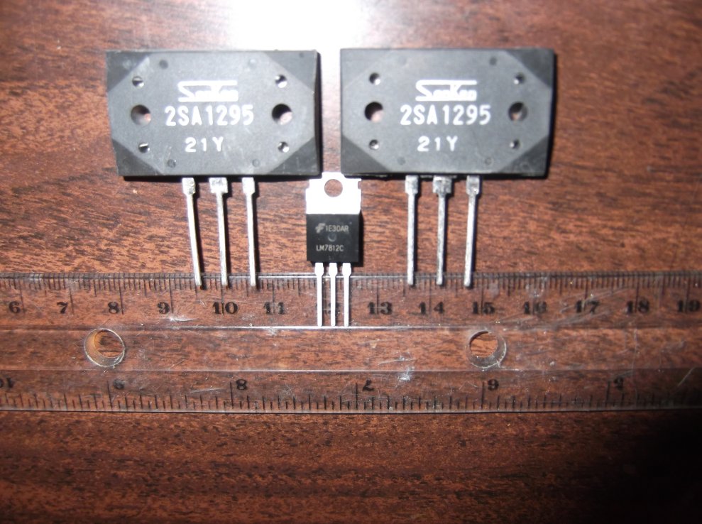

Googling amps' insides, I see a lot of Sanken MT200's. Don't know why, maybe they sound especially good? Or something... My current Rotel AVR has them too (1pr/ch). I was wondering if it could be done with the existing board, or that attaching leads to the output transistors would degrade the quality/reliability of the amp in some way. But, after reading your post, I suppose not.
For driving 4 ohm speakers, would you advise using extra-heavy-duty output devices, or should the standard badger be more than be able to deliver the goods - if you don't plan on pi$$ing off the neighbours? As it stands now, I intend to use +/- 56,5V (+/-40V trafo).
Thanks!
I guess it'd be wise to just build the standard amp first. And if I feel like it, I could try to "upgrade" the outputs... Who knows...
Here is the "lowdown". Since I designed it , (below) is the exact MT-200 - TO-220
arrangement as it would mate with the Badger PCB .
It's just "do-able" - to the mm. Worse case, the to-220's could be out on wires
above the MT-200's. The TO-126 vbe fits perfect with plenty of room
PS- electrically , the sanken's have higher beta / less EF2 current "droop" than
the ON's - higher Ft , as well (faster).
