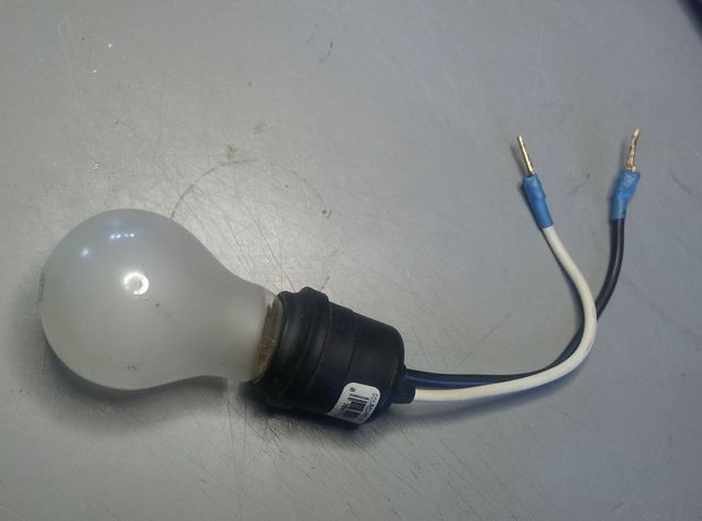

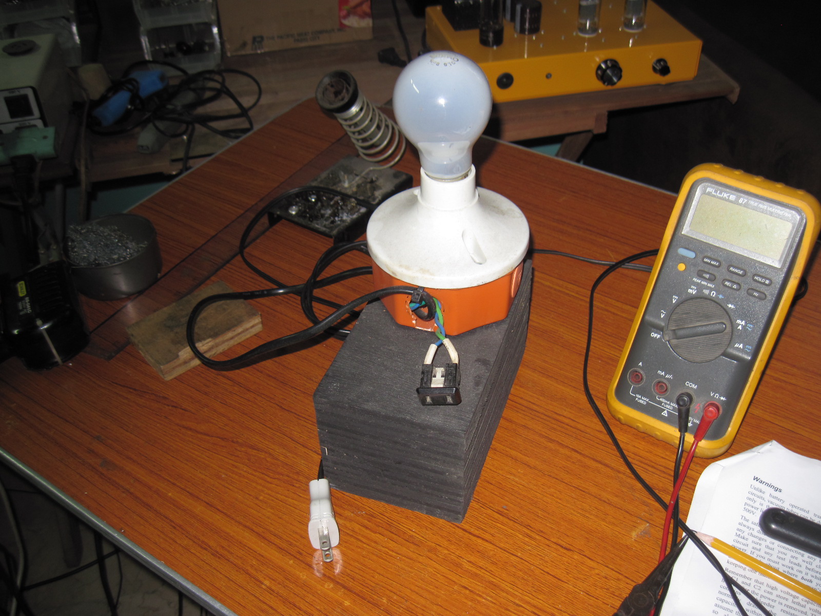

An inexpensive (< $1 US.) outdoor socket serves well for discharging. It's the second most used tool I have - behind only the soldering iron. I'm in the habit of using it even when I don't have to,
That's clever, very useful when building and testing PS without and with amps connected. Saves time.
cheers,

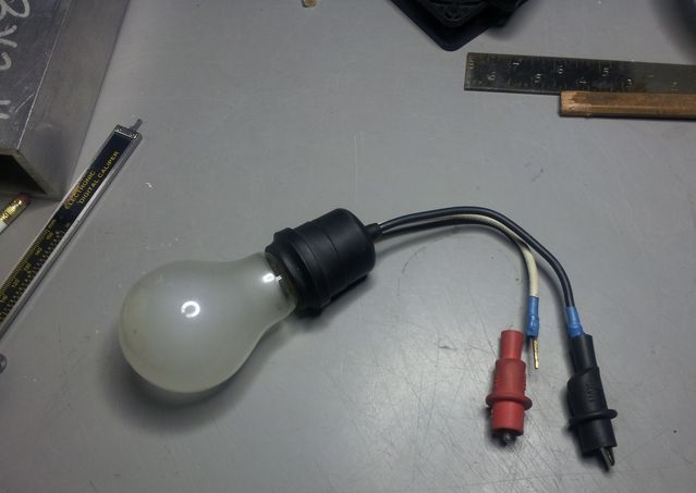

I use something very similar except I have longer leads and shielded alligator clips on the ends so I can clip it on to give it a chance to completely drain the caps if needed. Most times just a touch is enough but for really large caps, sometimes it takes a little longer. It doesn't take high voltage to make a good arc when dealing with large caps.
I use something very similar except I have longer leads and shielded alligator clips on the ends so I can clip it on to give it a chance to completely drain the caps if needed......

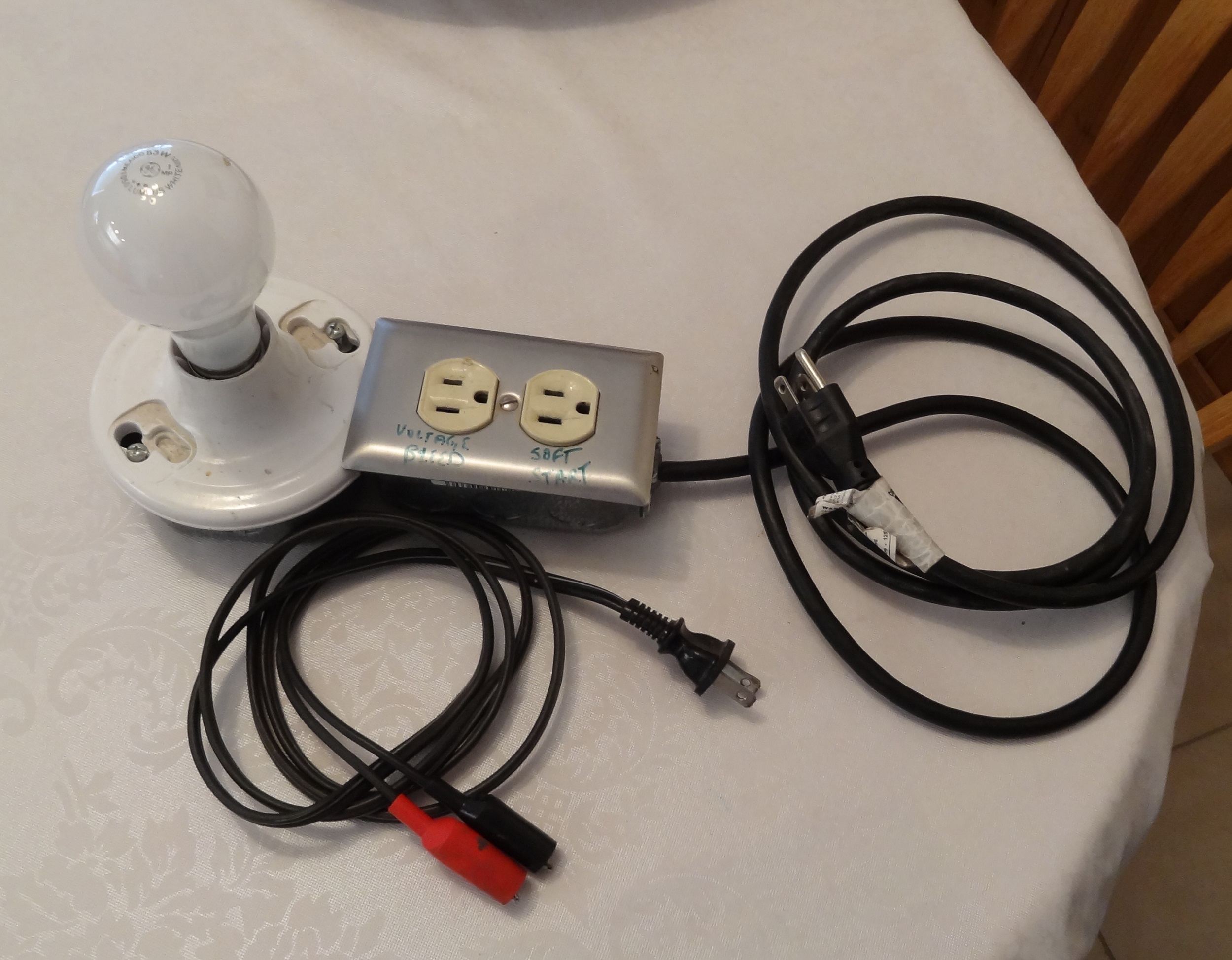

Here is a picture of the one I built. It has two outlets. The one on the right puts the light bulb in series for current limiting during start-ups. The outlet on the left puts the light bulb in parallel for draining caps. I made a few leads like the one in front from old lamp cords. I've also used the parallel setup for testing power supplies. You can adjust the amp draw with different wattage lightbulbs.
Dim bulb?
I built one too just so I could see if the bulb dims when the PS is done charging; it is a great indicator!
