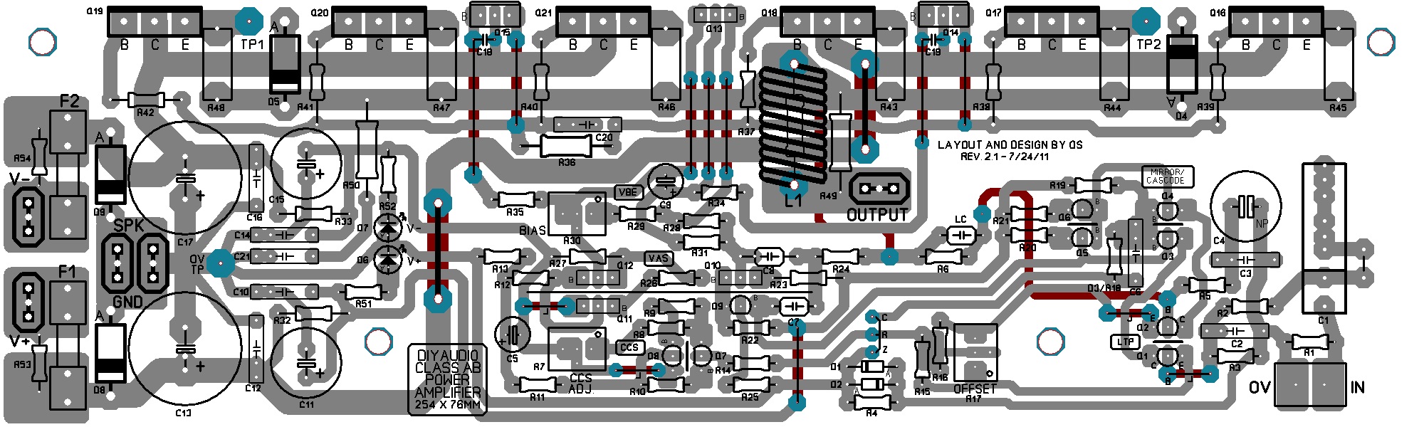

I am considering building a HT Badger, but the pre-amp I'm considering using has balanced XLR line outputs (Marantz AV8802).
Would the input stage as currently designed work with balanced audio input if pin 1 of the XLR input is grounded to the chassis star ground, with XLR 2 and XLR 3 pins applied across R1?
One note about Ostripper's schematic - it looks like R1 is shorted out of the circuit. There is no clear Input+ / Input- on the schematic, only an implied one across R1. I would consider the 'input' on the wire only as a net name.

The + input is above the word input and input - is below. R1 spans across the input. See attached
Pin 1 of the XLR goes to Chassis.
Pin 2 of the XLR goes to +IN of the amp.
Pin 3 of the XLR cannot go to Signal Ground of the amp.
Check how your balanced Source works.
Some will automatically change the Source to suit the loading conditions.
Others will require you to change. You may have to load Pin3 with a resistor to signal ground, or you may be allowed to simply ground Pin3.
How balanced should the output stage be. Q18 and 17 at 38-40mv. Q16 at 22mv. already changed Q16 because it was hogging. Offset at <1mv, bias at 60mv TP1 to TP2. Been powered up 5 hours and stable.
That could just be an emitter resistor that is out of tolerance. If it bothers you, you could try replacing that resistor.

Ok after testing boards seperately for a couple of days just now testing with both running. Problem, one board has higher gain than the other probably 6-8 dB. Hopefully just a resistor misplaced. I did not match any transistors could that be the problem. Offsets look good and biases ok.
