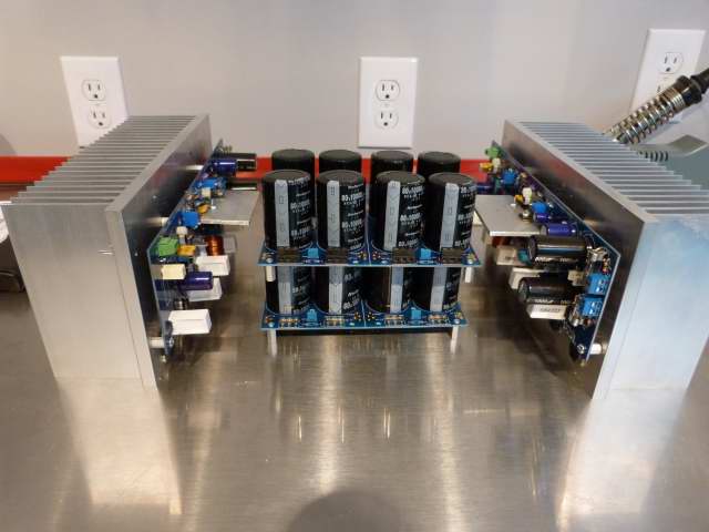

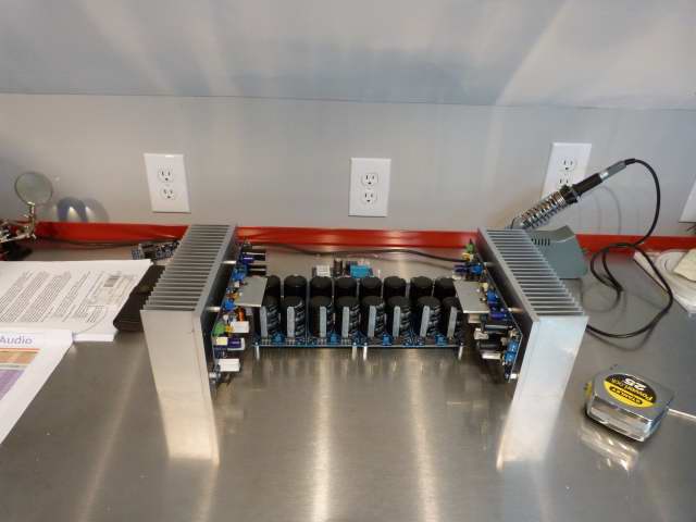

I'm laying out my Honey Badger to build the case while waiting for the transformer to arrive. Quick question, I'm doing a dual power supply build using the new DIY psu boards, they're pretty wide. For the sake of reducng the foot print I was considering stacking the PSUs on top of each other, with the proper spacers of course. Does anyone think this is a bad idea ? Also so far I am going with one soft start, but since I'm using 2 PSUs with a lot of capacitance should I add another so that each PSU has it's own ?
Thanks for your sage advice in advance.

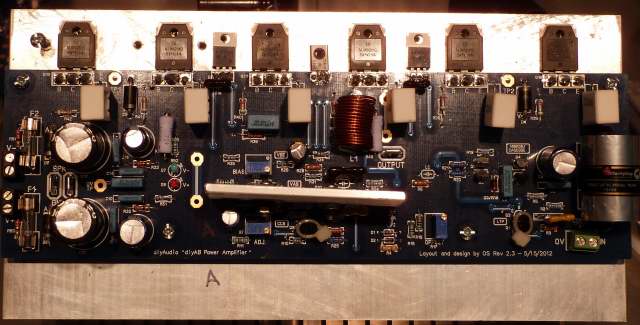

Hi Guys,
I have a question about the build concerning jumpers. In the build guide the only jumper mentioned specifically is the C to Z jumper for the cascode/current mirror section. However in the pictures and on the board there are many spots for jumpers, there's three next to the home made inductor as an example. In the pictures that show the prototype board in the build guide there are wires shown in the jumper spots. So far the only jumper that I've installed is the C to Z jumper for the zener reference. Do I need to install jumper wires in all of the other spots. Below is a pic of the current state of my build for reference.

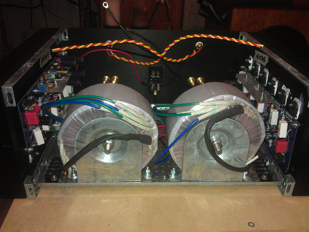

I haven't had much time recently but I did get my transfos mounted and the unused leads tied off. I used mounting brackets from Apex Jr.Home Page.
Does anyone know how to clean off the excess thermal grease that squeezed out? Purely cosmetic, it just looks messy.
Use an oil dampened paper tissue to wipe off the worse excess.
It is the oil in the paste that keeps the air out of the thermal interface. This oil MUST not be washed or dissolved out.
When you get around to cleaning the heatsink of staining and decide to use a solvent dampened paper tissue, DO NOT let any solvent wick under the device or it's mica washer.
