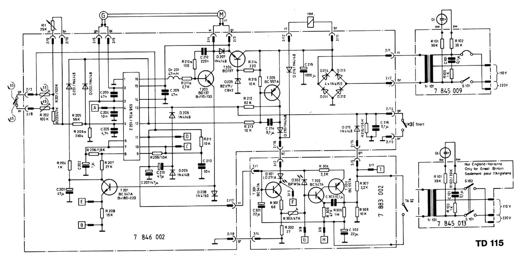

when we can find a PCB with a stable frequency generator with stereo output and phase control it is the central brick for a turntable power supply. To find a amplifier as motor driver is no problem. I think this can be done by any mid-hifi class-d amp.

There are some solutiones for a supply with microelectronics. But i think it can be make much simpler. A Wien-Bridge gives out a pure sinus and is stable. Frequency variation is simple and the second phase we need is also there. The supply from Thorens based on the Wien-Bridge-Generator.

I'm not shure, but i think we need a phase angle between the two channels from round about 90degrees to drive the synchronus Motor accuratly. I'm wrong?
It's exactly that.

in the linked magazine there is a basic circuit but without regulation for the Phase shift. Look at page 30 http://www.basaudio.net/pubs/DIY_2006_1.pdf
