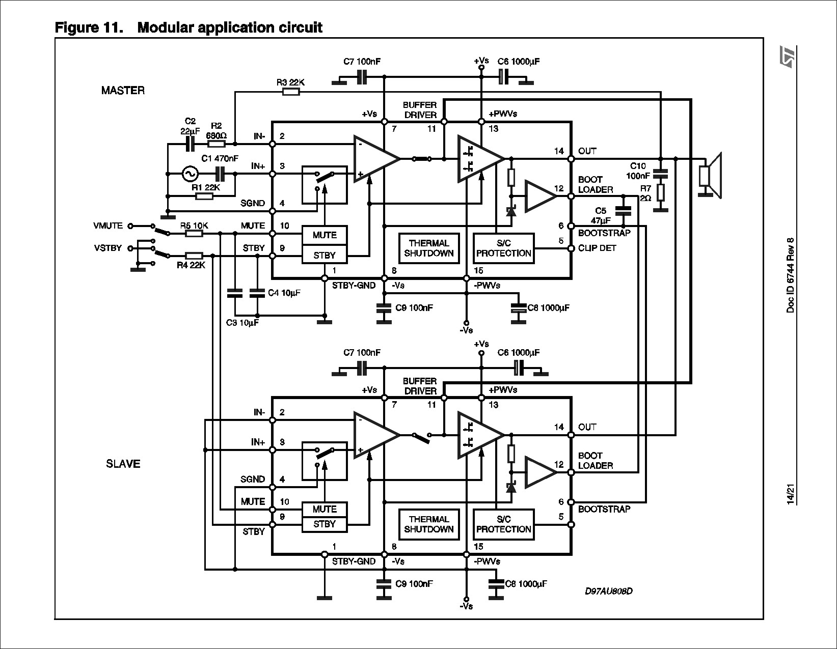

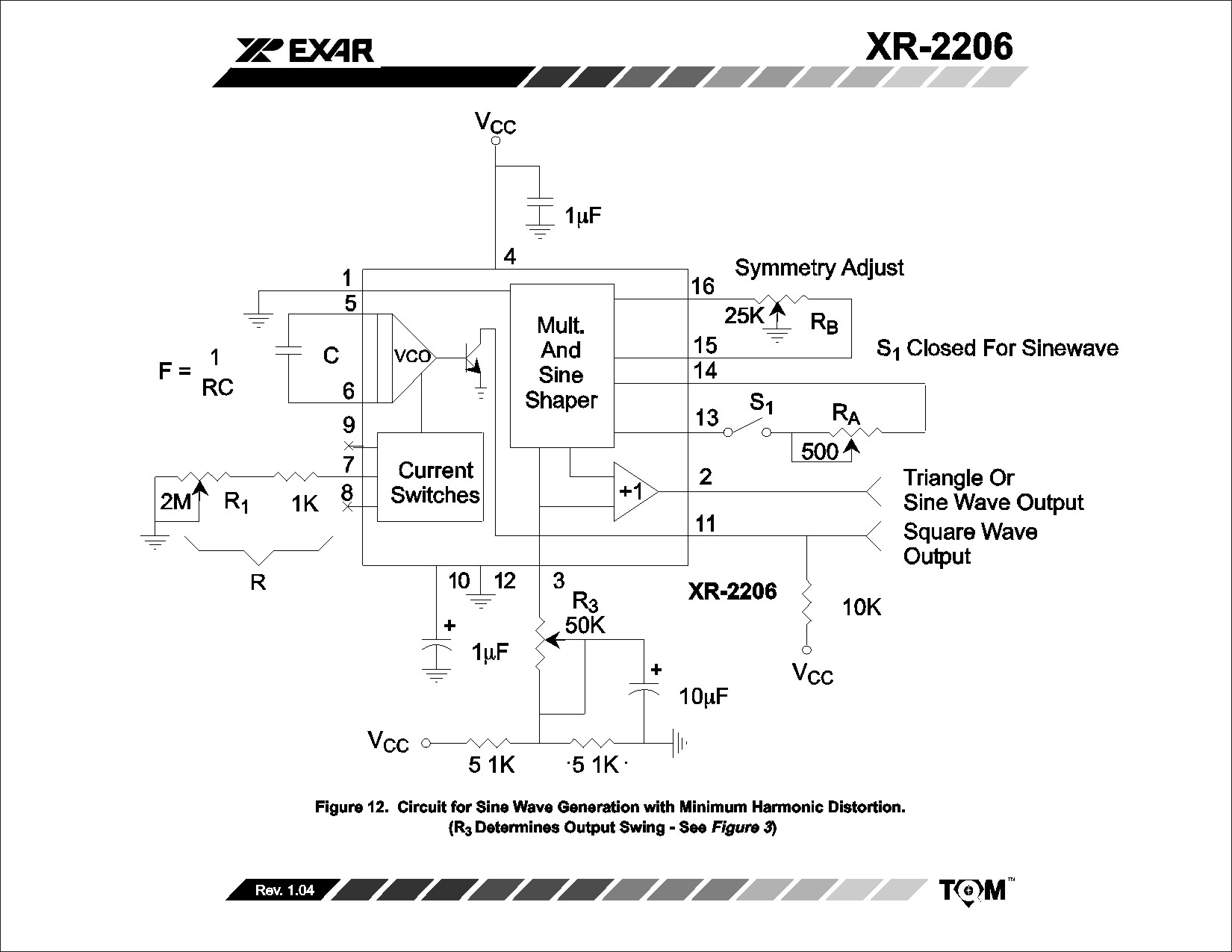

Actually, the controller on LH appears to be an STMicro design. Attached is page 14 of the TDA7293 data sheet. It is pin for pin and part for part identical to the amplifier schematic for this motor controller.
The rest of the design is a split voltage DC power supply and an XR2206 sinewave generator taken straight off the Exar data sheet.

Kffern-

Isn't the Garrard 301 an AC induction motor? I thought Meldano's board was designed for AC synch motors as it produces both phases. I guess you could use only one phase and boost the voltage up to mains level to drive the 301. Not sure what else is out there that could drive that high power of a motor?
The XR2206 is a very old IC.
I was using them in modems in 1980.
The problem isn't that it's old, it's that it's not made anymore. It's a neat device, but it didn't have the wide applicability and thus popularity of the 741 and 555, which were second-sourced by many other manufacturers and are still made. The XR2206 was apparently the only device of its type for all the years it was made - no one second-sourced it, and no one made a similar device.
What happened to XR-2206 Funct. Gen. IC and XR-2212 Precision PLL ??? - Page 1
Nowadays it makes more sense to program a microcontroller to generate a sine wave, and for synchronous turntable motors this has the advantage of being frequency locked to the microcontroller's quartz crystal clock oscillator, and frequency can be set using a software DDS.
