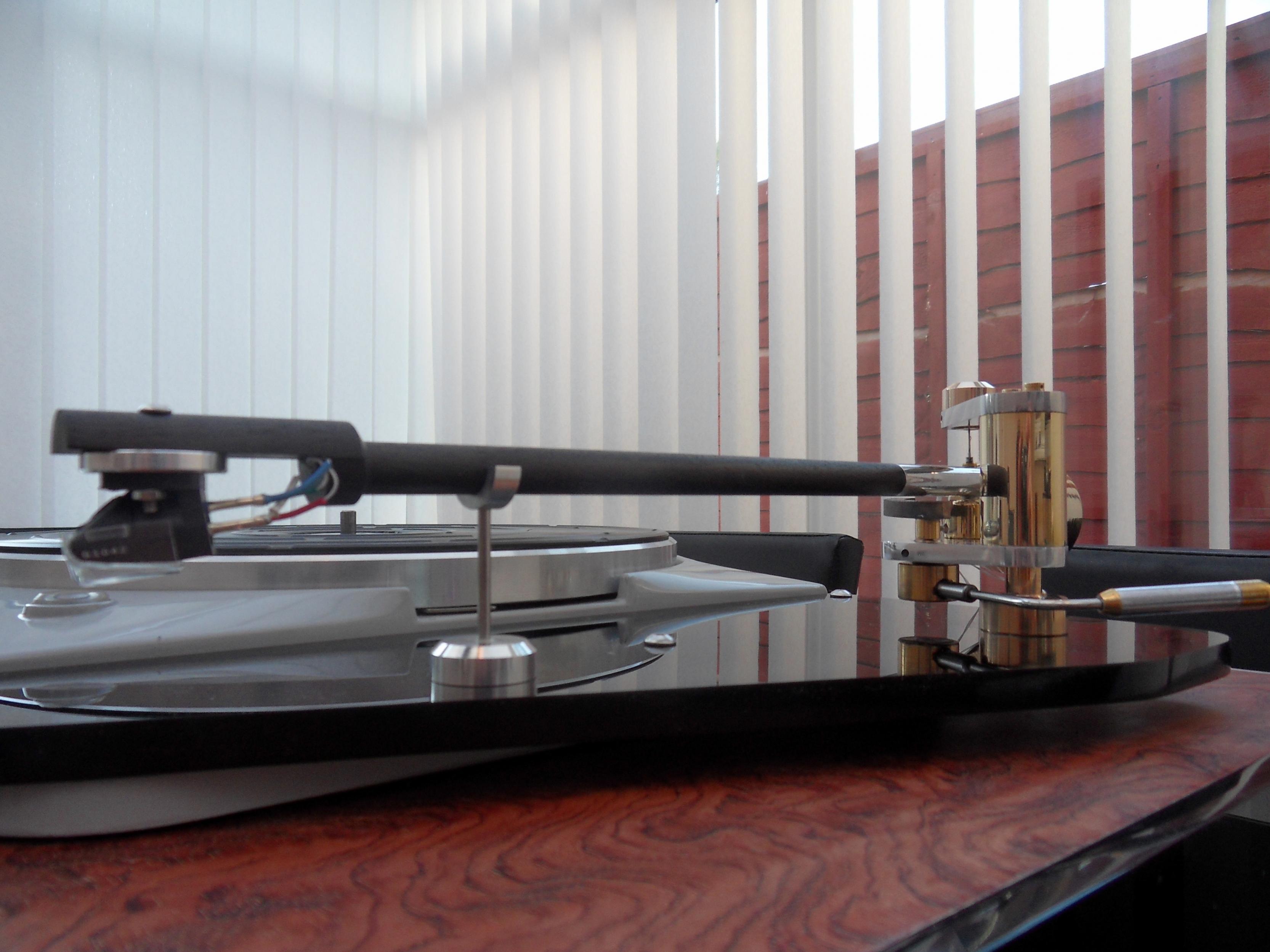

hi all ive finally got around to rewiring the arm and making the new arm board.
Nicely played!

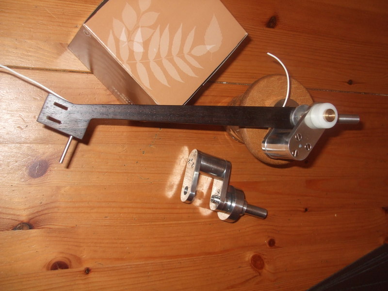

HI,
Just in the final assembly stage, i need to keep the weight down to an absolute minimum as its for a suspended subchassis TT.
So no arm lifter, and all Alluminium and Delrin.
