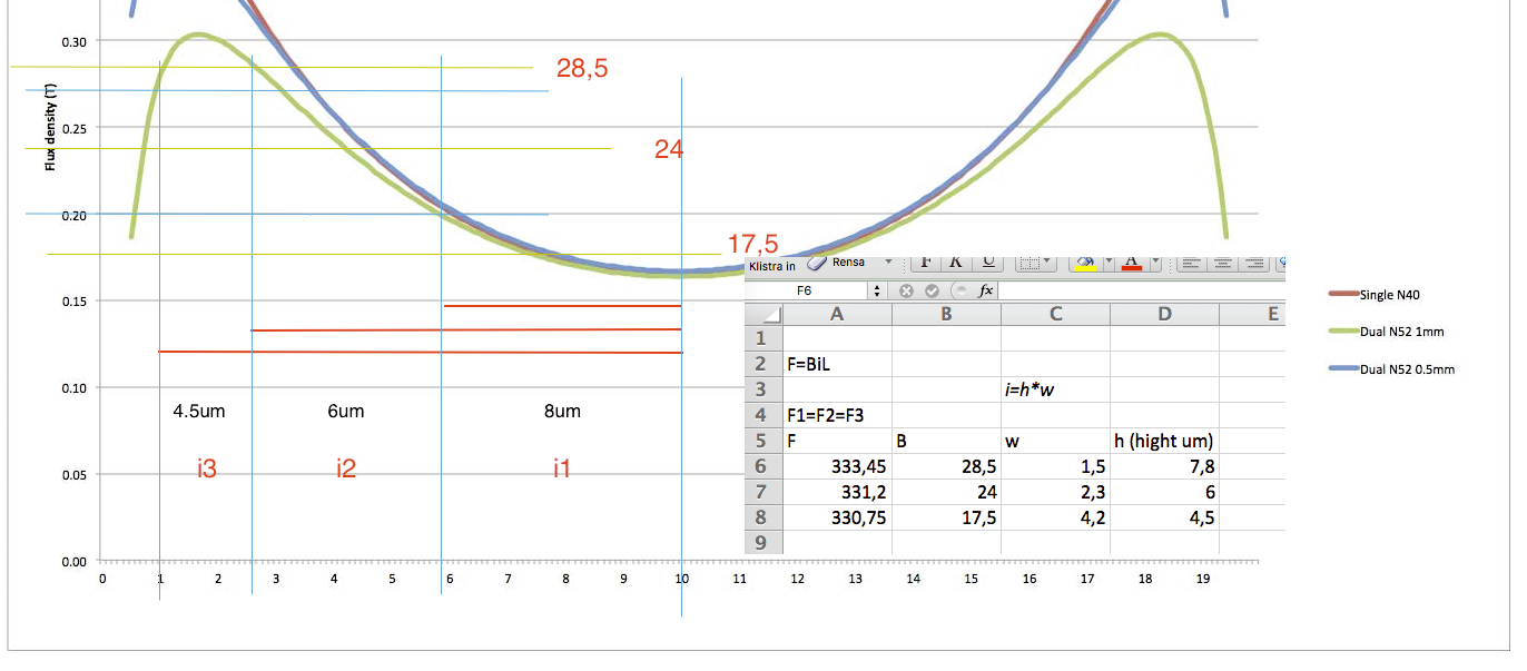

I managed to etch 15->5u successfully. I'm thinking about how to control the current concentration (less on the sides, more in the middle) to compensate for the non linear field in the gap. Possible? Worth the trouble? By doing different stints of etching one could make different thickness?

One obvious suggestion is to have the middle area painted with some etch resistant stuff; it doesn't need to be perfect though.
Then etch the desired difference, remove the paint and then etch again.
Trouble is to find the etch resistance paint and then find out how to remove it without ripping the foil apart. Some kind of solvent?
Perhaps it is easier the other way around; first etch the whole and then apply paint to the middle? That way it should be easier to have several stints and perhaps you don't need to remove the paint?
You'll have to calculate the resistance for each step though, but that should be only to add several fictive aluminium layers width individual thickness in order to get the resistance for each step.
And if you are treating a longer foil strip than needed (to be cut into several when done) you could have resistance values that are easier to measure during etching.
But if you are using four point measuring during etching that might not be needed?
Sorry for the lecture, but just to be crystal clear:
No paint, etch until X ohm,
Paint in a small middle section, etch until Y ohm,
Paint in the wider middle section, etch until Z ohm.
Spot on solhaga! Thats the way to do it. Some solvent is needed to remove "paint" (wonder what it could be?) as any mechanical treatment is out of question.
I will try this in three steps as you describe above. Where are my magnets
