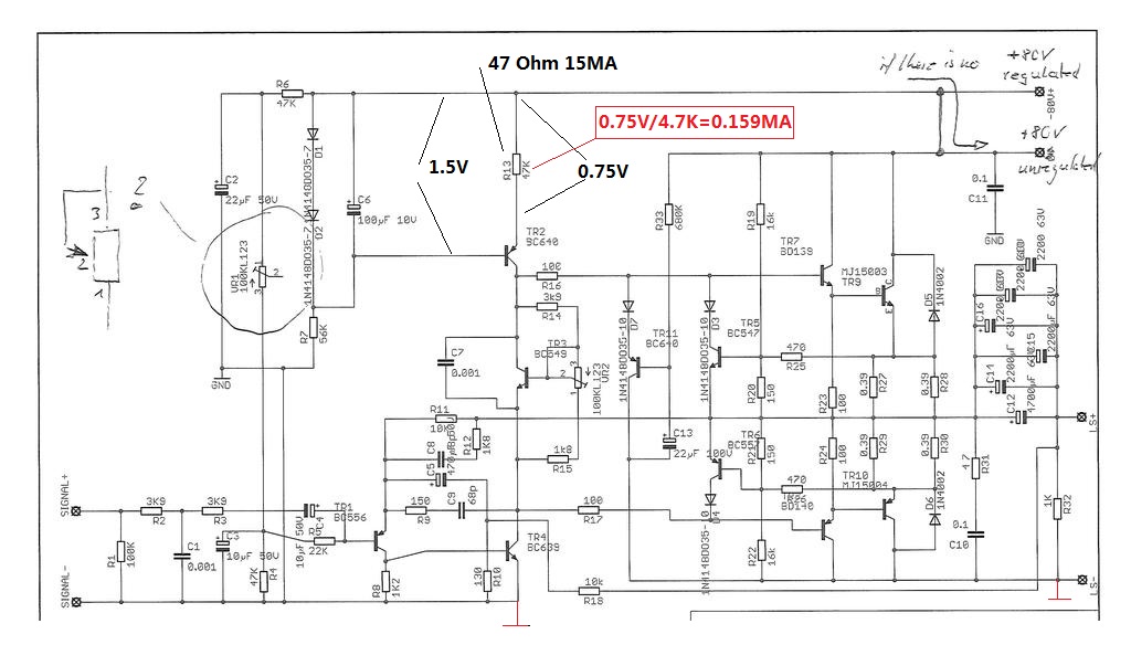

Hi Ian,
thanks for your comments. This is the reason why I posted it here. I'm only a mechanical engineer .... :confused:
But if this is the onliest serious problem I think I found the solution. In the orginal schematics there is a "+80V REGULATED" and a "+80V UNREGULATED" power input. I think my interpretation that UNREGULATED is "0V" was simply wrong.
Se my comments in the right top corner:
If there is no "+80V REGULATED" input, "+80V REGULATED" and "+80V UNREGULATED" must be the same. Is this right?
This will bring me to another improvement opportunity for the new PSU which is still not printed. What is neccessary to implement a "Regulated 80V" supply on the PSU Board?
Another question I have is related to the hand written sketch on the left side: In the schematics the connection of VR1 Pisher is not correctly done. I already corrected it. But is the direction the right one?
What other serious problems are in my transfered schematics?
Regards from a mechanical engineer :confused::rolleyes::cool:

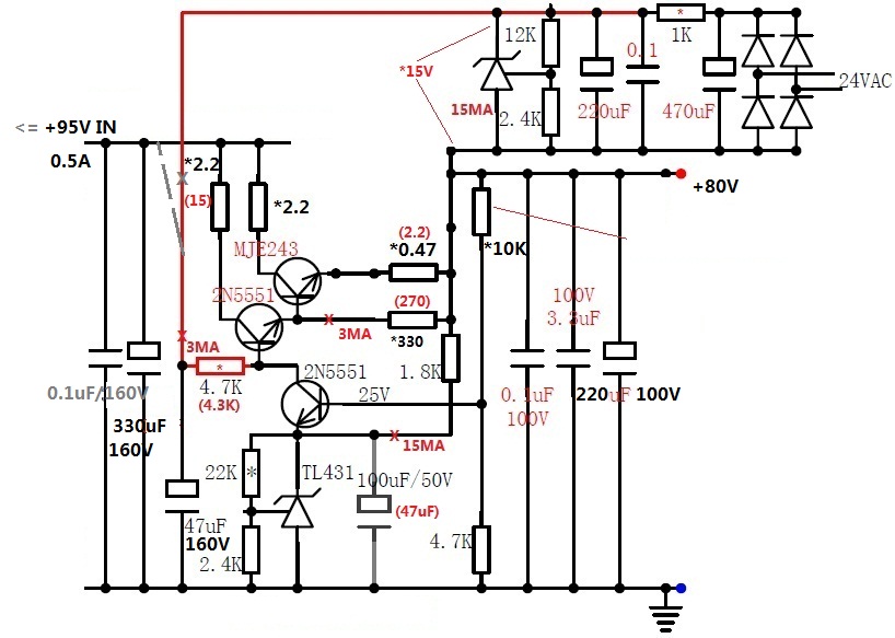

Here's circuit diagram for battery sound output for your amplifier
The labelling is still wrong, but the schematic is more or less correct, as far as I can see. There is no -80V because the amp only uses +80V, here split between two separate lines for a possible regulated supply for the input and VAS stage. The two 0V/grounds sides are seperated and connect to a single point not shown on the drawing.
Do you find any other faults?

Your circuit diagram is not correct. see
