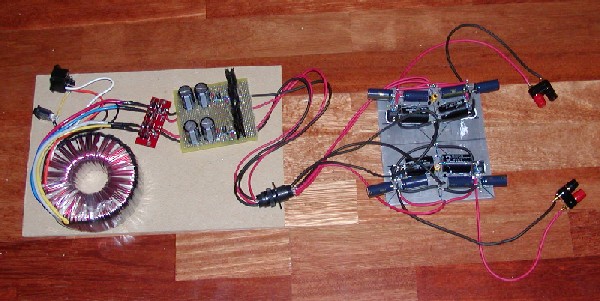

Maybe there hasn't been an overwhelming response to Nelson's GC Supersymmetry articles, but I for one have become quite obsessed with getting one up and working. I just stopped posting my progress as I worked out several problems, most of which are of no interest to anyone here. If luck runs my way I should have some good news about a working version to post later today.

Sorry Variac, you're going to have to wait a little longer for this hero to come to the rescue. Following the whole chip amp ethos, I have been building voltage regulators using the LM338 IC and then blowing them up with transient inrush currents. I made a last ditch attempt tonight to implement a slow turn on circuit with them, but these little IC's still weren't up to it.
Nelson, you win! I'm going back to building discrete regulators for this project that won't be so fragile. Now if I could only find more time.... Don't worry Variac, I'm slow but ridiculously persistent. I'll get you there yet.

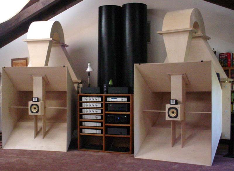

System of the week
Last week I mounted Lowther DX4's up in the KleinHorns
and gave El Pipe-Os a nice black paint job and put them in
the middle. Then I put some TAD PT-R9 ribbons on top.
The pipes are low-passed at 18 dB/oct at 22 Hz, the Horns
are single pole at 60 Hz and 8kHz, and the TADs are 2 poles at
10 KHz. The system measures +/- 5 db from the listening position
from 20 Hz to above the MLSSA's range. The Lowthers and TADs
are powered by 10 watt F1's and the pipes are powered by an
Aleph 30.
Just thought you'd like to see the system before I take out the
rack in the middle and put in the 50 inch plasma....
Aleph 30.
