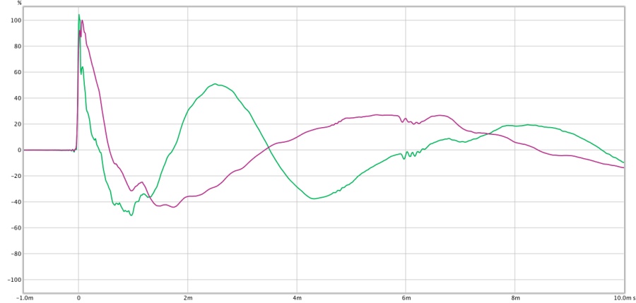

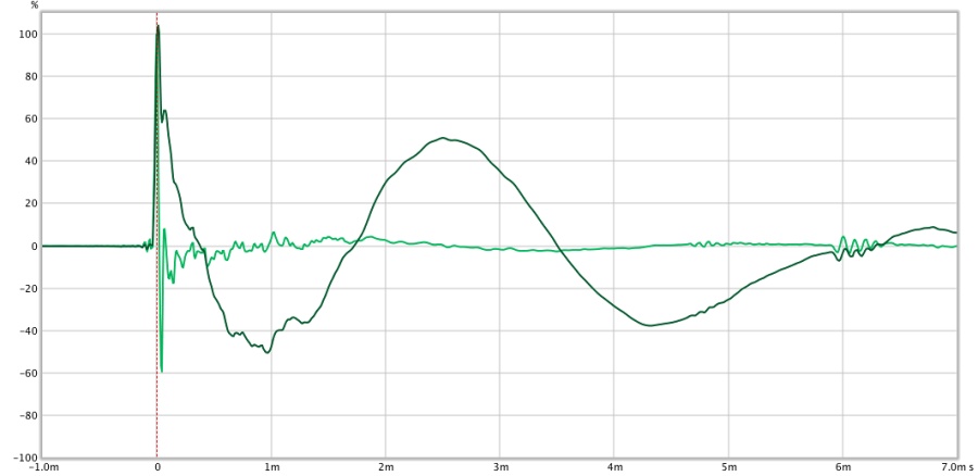

...Which provides a segue for this post. I decided to take a closer look at how the planar drivers are behaving. I've been reading up on Room Eq Wizard so this also provides an opportunity to apply some of what I learned. I'm going to post a bunch of nearfield measurements taken with the mic a few cm from the central conductor of one of my planar drivers, grill cloth in place, and with the "crossover" and equalization still applied. Some of these measurements are not super relevant but I'm going to toss them in for completeness. For example, I took a look at distortion just to see if it highlighted any nasty buzzes but since the measurement was done nearfield, the drive level was low and the distortion products are therefore unrealistically low. Nobody has asked for any detail on the design or construction of the DIY planar magnetic drivers so I don't know if these measurement details will be of interest to anyone. I'll throw them into the mix anyway---at least I'll have an easy-access record of my own results.

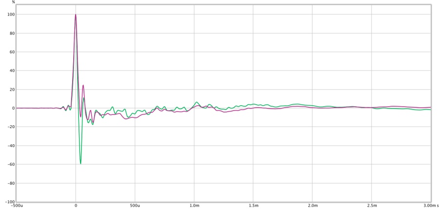

1) Impulse and step response. It looks fairly clean, but the large low frequency oscillation seems to correspond to the ~350 Hz peak seen in the magnitude response, not to the 150 Hz high pass crossover. I'm guessing it's a result of a 5.5 dB Q=2 peak I've added at 345 Hz in the miniDSP equalization. I added that based on measurements at the listening position. What do I conclude from the way it affects the nearfield result? I'll need to figure out a way to determine which works better from the listener's perspective. Maybe listen to pink noise while sitting at the main listening position and alternating between peak and no-peak?

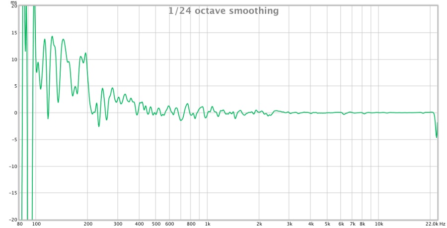

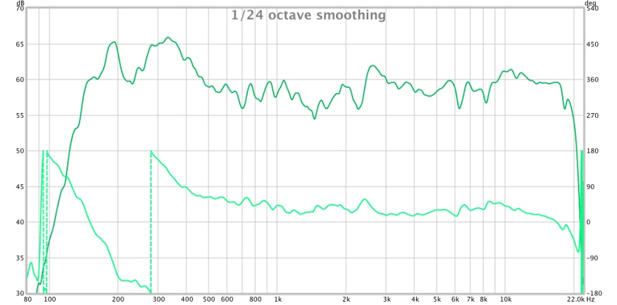

2) Magnitude and phase. The plot had 1/24 octave smoothing and now windowing applied. The peak described above is clear in this response. There's also a hiccup around 2.5 KHz. A resonance? That seems supported by some of the other measurements that follow. Perhaps I should repeat the measurement at other nearfield locations---this one had the mic centered over the diaphragm horizontally and vertically. I should also check other panels and see if they all show it or whether its unique to this one. I'm surprised the phase looks so smooth over mosts of its range. I have the ~1 KHz Bessel low-pass on the midrange and expected to see it mucking around with the phase in that region.

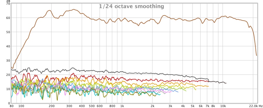

4) Distortion. The panel wasn't driven very hard because the measurement was done nearfield so I won't draw too many conclusions from this graph. It's nice that no screaming distortion peaks point to a terrible buzz somewhere but I'll need to drive things harder before I say much about nonlinear harmonic generation.

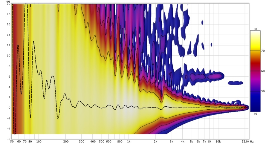

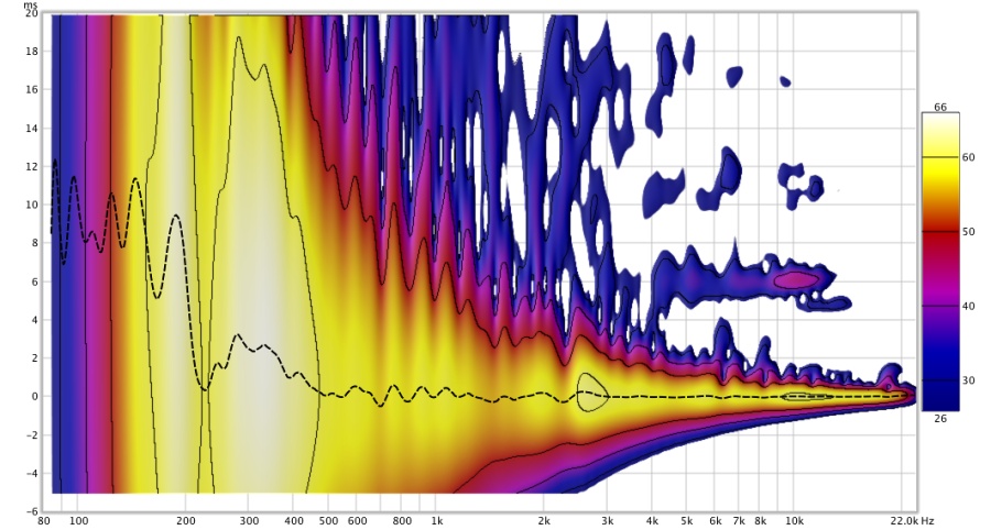

6) Spectrogram. To make the high frequency behavior clearer I applied wavelets rather than Fourier analysis. There's a pretty obvious ridge from a reflection that arrives around 6 ms. To my untrained eye the ridges shown in the waterfall plot don't leap out in this display of the data. Maybe if I play with the range a bit I can pull out some more details.
No doubt someone with more experience with some of these measurements can point out things I've missed or misinterpreted. If so, please chime in. Clearly nearfield measurements don't tell you what happens at the listening seat but I wanted to start here so I could have simpler results to work with in the beginning. I also wanted to see if there are any striking planar magnetic driver misbehaviors I need to know about before getting carried away making frequency response corrections etc.
That said, I should reiterate that all of this was done after equalizing the response I measured at the listening seat (mostly based on the moving mic technique). I could turn that around and see what I get---equalize to optimize the nearfield behavior of the driver and then make a measurement at the listening seat. The line array effects, dipole effects, and room reflections will all conspire against nice behavior at the listening seat, of course, so it would really be more of a self-education exercise than an attempt to achieve a usable set of equalization settings.

Just guessing here from eyeballing the chart, but I suspect your THD is mostly residual measurement noise in the mud. If you played a bit louder, the THD may not go up but the loudness would and so it would measure better.4) Distortion. The panel wasn't driven very hard because the measurement was done nearfield so I won't draw too many conclusions from this graph.
With THD, you know right away when something (the speaker or the mic or the computer) has crossed the line into overload. So you back off a bit.
If not.... the 2% THD indicated isn't quality performance.
Ben
That looks rather flat in the distortion department, I agree with Ben volume might be to low , for sake of distortion you could shove the mic closer, although volume should remain the same and you will see if the problem is the environment?
60 dB on tee scale is prob a bit low , not sure if you calibrated the spl ( I stil did not )

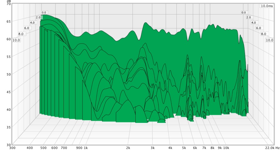

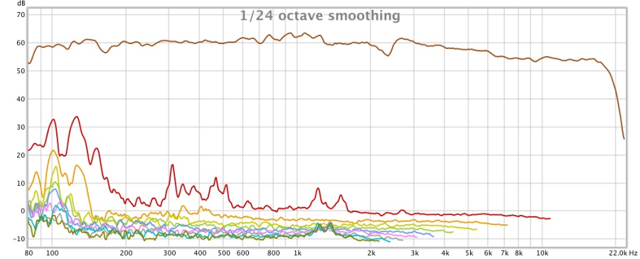

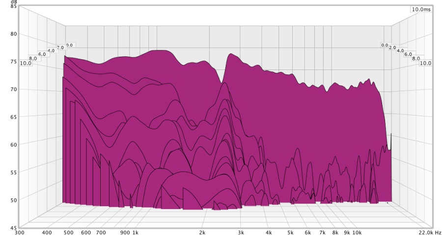

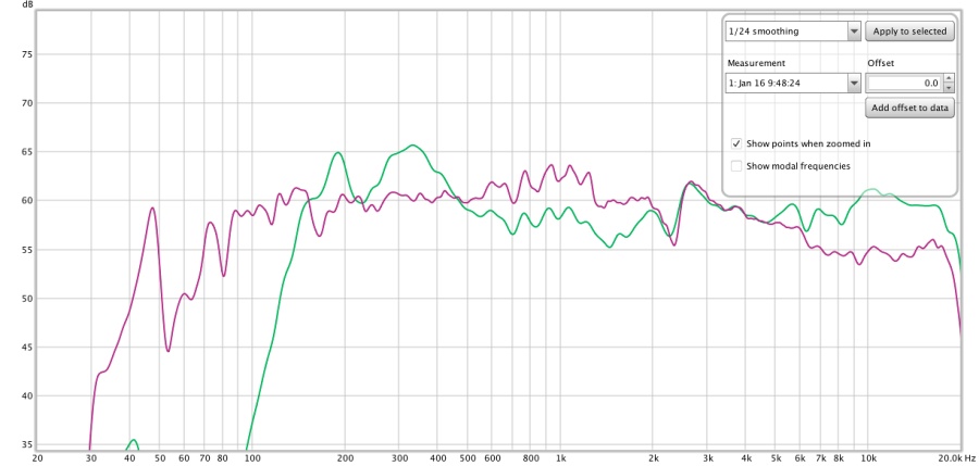

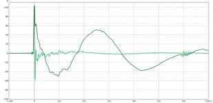

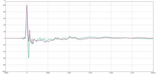

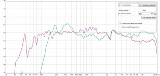

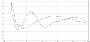

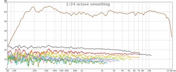

I removed all equalization except the 50 Hz high pass, increased the stimulus level, and moved the mic 2 mm closer (any closer and it touches the grill cloth). I can repeat with the grill removed but that will be another day.
The first three graphs compare results obtained with and without equalization applied (equalized = green, unequalized = purple). The wider bandwidth unequalized results make for nicer impulse and step responses. Removing the 345 Hz equalization peak helps the nearfield step response as well.
The distortion results are now more relevant. 2nd harmonic shows a peak of ~0.2% at 1.2 KHz, 0.6% at 310 Hz, and 1.24% at the 150 Hz crossover frequency I've been using. Looks like I should move that crossover up a bit to rely more on the woofer array at 150 Hz. No sign of a distortion peak at the 2.5 KHz kink in the magnitude response. Perhaps that's a reflection rather than the diaphragm breaking up? The CSD waterfall shows a ridge at that frequency, but again I don't see it in the spectrogram.
