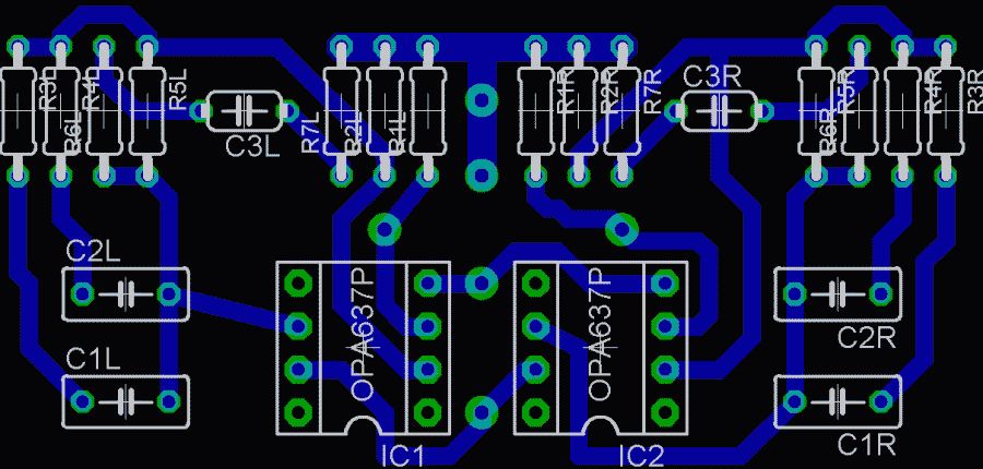

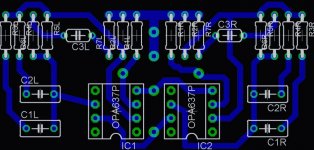

I am making a single sided PCB for this design that uses 2x OPA637.....but I am having trouble knowing what capacitors to choose.
Mine will be high-Z so:
C1 - 330p
C2 - 1.0n
but I dont know what types to get. I can see from the photos on http://www.geocities.com/rjm003.geo/rjmaudio/diy_pho5.html that they look kind of like green caps (Metallised Polyester) but then in ebijma's pics they look like box caps which are MKT (polyester) ???
does it matter?
Can someone point me in the right direction?
I will be using http://www.jaycar.co.nz/ as a source for components

maxw said:I am making a single sided PCB for this design that uses 2x OPA637.....but I am having trouble knowing what capacitors to choose.
C1 - 330p
C2 - 1.0n
does it matter?

ebijma said:
I didn't use the best caps for the RIAA and i use a input cap of 1uf.
But still what type of caps should I use? Greencap or MKT box shaped ones?
What you should use is totaly up to you.
For the RIAA i used MKT folie ones ( don't know the brand ), for the input 1uf MKT wima and for the output Blackgate 4.7uf non polar.
And i build the lo-z version.
I also put one 100nf wima on each power rail close to the chip.
Hope this answers your question.

I think maybe I thought it was more critical than it was
I will use the MKT one, they look better.
Thanks for your help ebijma.

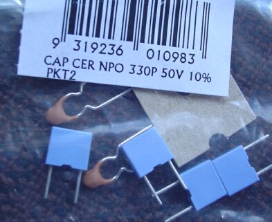

Got them today....I think I was thrown by the size of the ones in the pics but that is in the low-Z version which has bigger values so they are bigger (I think). I could only get ceremic caps in as low as 330p. If no one see any prob with these caps then I will design the PCB tonight.
Sound quality wise i should use MKT ones or better.
But he..... there's no harm trying it with ceremics.
You can always upgrade. I did.
