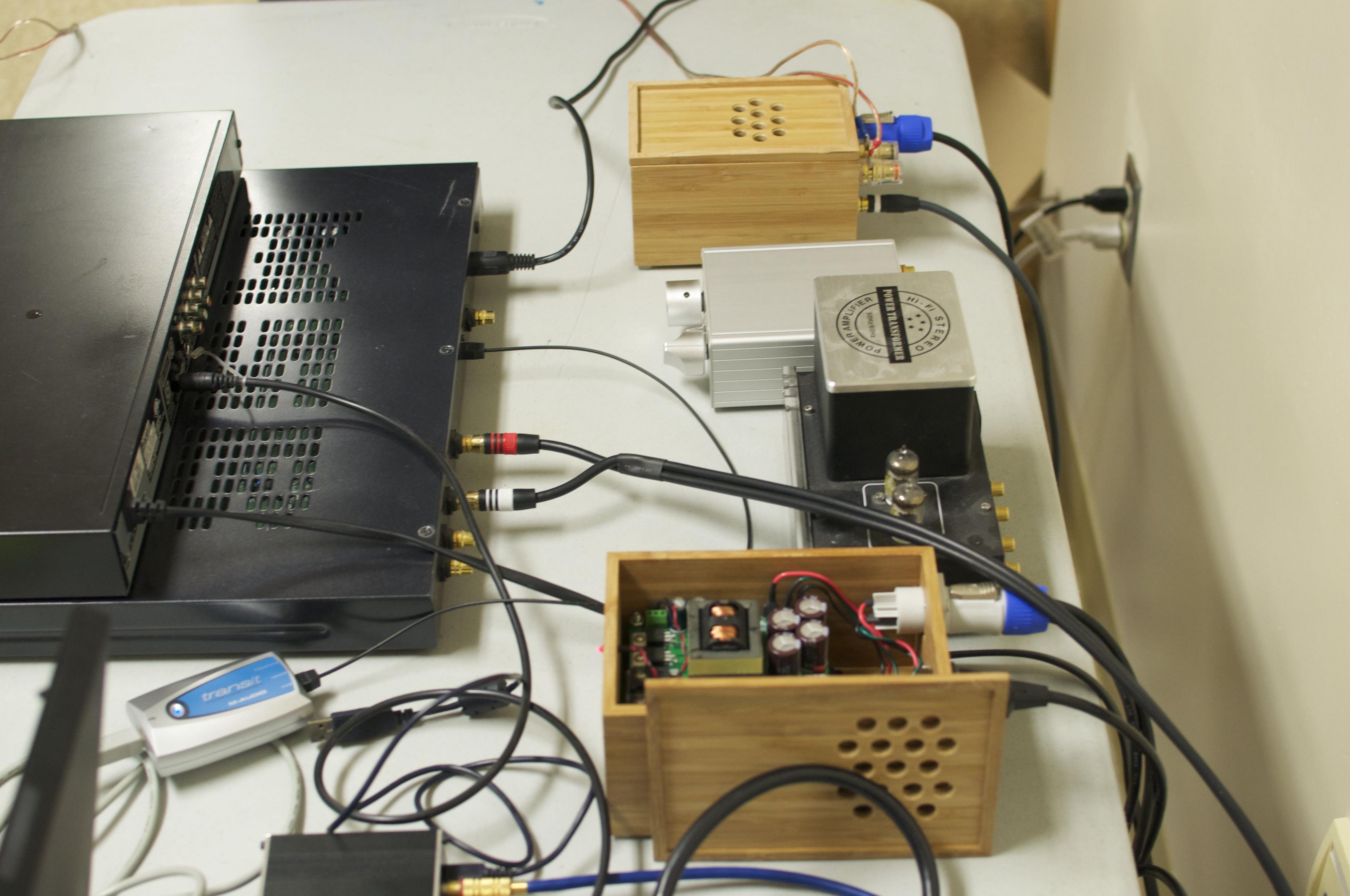

Yes indeed, see the photo below. Dave's speakers were powered by the bamboo amps on saturday, and I agree that it was a good match - IMO. Thank you Vincent for making me discover Peter Gabriel's "New Blood" :).

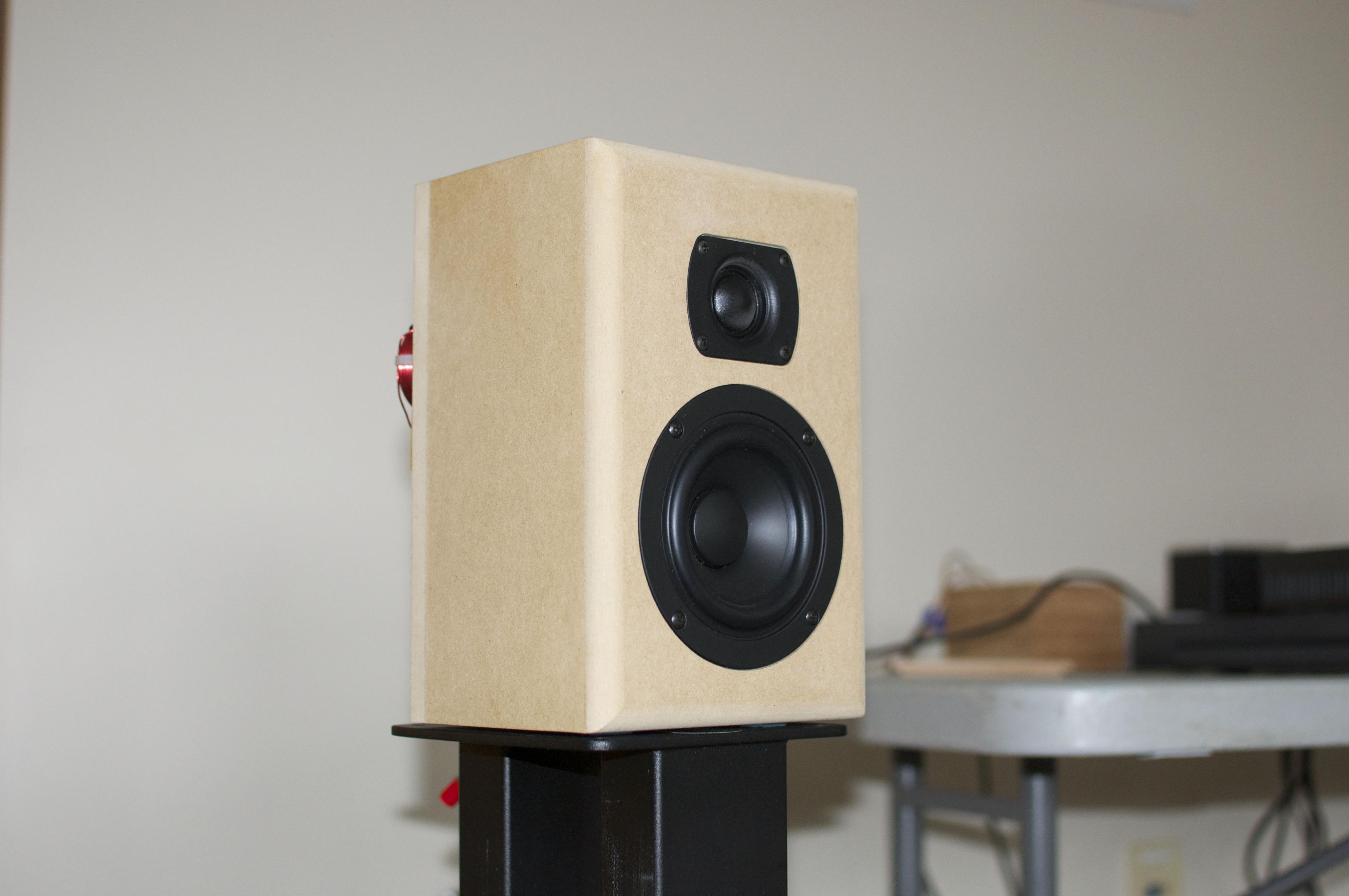

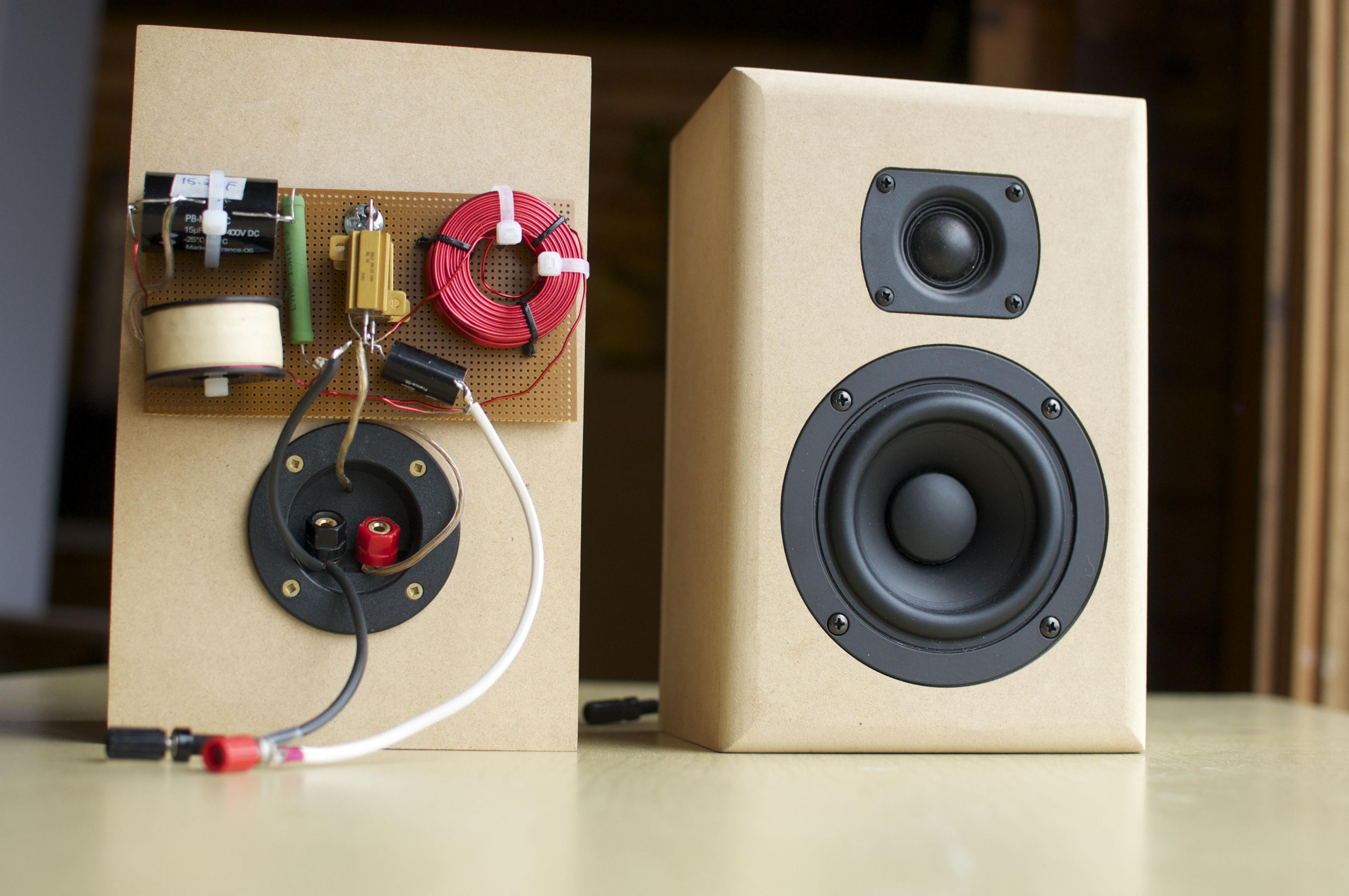

Dave's wonders. A sealed box design featuring the W4-1720 Tang Band 4" mid-bass and the Vifa D26NC55 tweeter (unfortunately discontinued). Impeccable in room tonal balance, and many other qualities - too many to list here. The crossover is the result of clear design and voicing goals, thorough measurement of the drivers, and extensive simulation.

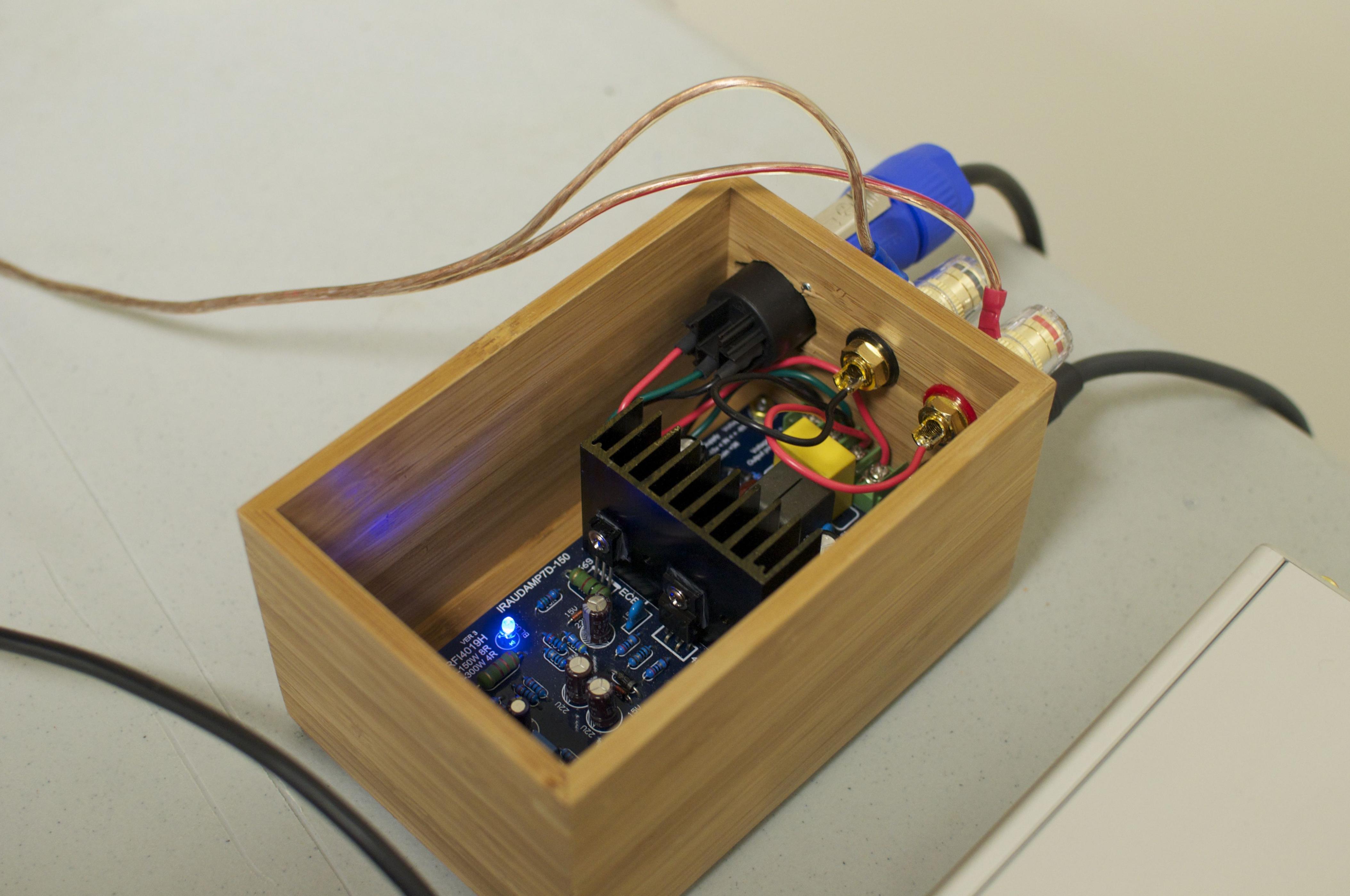

For everyone who asked me about my Ikea Bamboo L15D Amps, here's a link to the latest version of that board (and the reseller I used) LJM- L15D-Pro.
MrSlim's amp in their bamboo cases. The three picture shows how little space they use; closeup of one of the channels; and the separate box for the supplies. This amp barely got warm and sounded pretty good.
