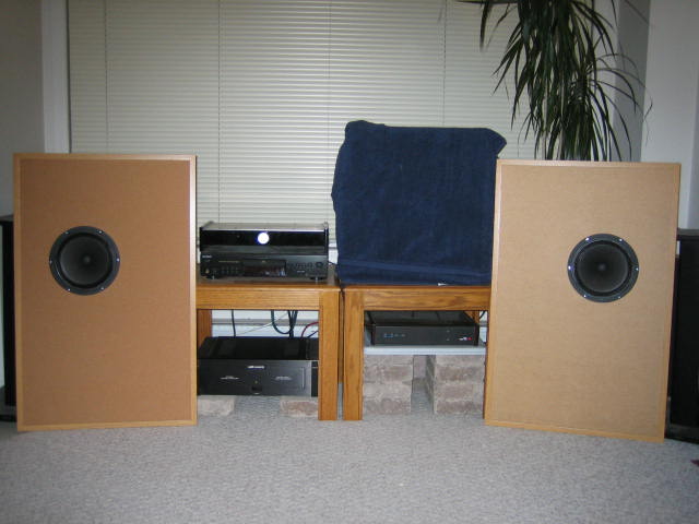

Have to share a photo of my very first DIY Speaker Project.
Visaton B200's arrived today (Thank you Solen!).
I just could not wait until the weekend to buy a sheet of plywood & get to someone's shop (we live in an apartment) to build some nice baffles.
So this evening I ran down to Wal-Mart, searching all over the store for anything that might work, at least temporarily anyway. Lo and behold, I ended up bring home a pair of 22x34 cork bulletin boards with some nice oak trim (I know, not the best for diffraction) for all of $13 each!
I did some "Golden Mean" calculations for speaker hole placement. Whipped out the jigsaw and cut out the holes in the kitchen - No problem!. The holes for the bolts were a little more tricky as the drill bit would break off some cork as it exitted the backside. No worrys. The speakers bolted in fine.
Hooked them up and WOW! Open Baffle sure is what everyone says it is! Very open, clean & natural. Sure notice the lack of that "Box Sound"
The B200's are very quick and smooth - and they have some breaking in to do yet. Bass is a bit shy of course, but still is more than I expected. Treble extends nicely. This is going to be a late one!
Thanks everyone here for the inspiration & motivation and also for letting me live vicariously (up until now anyway) through your experiences.
Don't worry, I'll get those B200's in a nice set of baffles soon enough, probably with a sub of some type in the bottom of each.
I'm calling these the "Corky's". Incredible sound for less than $350!
Now I'm thinking about a decent SET amplifier. And maybe the Fertin voice coils one day as well.
Fun stuff.
PS: Yep, that's a towel over the TV (to avoid the camera flash issue)

For future use, I'd go with two of them, dipolar, mouted either on a flat baffle or an H frame with EQ, preferably active unless you've got 200W available from your amp to pump into them, in which case passive is possible (though not as good). Should give you decent lows, but maintain the dipolar benefits, which are at their most pronounced in my experience in the bass and lower-mid regions (ironic, as this is the most difficult thing to do with dipoles) in preventing or reducing the influence of the room.
I like the idea of the cork boards -novel, and attractive too. Wish I could find somewhere in the UK that makes decent ones for a reasonable price. Looks great to me!

I did some more experimenting with the Corkys tonight. I flipped the speakers over and changed sides. More weight now and a better balance overall, even with the drivers down that low.
This also gets the drivers away from radiating directly back into the blinds (which are made of metal).
Very educational.
Another idea I had today was that if I were to use cork board again, I would put a block of wood behind them when I was drilling the speaker bolt holes. This would probably prevent the cork layer at the back from breaking off when the drill punched through.

Well, I rotated the speakers back to their original position with the drivers up higher. I just could not get used to the image being so low.
BUT, what I also did was hang bath towels over the back of the speakers (I did not have any felt around). This had an incredible effect of absolutely locking down and nailing the imaging. Wow! Everything became more focused and all sounds were now distinct in their own space and vocals gained a level of coherence. It got downright spooky at times. Bass also improved and I could actually now feel a bit of vibration through the floor.
Unfreaken unbelievable this tweaking business I tell you.

One suggestion, as you mentioned problems with tearing the cork when you mounted these things, straight from Linkwitz: mount the drivers via bracing the magnet from the rear, and don't bolt / screw them into the baffle at all. Not as easy to do, but much better, and will preserve the cork.
If you used another one in future in full-range, then of course, you'd run into lobing problems, so you'd have to introduce a filter to roll one of them off quite quickly, but this can occasionally be a better option than trying to match two dissimilar drivers.

Lot's of great stuff on the Linkwitz site. Gotta read it several times to get the jist. I don't want to EQ the "main" B200, but will do what it takes (EQ/XO/Slope/Enclosure/Baffle) for the bass driver to get the low end right
The cork bulletin boards are temporary and a quick way to get listening to my new speakers. I don't think I fully trust them to stand up in the long term, as they are a touch fragile. I may do what several people have done though and that is attach a layer of cork to my permanent MDF or plywood baffles.
I will certainly consider magnet mounting for the "final" version as well.

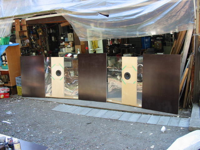

I was getting quite satisfying bass out of the B200s... you just have to have a large enough baffle.
We were getting amazing bass out of the little 6.5" mounted in the original baffles and augmented with Illusus' super ply....
dave
