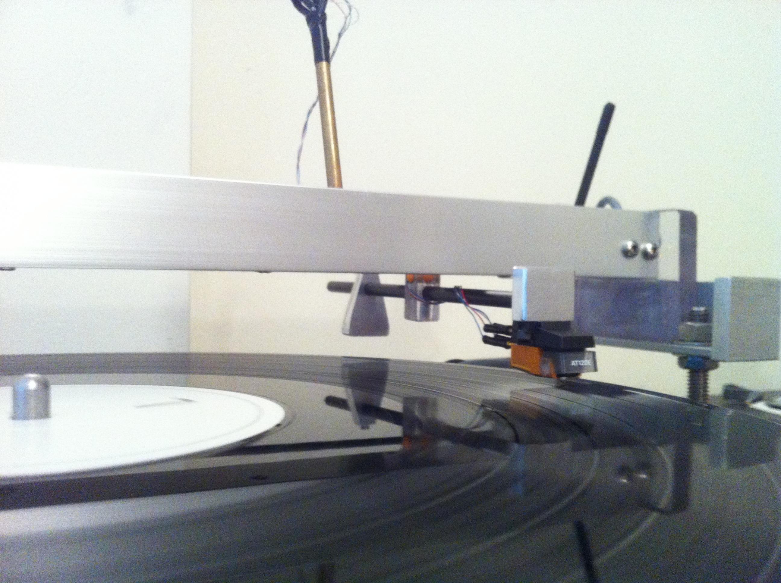

Hi all.
Unfortunately due to work comments I won't be able to unpack my "workshop" for at least a week. In the meantime I'm just going to enjoy the arm as it is. As long as I keep the eccentricity of the two wheels opposed my tracking issues aren't to much of a problem.
The arm has highlighted a tweak that needs to be addressed elsewhere in the system. When making the crossovers for my speakers I purposely left a couple of db lift to the treble drivers (crossover at 5.5khz). I found that this was necessary to overcome the rolled off slightly dull treble of the rega. My arm definitely doesn't suffer this problem. The extension and detail in this portion of the spectrum is one of the biggest leap forwards this arm has given. The slight step at 5.5k is clearly audible now. It's definitely time to pad the tweeters.
Niffy

Hi all.
Niffy

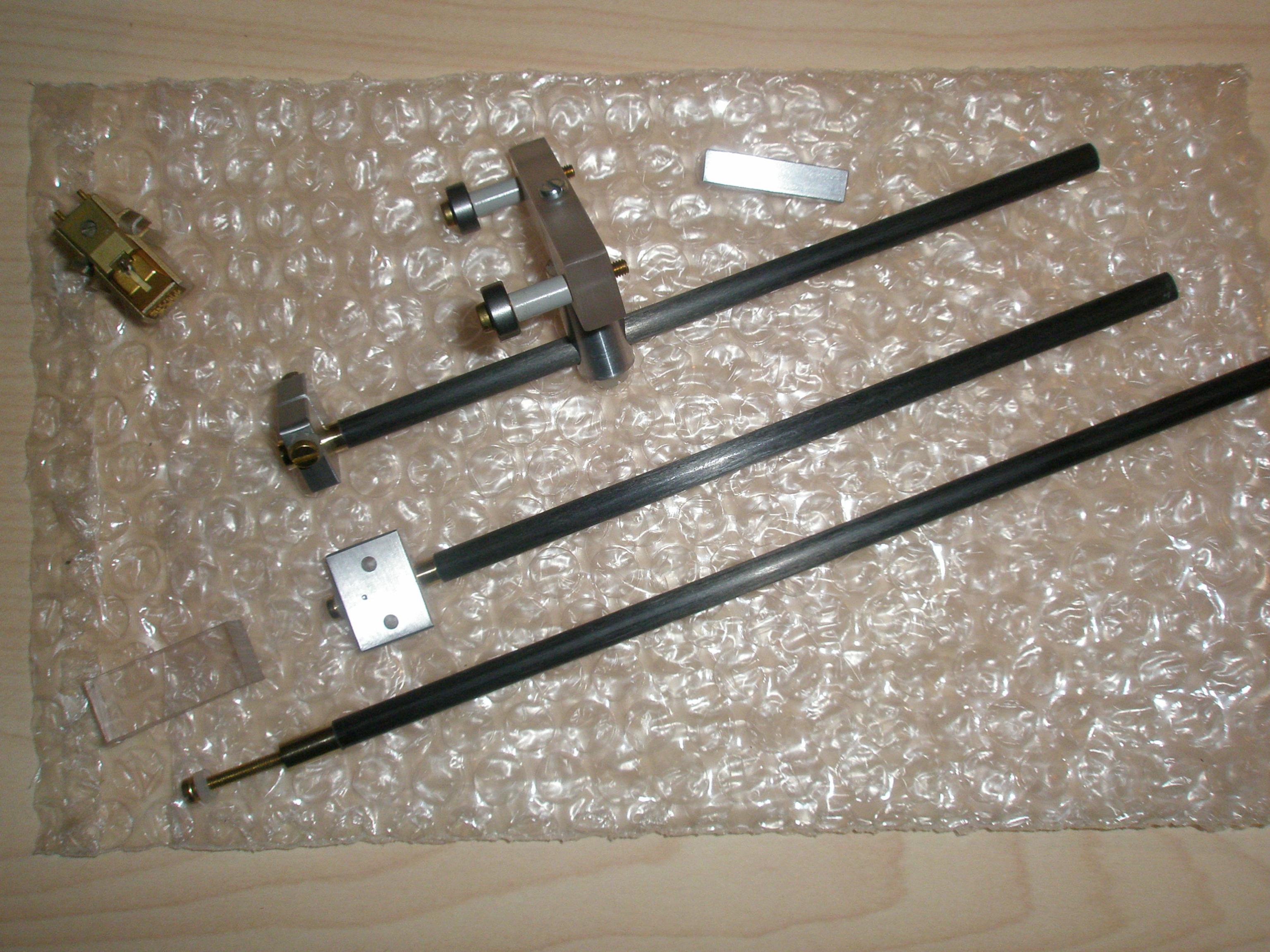

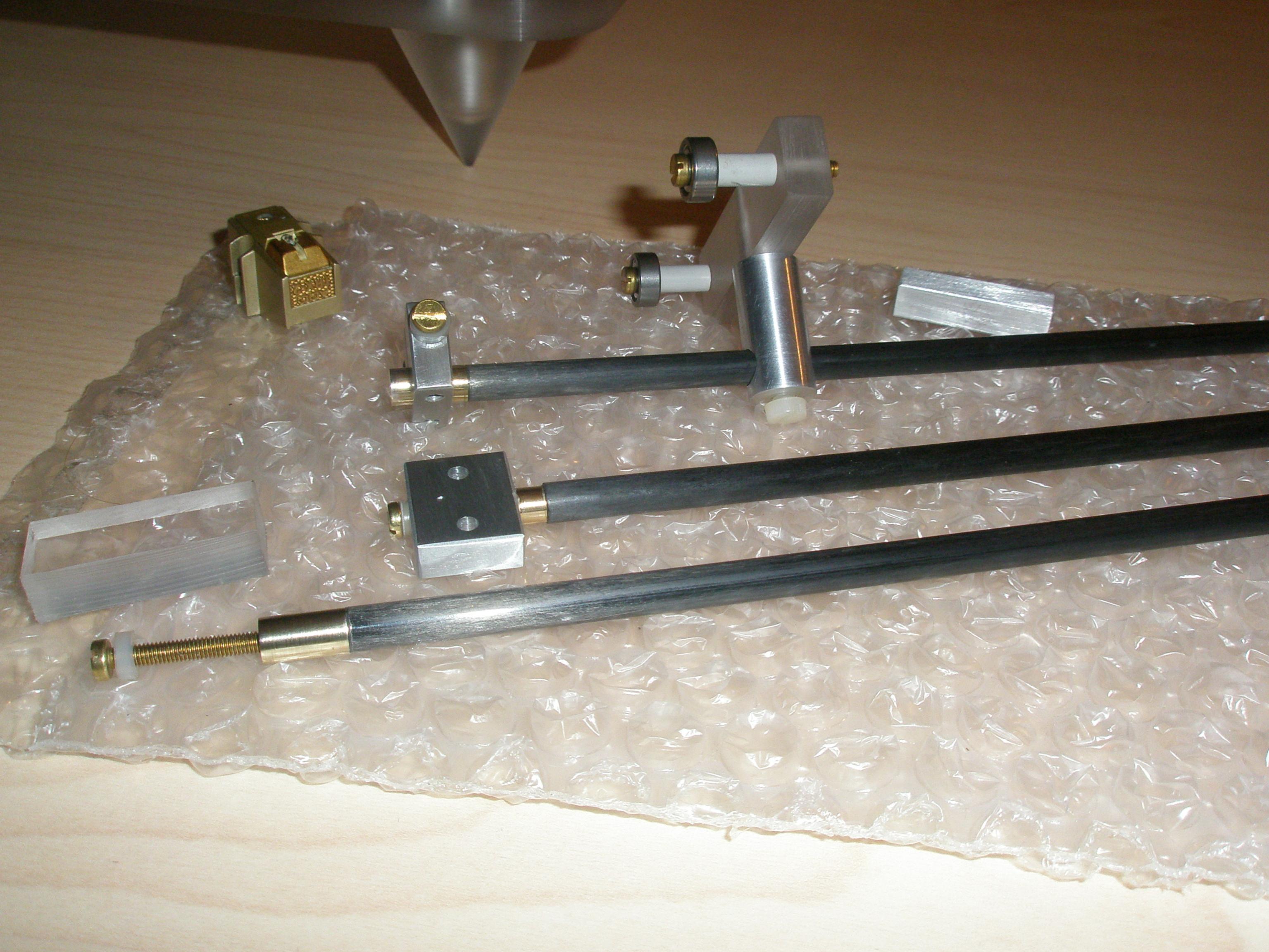

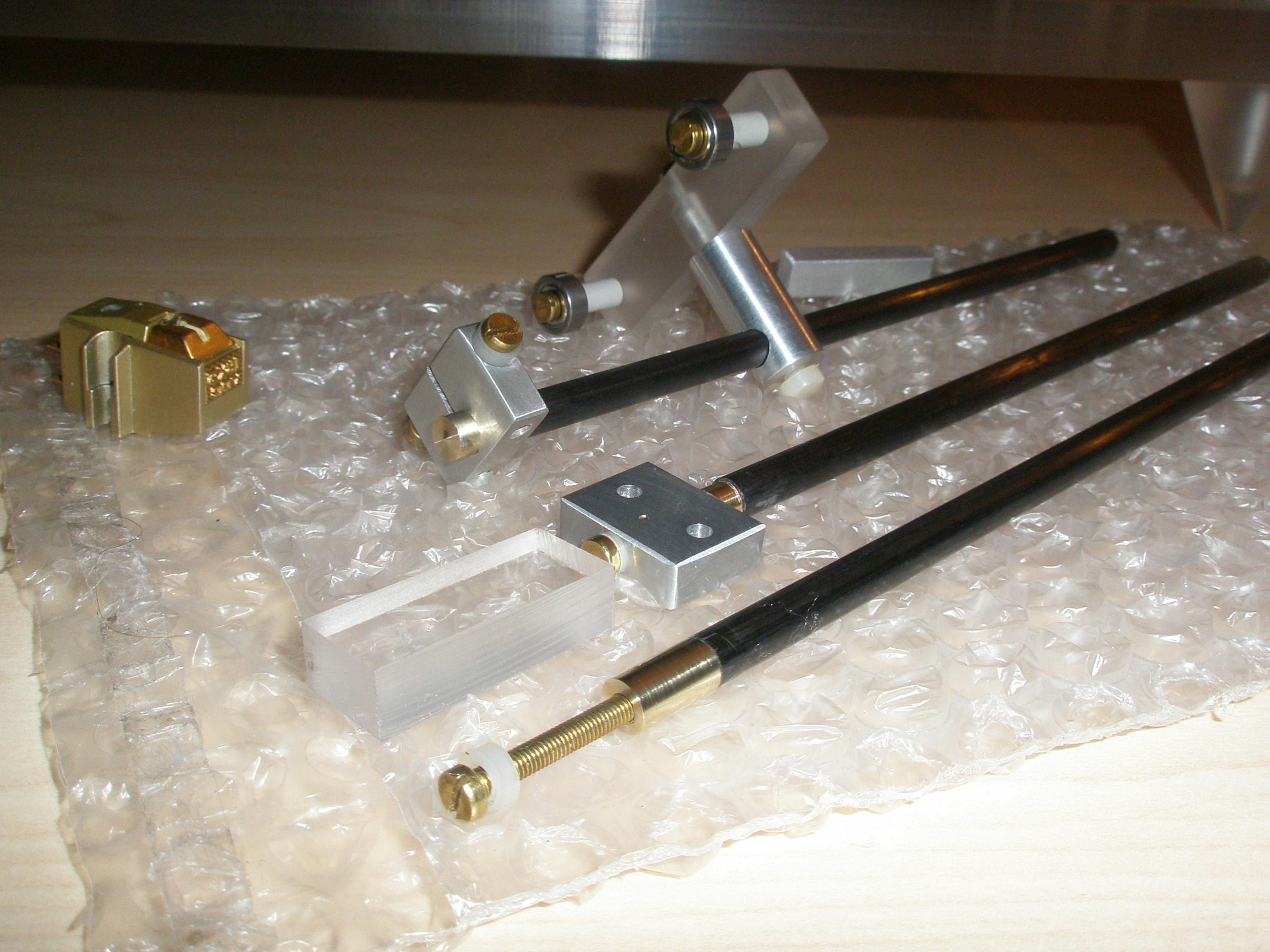

just a few shots ,
of the latest wands I have been working on . the brass inserts are poking out 10MM and 20MM into the carbon rod , press fit with with a tiny drop of locktite
Industrial one second glue ( very rapidly pressed in with a handpress . M3 thread size tapped to secure the line bored headshell . all made on my minilathe which is fun and good exercise at the same time . I even turned the carbon rods to lenght in the lathe :D haha . I have a couple more wands to do , as I want to try as many as I can , and have tons of material stocked in my workshop so what the heck . aluminum headshell/weight , polycarbonate with a steer horn brass or bronze stabilizer . the building is as much fun for me as the actual listening / comparison to be frank .
more foto's will come later , as I'm pretty occupied these days . but just to show you guys that I'm not sitting on my lazy *** ;)
THX
Paul

Hi Paul.
Gorgeous finish quality on all you carriage components.

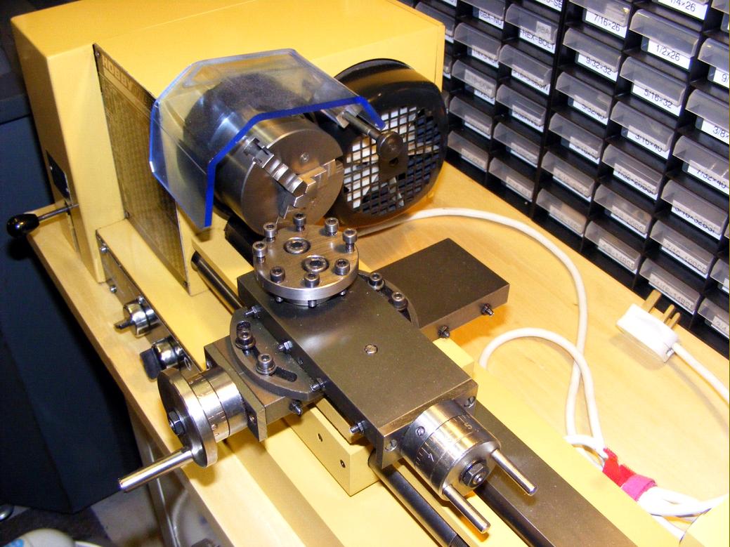

You own a mini lathe! Green with envy, what make is it and have you measured its concentricity?
I totally agree with your last point. DIY. Triple the fun. Fun designing. Fun building. Fun listening. And the joy of knowing "I made that".
Clearaudio deck? Or diy?
Niffy
Beautiful work Paul!,
It is awesome to see the progress and everyone's iterations of the arm. My vote for best sound goes to the upright alu block headshell, but this is a great opportunity for suit to taste because that's what it's all about. The latest lowest slungest counterweight is the best so far, and adds atleast double the stability to the carriage.
Colin
Thanks guys !
I want to check out 5 or 6 different wands with one and the same cartridge . Will also fabricate a few counterweights , different shape and weight , low slung etc.
BTW , some carbon rods are of the thin wand variety , and funny enough they sounds less ringing opposed to the thicker carbon sticks :confused: easy to check haha put them into my ear and tapping them with a screwdriver .
My lathe , nothing special or expensive , a Hobbymat , see attachement . I bought it new and only using it for light jobs . sure it's pretty accurate and once in a while using a dial to check , or dead centers kissing methode .
Good eye NIffy :) that is another project of the many , Clearaudio Emotion which I bought w/o arm . perhaps a nice easy TT to equip with a linear tracker someday soon haha , altough my heavy mass Lenco with remote driven platter will probably be my ol time favorit . I hate flimsy apparatus .. no idea how that comes , it's just that mass drives are providing so much more stabillity in both sound and comfort .
THX
Paul
