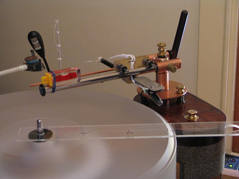

Hi all.
The pics in my previous post are of my build to date. Although it looks very different to the other arms in this thread it bears many similarities. It is of course a mechanical linear tracker. It has a short effective length, a bit shorter than Colin's at only 55mm. My track/rail is set much closer to the record surface in order to minimize wow. To facilitate record changes the track slides to the back of the deck as shown in the last pic. When the track is in the play position it is securely locked in place using the knob seen on the upright.
Adjustment for cartridge alignment are all dome using solid screw adjusters. The cartridge come back into perfect alignment every time the slide is locked.
As previously mentioned the bearings I am currently using are pin bearings, though as soon as I have finished the two rod track I will be comparing them to ball races.
The main difference in my arm is the carriage. My aim in designing the carriage was to keep the entire audio-bandwidth within the range where the cartridge is held steady by the effective mass of the arm. In order to achieve this the resonant frequency of the arm has to be above the audio-bandwidth, over 20khz. To achieve this the arm has to be extremely rigid, hence the very short length and solid construction. For instance the cartridge sits within a bucket at the front of the arm eliminating a flappy headshell. The carriage passes both under and over the track with only a 2.5mm clearance above the record. Everything has been honed to the bone. The arm was designed by creating a custom finite element analysis program in excel, over a quarter of a million fields. I didn't quite hit my target resonant frequency. But 19khz in the vertical plane and way over 20khz in the horizontal ain't bad.(my hearing only goes up to 16khz anyway, not as young as I used to be)
How does it sound.
Difficult to answer without breaking forum rules. It sounds (insert expletive of choice) awesome.
Seamless through the entire range. Detailed open fast precise. You get the picture. I love it.
It still has a couple of tracking issues that are caused by eccentric wheels. Soon to be addressed. It very occasionaly skips due to this. This has highlighted the strength of the carriage. At the point when it skips the cantilever is a massive 3degrees or so off tangential. Even at this level of lateral tracking error the sound quality is still much better than my other deck (modded systemdek, rega arm same cartridge) is when running at its best.
Sorry probably blowing my own trumpet a bit there.
Niffy

Sorry for the possibly dumb question....
It looks like your two large slotted wheels ride along a relatively thin piece of wire rope?
If so, where is the tensioning device for the wire?
Very impressive piece of art!
Hi all.
Thank you for all your encouraging words.
I designed the current rail before I discovered this thread and had the idea of vertical friction introduced to me. At this point I was with doing what everyone was doing and aiming for low vertical friction.
I didn't want to run the carriage on a tensioned wire. A tensioned wire will resonate horrendously, think guitar string. The rail as it stands is a 1mm stainless steel rod, this rod is supported by a carbon fibre section along its entire length, this section is in turn attached to two 8mm diameter stainless thick walled tubes. These tubes are filled with damping material and internally threaded at the ends for mounting purposes. The rails are supported from both ends. Performing the pencil tap test with the stylus on a stationary record results in a barely audible thud through the speakers, very rapid decay.
No point in solving the resonance of the carriage only to move it one rung down the ladder.
Niffy

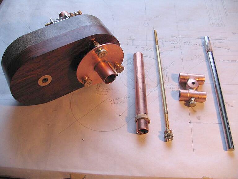

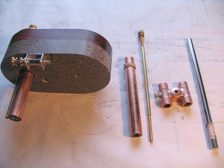

Alternate Methods - Part 2, OTF VTA
Dear Colin,
I've been gone from this thread for months now, due to dismay over one of the thread's theorists opining that a 4-bearing carriage would only travel on 3 bearings. That contradicted what I actually saw with my 'alternate method' carriage. Then yesterday, as a result of my viewing another thread I recieved an email of the notice below. A theorist leaving the thread?

My custom kit "Teres" turntable gives me different problems and different options for a Linear Tonearm. My immeidate prior experience with Pete Riggles "VTAF" VTA on-the-fly adjustor, as modified for my venerable Black Widow tonearm told me that conveniently adjustable VTA is a positive thing indeed.
"Polishing my rod", the stainless steel rod, has given grief. In fact my physician sent me to physical therapy earlier this week to to a shoulder injury directly attributable to 'polishing.' An yes, in truth, there has been blood on the tonearm. I've been working studily for months now, with even many 'engineering drawings' made to assist with troublesome details.
Colin, it was your gruding revelation months and months ago that '2 3/8" to 2 1/2" pivot to stylus distance was what you considered (then?) optimal that was my 'Go Code' to begin the project. I've attached three photos which show something of my OTF-VTA variation of your idea using the SS rod, and very low weight carriage construction.
There's been nothing but grief with phono cartridges. The "1st Play" was on 11Feb - the 40AWG silver wire is/was a PITA. The "1877 Phono" brand cartridge spring clips had pulled out two of the OM 30 Super's pins, destroying the right channel. That first play was 'left channel only.' But, it did track the entire album's width with nary a seeming 'flinch' from the test stylus, an "LPGear" OM10 substitute I'd purchased in anticipation of testing before the cartridge was destroyed by the spring clips.
My tonearm is completely disassembled again for a final (soldering mod) and stripping re-painting the copper base (the photos don't show the 6" main pillar extending below the swingboard). I await the arrival of two cartridges now for further testing. The Teres battery power system for the motor is failing ... the grief never ends when you're having fun.
What have I missed in denying myself months of theorizing in this thread? I felt that I needed 'peace and quiet' to achieve my variation of your design. How well is it actually going to work? Does everyone 'know' just how difficult getting an album under the tonearm is? Questions, questions. Hope you get a kick out of the photos of my "tangible results"?
For sure I'll be back with a 'final report'; and, I may even come back for more of the theorizing, since I feel that now I've 'put up' (after shutting up).

Alternate Methods 2 - construction
With regards to "Lexx21" for his private message here are six photos from the pentulimate stage of construction of my variation on Colin's ideas.
As to having 'a fully equiped shop' ... OK, now I've stopped laughing. Does having a drill press qualify as a 'fully equiped shop'? My 'lathe' is a hand drill. My soldering torch was $7.95 at "Harbor Freight."
Having an advanced degree in a research discipline, I am now retired after a career in a research support role, both hardware and computer. Of special note were the two graduate-level courses I took, "Philosophy of Science" and "Psychology of Science". Of course, I still find spelling and grammer vexing.
