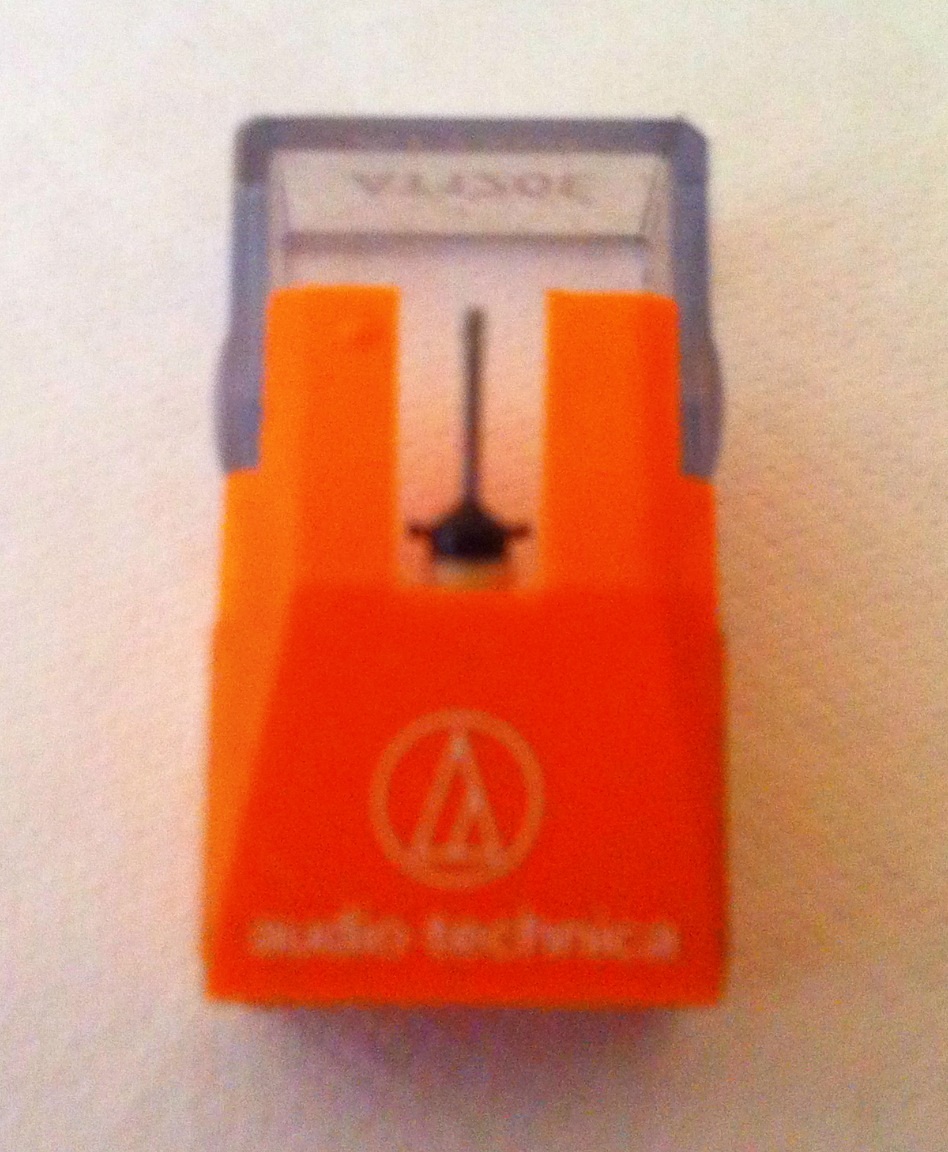

Pic of stylus
Here is a pic of the stylus I have been using frequently for every variation of arm, I think this can put to rest the stress on cantilever theory , not even slightly skewed, even at 30 grams lateral mass I can't even visibly see the stylus displaced on off center records. Keeping in mind an air bearings arm is atleast 50 plus grams of lateral mass, terminator is 70 plus grams.
My vinyl has seemed to stay quiet even longer than with a pivoted arm, and I've noticed an absense of obvious wear vs prior pivoted arms with antiskate.

A picture of a stylus, and something you can't see doesn't put to rest the resonance that exists in mass and spring system of tonearm plus carriage with cantilever suspension.
It's a real loss that you own test record, use it frequently, and do not record output. All results are anecdotal observations with no hard data.
What is precision of your test record's center location relative to track spiral?
