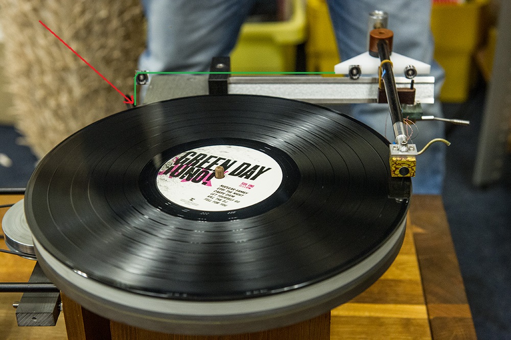

The pulley idea would work if it were not for eccentric LPs. The weight would prevent the carriage from moving outward, causing the stylus to jump the groove once per revolution of the LP.
If you wanted to test that idea, you could simply tilt the entire turntable a fraction of a degree.
My suggestion is, not to waste your time.
Sincerely,
Ralf

I do not see why the pulley idea cant work. Always there is a better solution but these is simple.
To demonstrate I took (borrow) these picture from the thread. Where is the red arrow you ad as much weight as you need. Simple you can adjust it until the weight almost pull the carriage. You can set up that weight with out play records.
In these case you can use longer arm (wind) like one on these picture which I think is better than the short.
Also that would enable you to exchange the record easier. I will tested soon after I built my TT.
Of course all these need to be thoroughly tested.
These just a simple idea. Of course I'm open to other idea to.
We here to learn new think, tricks from each other, and make it simple as possible so everybody can build it.
You can use two pulley , one each side that would give much stable support to the weight.
Greetings G
