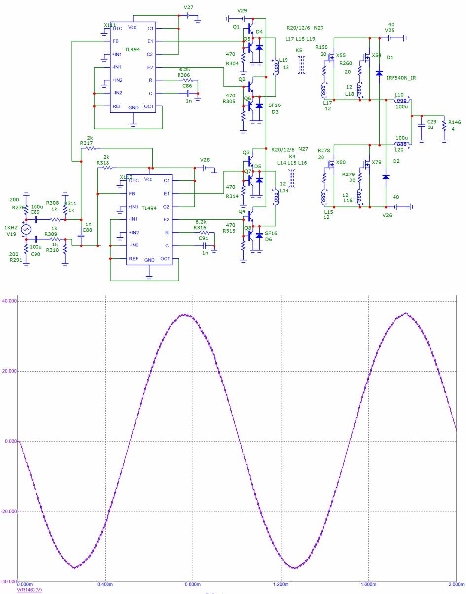

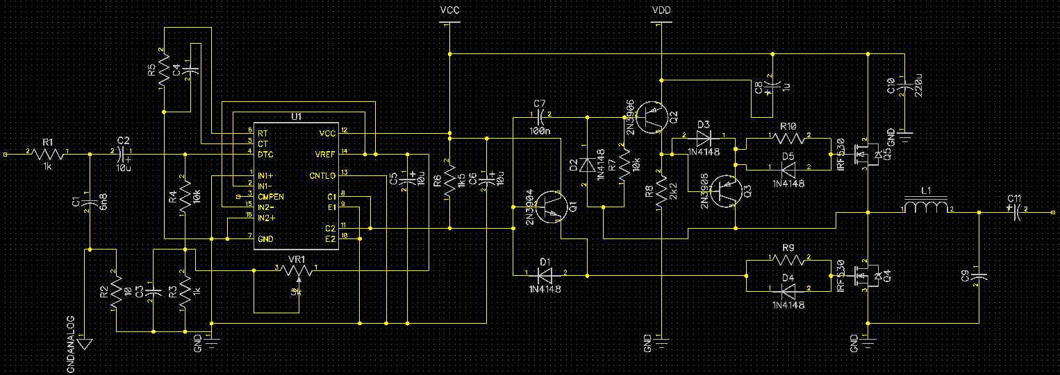

My goals are a bit different: 150W/2 ohm bridged for car subwoofer, with the highest efficiency possible. It will be a complete amp with adjustable filters LPF, HPF, bass boost and limiter. Also i have designed a semi-tracking and self-limiting power supply for it, using TL494 of course. :)
I'm looking to sell a few of these. I've found a nice aluminum case of the right size too.
Of course, the schematics and PCB will be free for all diyaudio folks. Though it may be a while till the whole thing is done - i've had this prototype on my bench for a few months already. I don't have too much time on my hands nowadays, and when i do have time, i'm either drunk or too lazy. But it will get done. :) I'm listening to an early revision PCB of my amp as i post this.
Here's the basic idea. Of course, for bridge, the output coupling capacitor is not needed. VR1 should be of the multiturn type. Also the bulk filter caps on Vcc can be much larger than 220u, that is just the minimum value required for stability. With smaller values amp will oscillate.
Vdd should be 8-12v above Vcc. Vcc can be 12-22v with no modifications. For higher voltages some values may need to be adjusted. Also, this driving scheme cannot be used above 25v as it will damage the upper MOSFET due to excess gate-source voltage at turn-off.

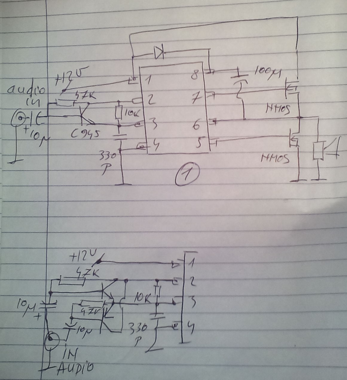

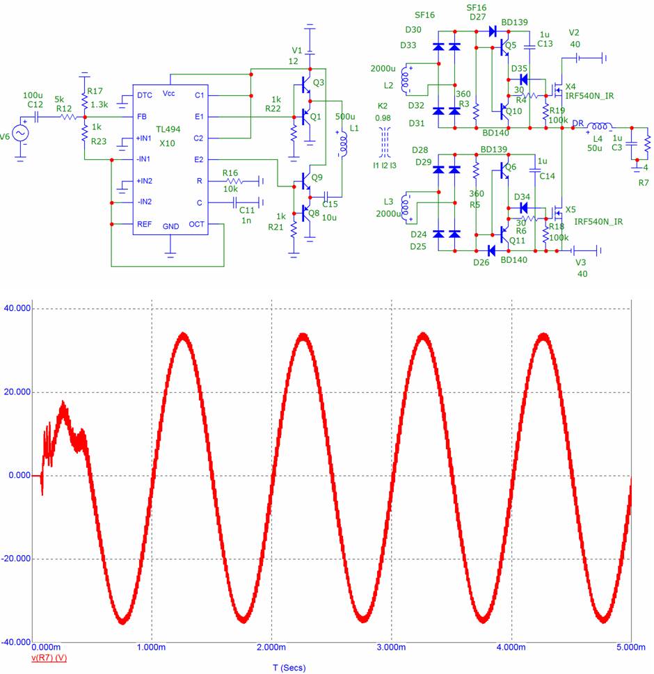

IR2153 audio modulated.
The schematic in figure (1) works, but sounds bad.
A single NPN transistor to change the capacitor charging.
Below, I have tried to change, capacitor charging and discharging. Not working.
When the RT pin have the GND potential,
capacitor should be discharged by PNP transistor.
The PNP resistor is drawn wrong, is from collector.
When the potential in B increases, NPN opens and PNP closes,
but in practice it was not so ...
If you have other ideas please put them.......
