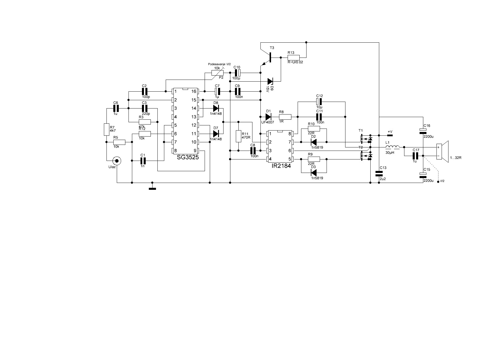

IR2153 audio modulated.
The schematic in figure (1) works, but sounds bad.
A single NPN transistor to change the capacitor charging.
Below, I have tried to change, capacitor charging and discharging. Not working.
When the RT pin have the GND potential,
capacitor should be discharged by PNP transistor.
The PNP resistor is drawn wrong, is from collector.
When the potential in B increases, NPN opens and PNP closes,
but in practice it was not so ...
If you have other ideas please put them.......
