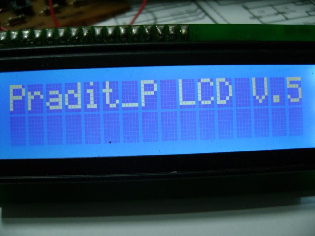

-_nando-_ said:This is Pradit_P design, and it doesn't work well.
Its working perfectly. Just check ur solderings

diybiz unit runs CD-ROM at hight speed?
Hello,
I have tested the diybiz controller with a Sony and a NEC CD-ROM (both 52x).
The CD spins at high rpm and the sound from this is unacceptable.
I have looked thru this thread but could not find a hint how to solve the problem.
As there are some of you that also use the diybiz controller I would like to adress the question to you if you have the same problem or if I just have to use a different CD-ROM (which one?).
Thanks in advance
Best regards
Josch
